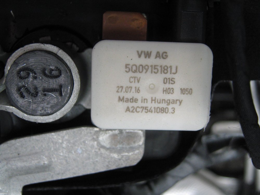

31 minutes ago, gregoir said:
Booked car in again. Apparently a diagnosis and an update of software with the replacement of the component on the + battery terminal was all that was needed. No road test then obviously, as they'd have noticed it was still not working . :sadsmile:
The current senor is on the -ve terminal connector not the +ve end.

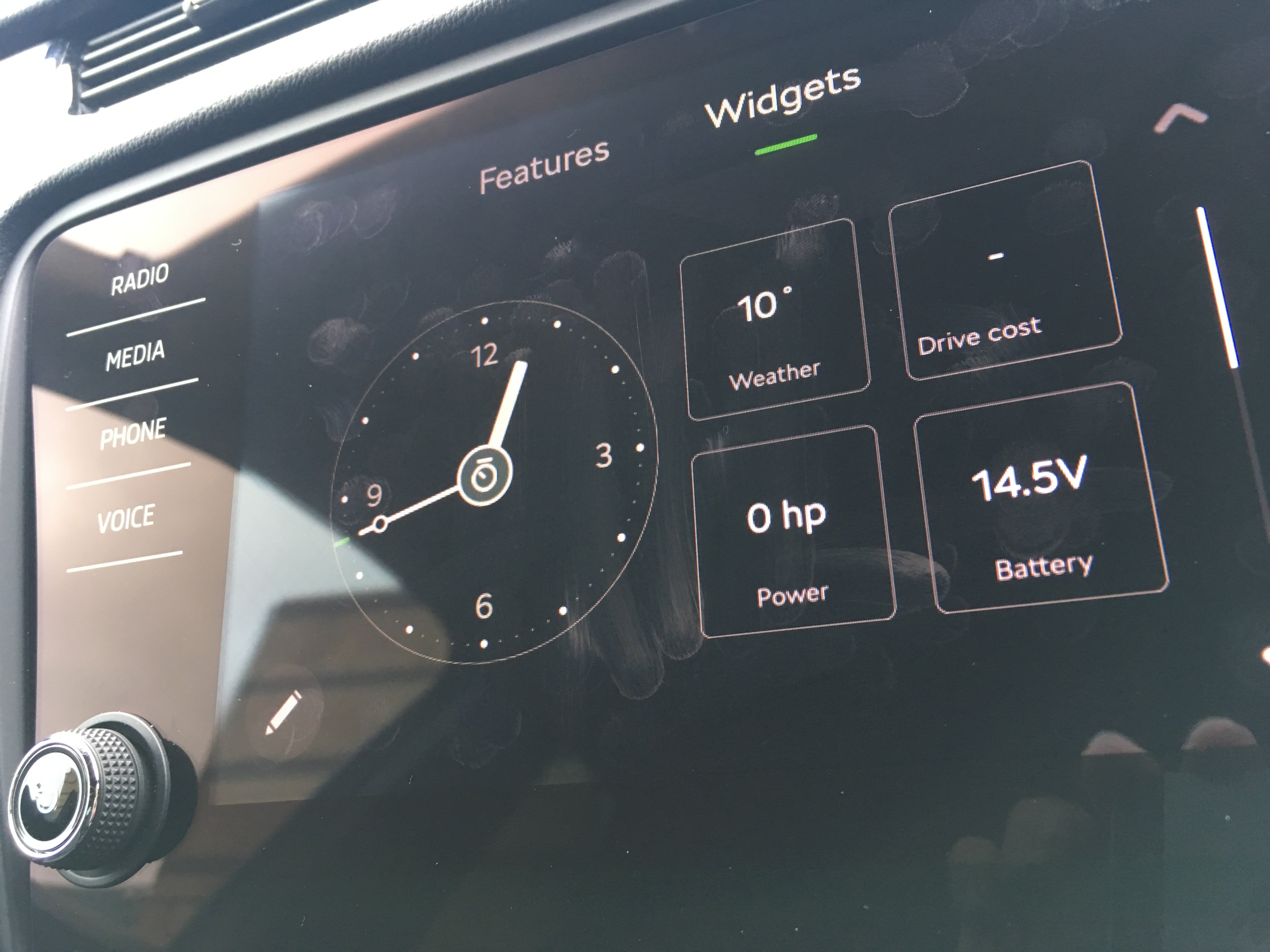

Just came across this video about SOC indicator on maxi dot . Unfortunately my car appears to have been made after this function was deleted. - I guess Skoda got fed up of people questioning and complaining about the numbers.
Looks like you can still get this information from the car if you use the Skoda One App on your smartphone if you have one. When you get the app to stay connected, click on Current Drive Data, then Widgets, click on the Edit button in the bottom left and you can add a battery icon which shows the current  charge level:

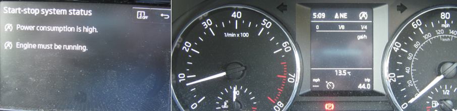

On 21/06/2018 at 18:37, Octy0GG said:
Everything that can be switched off was switched off. Both pictures taken at same time.
Does not seem to add up to me.  Power consumption should not have been high, engine was running. Anyone know what might be going on?  Thanks
Hello! Your problems have been solved? My Superb has the same messages, and it also disables the AC. How was it resolved? What was real reason of the problem? Please write me an email. [email protected]

Sorry, I don't think I can offer much of an explanation.
Stop start is back to it's original over enthusiastic self - far too keen to stop engine.
Car is now 4 years old and still on original battery - as it ought to be of course, but would suggest that it probably wasn't a dud battery.
The only times stop-start does not kick in are now for fairly obvious reasons.
Switching stop-start to off is part of my routine start up procedure these days.
Don't know if your Superb would have a SOC indicator like the Octavia used to but if it does it might be worth checking that.
