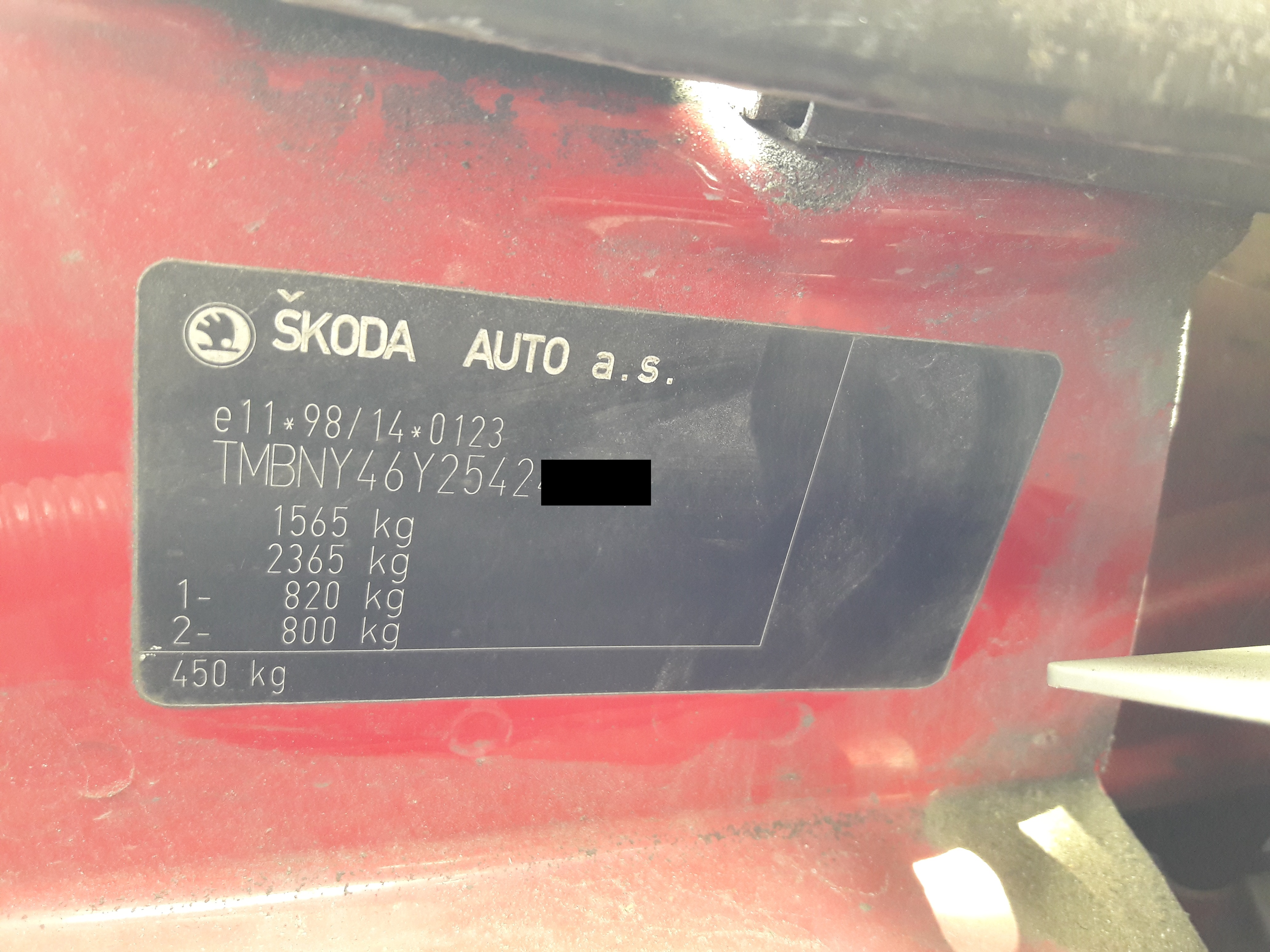

Not sure if this is what you're looking for, but this is on the nearside inner wing, just behind the headlight, probably a battery in the way of seeing it easily on yours:
That looks like it. Doesnt look like there a smoke value on it
  • Sponsor
On yours, or on the one in the pic? (Petrol car)
On the pic. I'll look at her car when I get home from work
