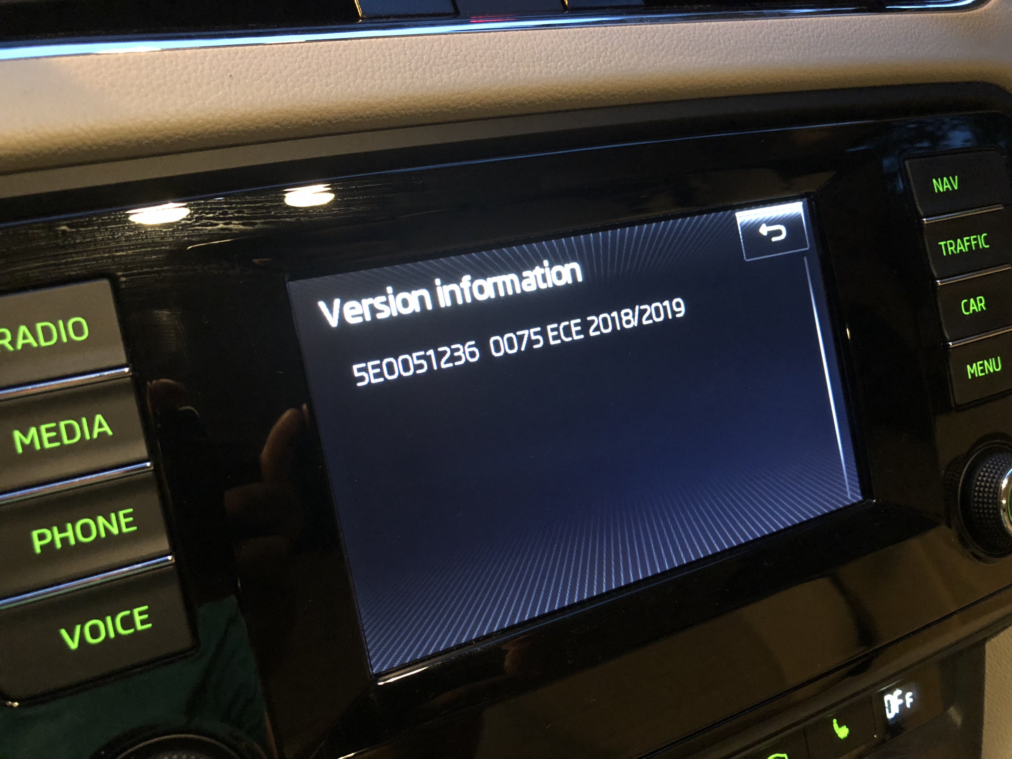

Thanks Aki78.. mib2 Amundsen updated. Good to see they have updated the roads on them this time. New M1 link road now showing.. only been there 2 years..lol

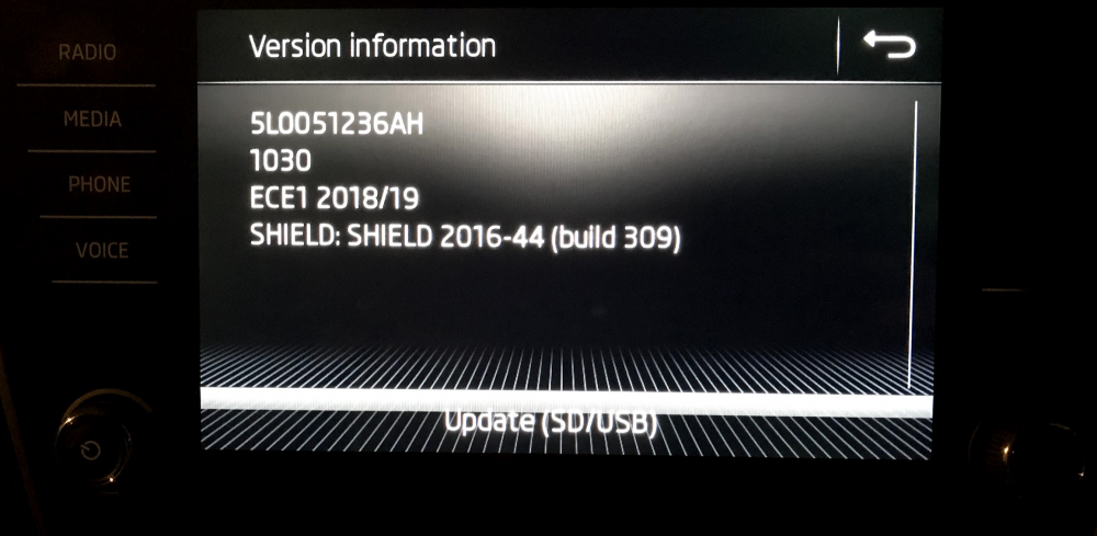

Updated to 5L00 51236AH ECE1 2018/19 and working.

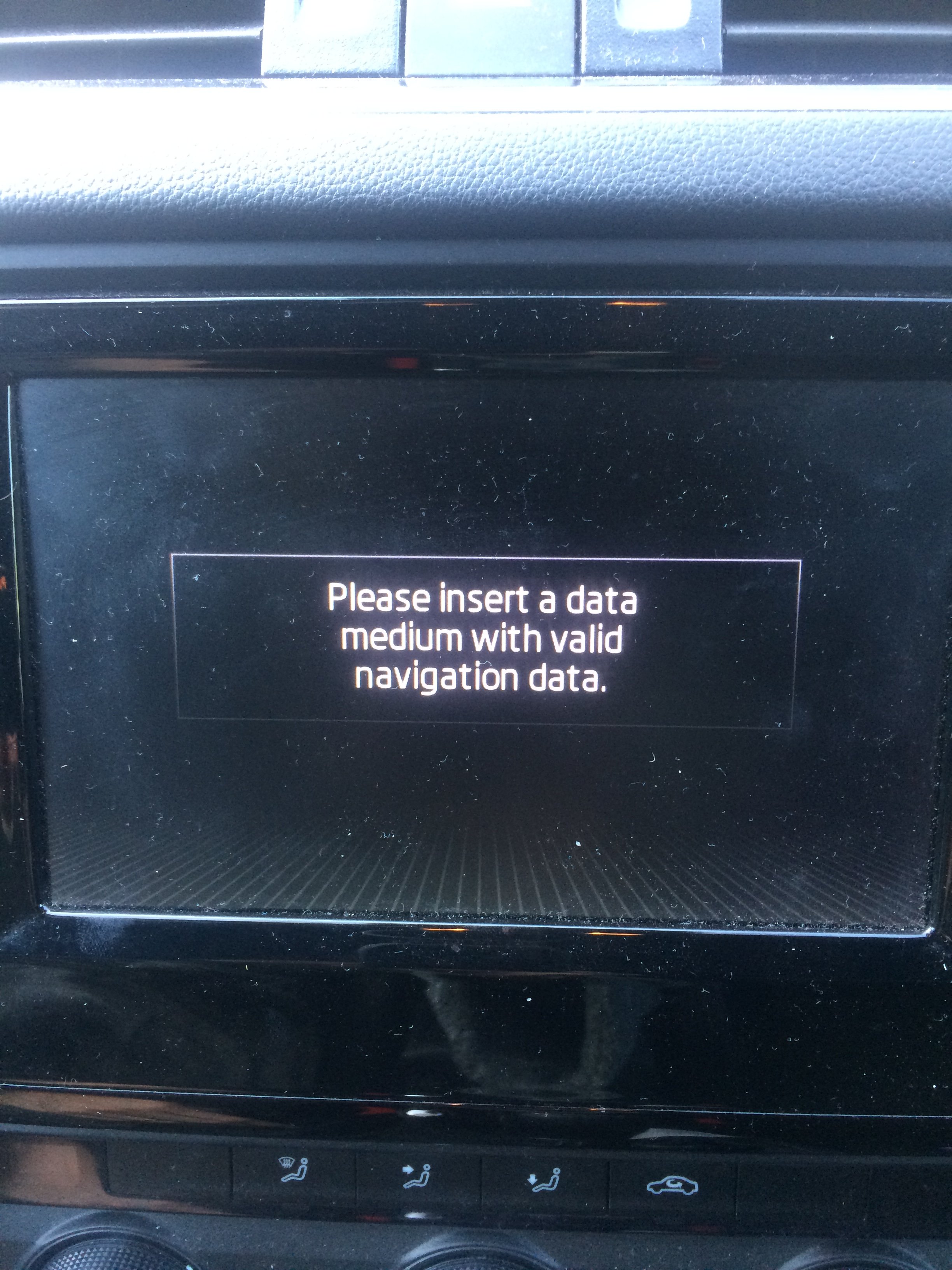

Somethings F-ed up.
Skoda SD card inserted, downloaded the .7z and unpacked it and copied across.
Does it have to stay in the “maps” folder? Adding to the card again within this folder as I think this is where I’ve gone wrong.
Any suggestions? :crying:
Edited by courty
Hi Courty,
Yep.
You open the un-zipped folder and copy the entire contents as-is to the Skoda SD Card.
I'm presuming here that you copied the old data from the Skoda card to your pc first, then quick formatted the card using a 4Kb block size (4096 bytes) first??
If not, you need to do this first before copying the new data to the card.
