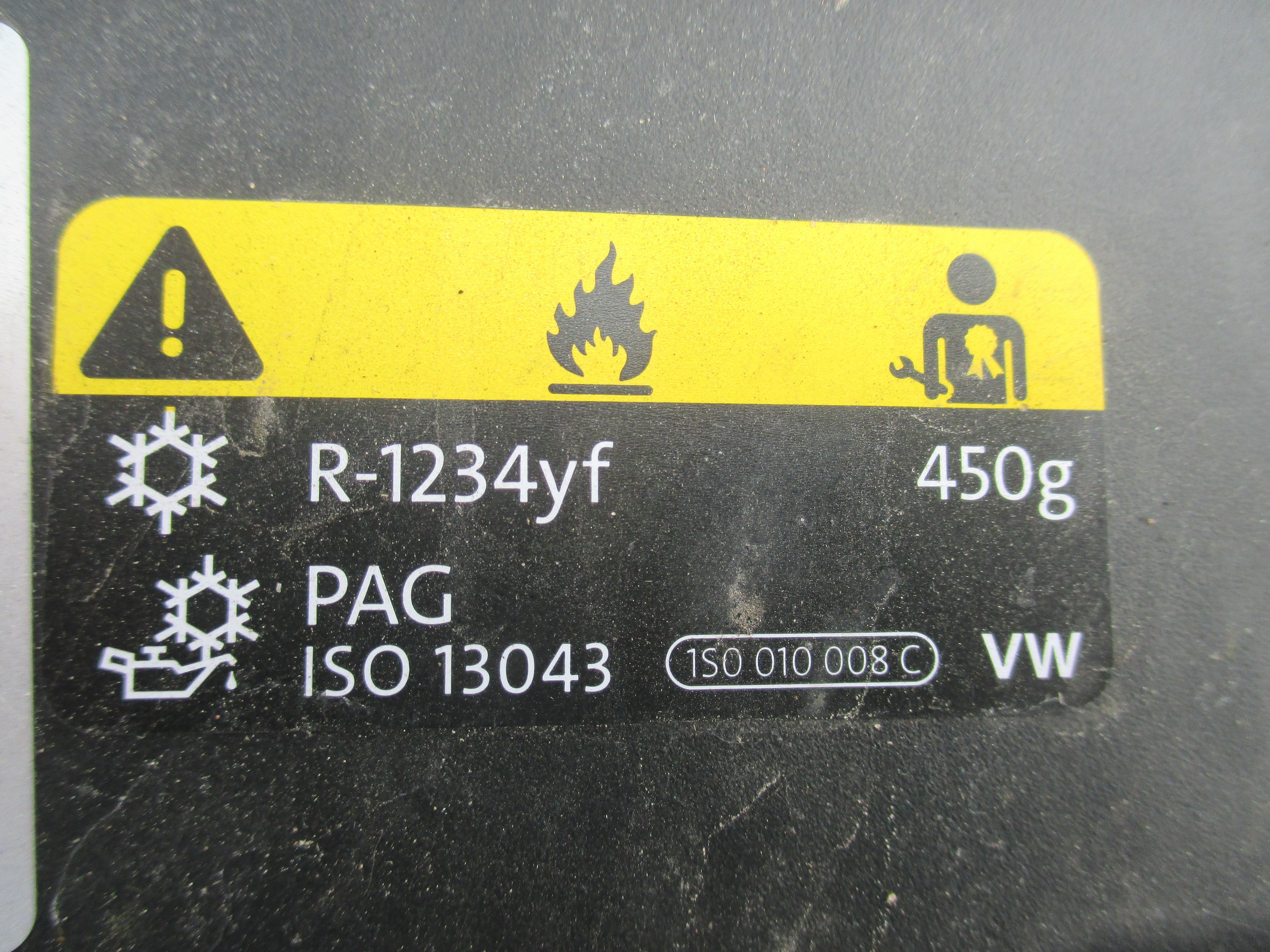

Having checked further I believe that since around 2014 air con systems in cars are filled with a new refrigerant called R1234YF. This is not only flammable but more prone to leaking and costs 4x as much as the old R134A to replace. "Honest John" website reader feedback suggests that 75% of this R1234YF gas leaks out after only 2 years and re-gassing is required before this. As to whether Fabia III compressors are the "variable displacement" type I do not know but even if they are then the practice of keeping the seals from drying out by using the air con regularly is good practice especially as the new R1234YF gas is 4x more expensive and more prone to leakage.
wiganken1, have you checked the refrigerant label under the bonnet of your car?
Edit:- did you not read the bit that I wrote about these systems sending  fridge gas, and so oil mist round the system even when the A/C is "OFF"?
Edited by rum4mo
rum4mo, Yes I did read the "gas circulating when OFF" bit which put my mind at rest somewhat.
Here is a picture of my Fabia air con label: -
That, as you are finding, is not a pretty picture, the future has just hit you!
This is not true, my 16 plate has the old refrigerant, R134A in it, so the changeover date is later than 2014.
