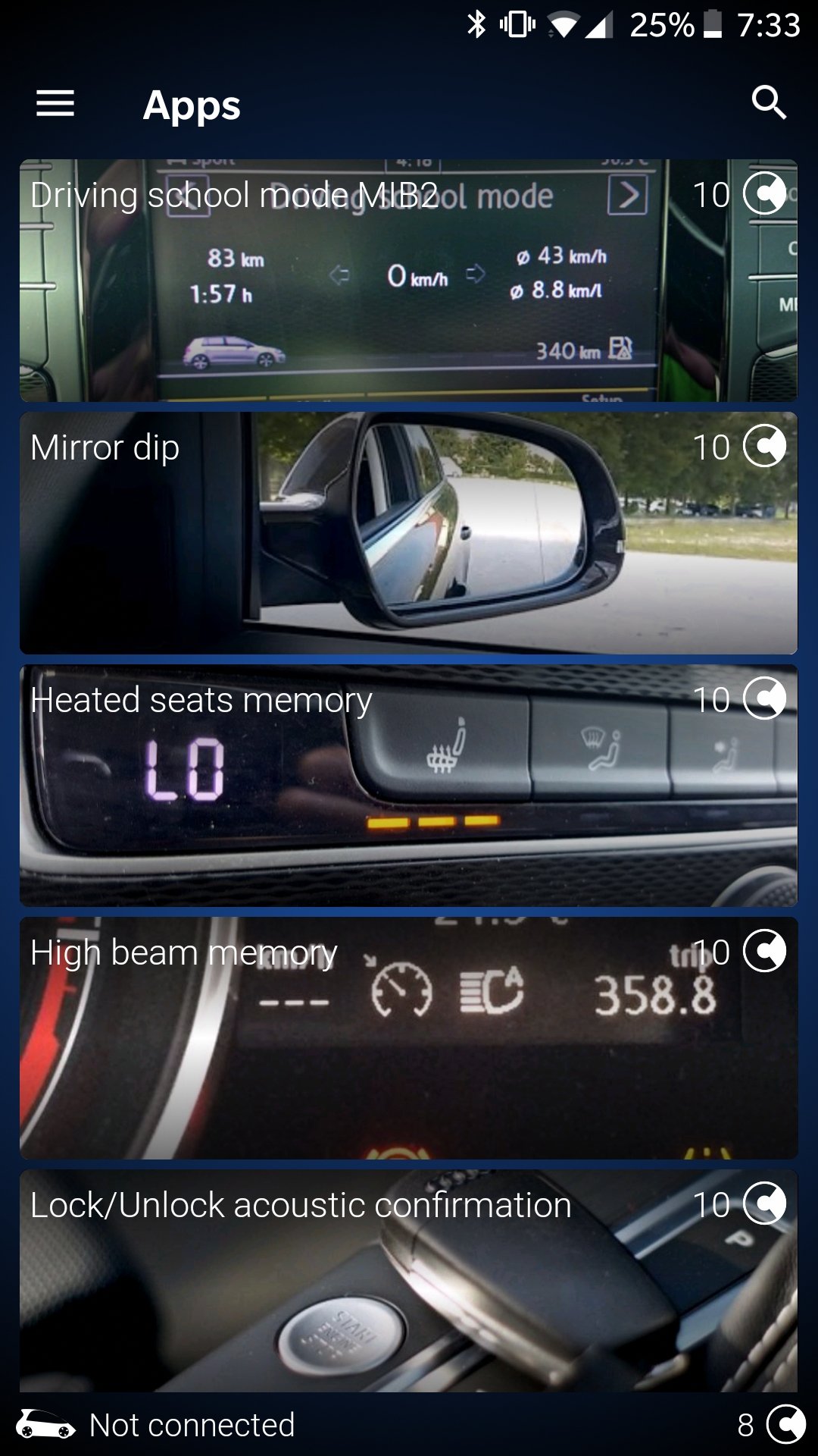

Hi @superskoda2 no its not the pro version but i was tempted to upgrade to it. Was it in the notmal apps section?  If it is ill definately upgrade!
1 hour ago, superskoda2 said:
Do you have the Pro version? If so it is one of the "standard" pre programmed options. Well it is on my obd11!!  If you haven't upgraded to Pro you may find it worthwhile as there are several standard pre programmed options that don't need any coding experience.... that's why I upgraded. HTH.
Do you mean an app? I have the pro version but can't see it listed in the apps. All I have is the one that enables the lights menu. Not sure that will do what the OP is looking for, unless I'm missing something.
Yes that is what i ideally wanted an app like the ones in pic.
Be VERY cautious using the ‘pre programmed options’
Several people have made changes this way and were unable to reverse the changes as other unknown things got changed in the background.
Thanks gizmo. Ill have to look at coding other way maybe.
