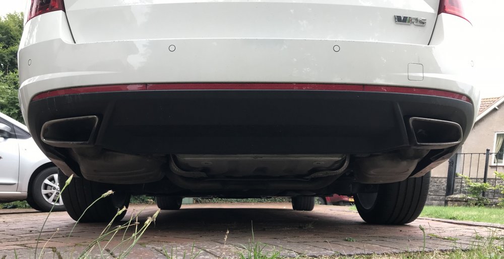

Now the mod is done. Parts needed: two heat shields, one bracket to hold the right side silencer and two exhaust tips from petrol version. From the picture is missing one plastic bit in front of the left rear tyre and it covers up the welding so no one can notice it. You could also use the whole exhaust pipe from petrol version but i did not want to add the middle silencer as it is not needed in the diesel.
