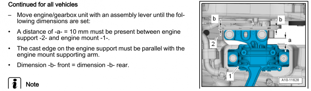

Hello
I own skoda kodiaq 2018 2.0 tdi
And I have noise when turning left.
Today I fix problem by  my self.
Simple engine alignment. Somebody post the picture how should be done correctly .
And also I find on German forum how to do that.
That was not  a road noise or break noise or bearing noise.
Its happen all the time when turning left on gear without gear up hill and down hill.
Was verry enjoying.
Good!

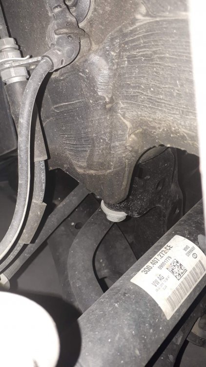

But take care, those bolts must be replaced after dismounting or releasing the tension.
Could you make picture of actual state of the screws-mount?
