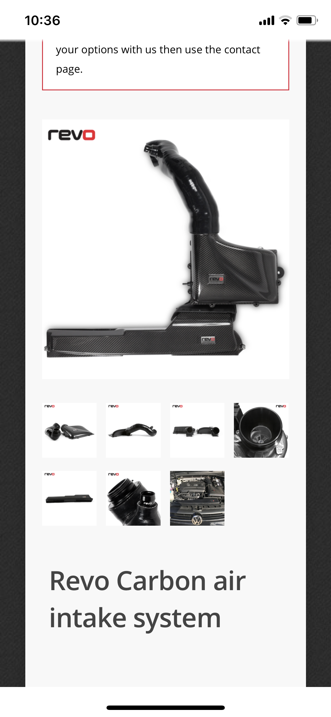

I am trying to find out what stock turbo charger is fitted to my 2016 Octavia vrs 230? It has the 2.0 tsi petrol engine as standard. I am looking at a carbon fibre air intake system from revo however says must have either the IHI IS20 or the IS38 turbo but struggling to find out what I have

You will have the IHI IS20
The IS38 is fitted to the VAG cars that are in the 300BHP region (golf 7R Audi S3 etc)
Everything around the 220 BHP region gets the IS20 (including the VRS, Golf GTi etc)
Both the Revo and APR c/f air intakes are brill :) :thumbup:
thank you all for the help , Ads230 are you running the full carbon intake been looking at this from revo including a stage one map
