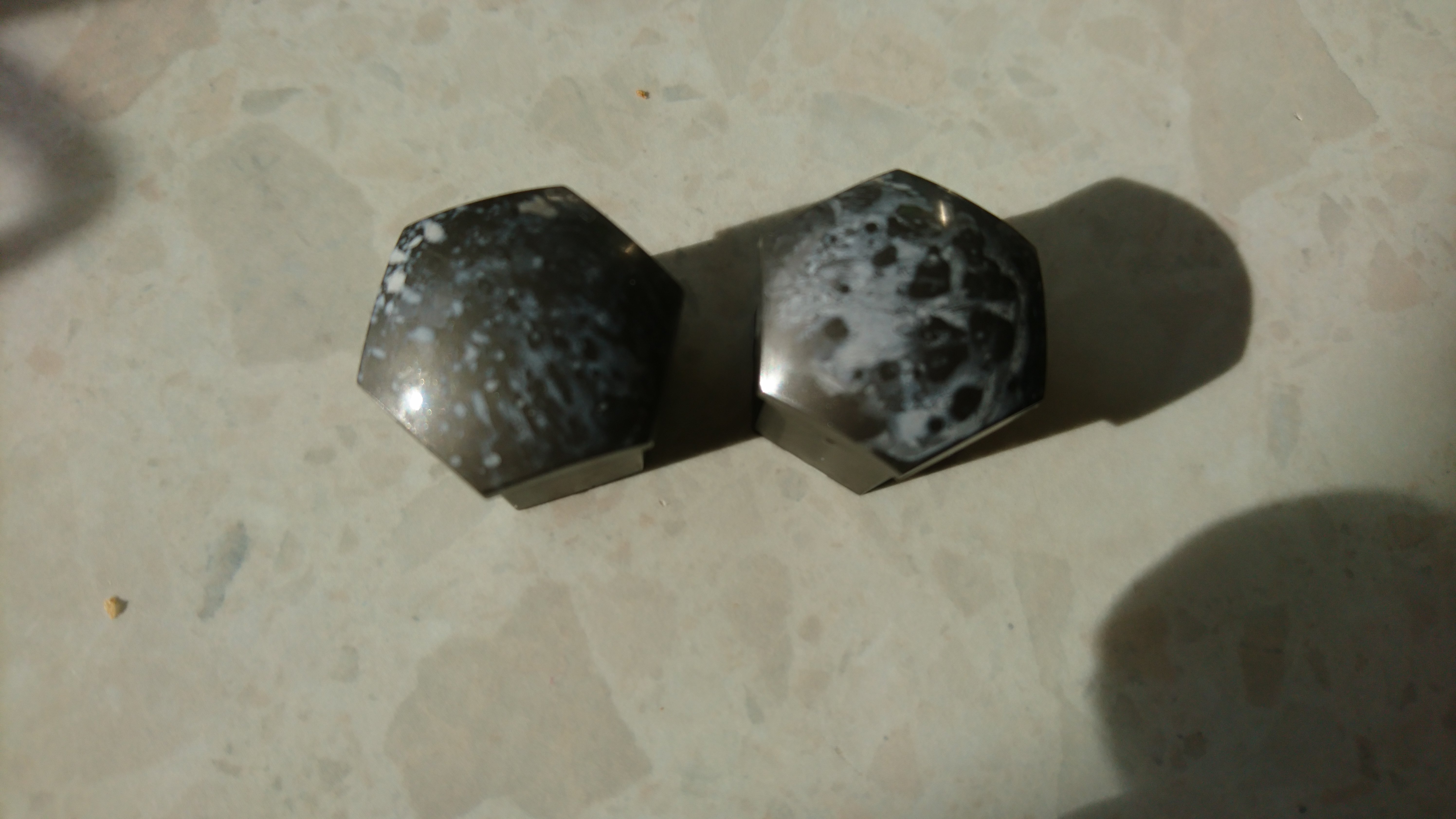

"Treated" myself to having a car wash today but slightly regretting it now. Whatever they used to clean the alloys has left white marks on the plastic wheel nut covers.
Anyone experienced this before or any idea how to clean them up?
If you cant wash or wipe off that white stuff then its a new set probably, I hope you have learnt your lesson now ;)
Yep it’s not coming off so reckon they must have used an acid based alloy cleaner that’s reacted with the plastic.

 I had that once, almost all of the nut covers were covered in the milky hue. Used a hard scouring but plastic thingy from under the sink. Plenty of Jiff, sorry Ciff and it got rid of the marks. That was nearly six years ago. Been no problem since.
