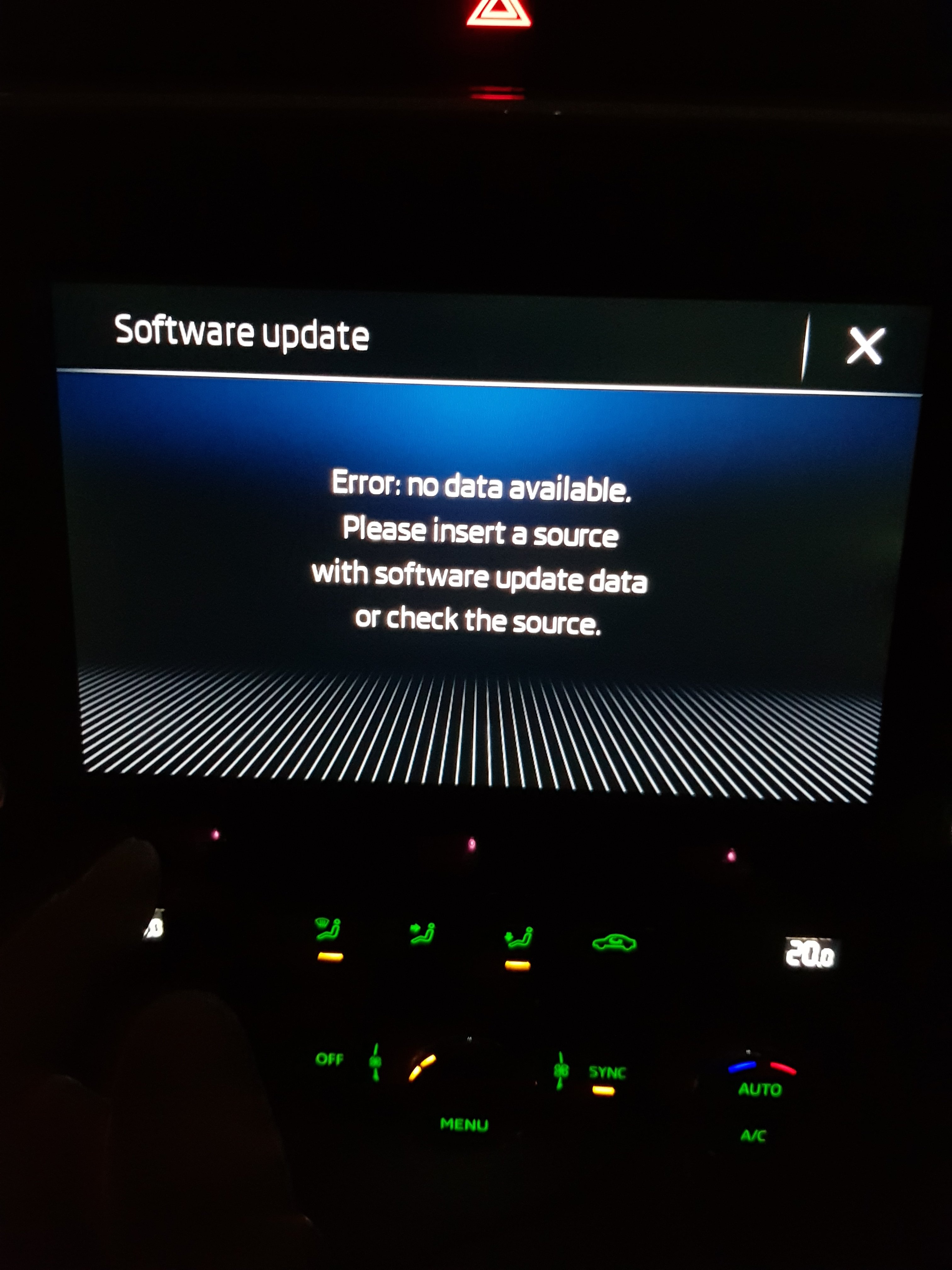

So I've updated maps I've put your latest camera file on a separate ad card and followed the instructions but get this error message?
Thats not the Maps update screen, that’s the Software update screen.
It's actually the poi update screen
Try formating the card (fat32) then copying the files (un-zipped) to it, that worked for me.

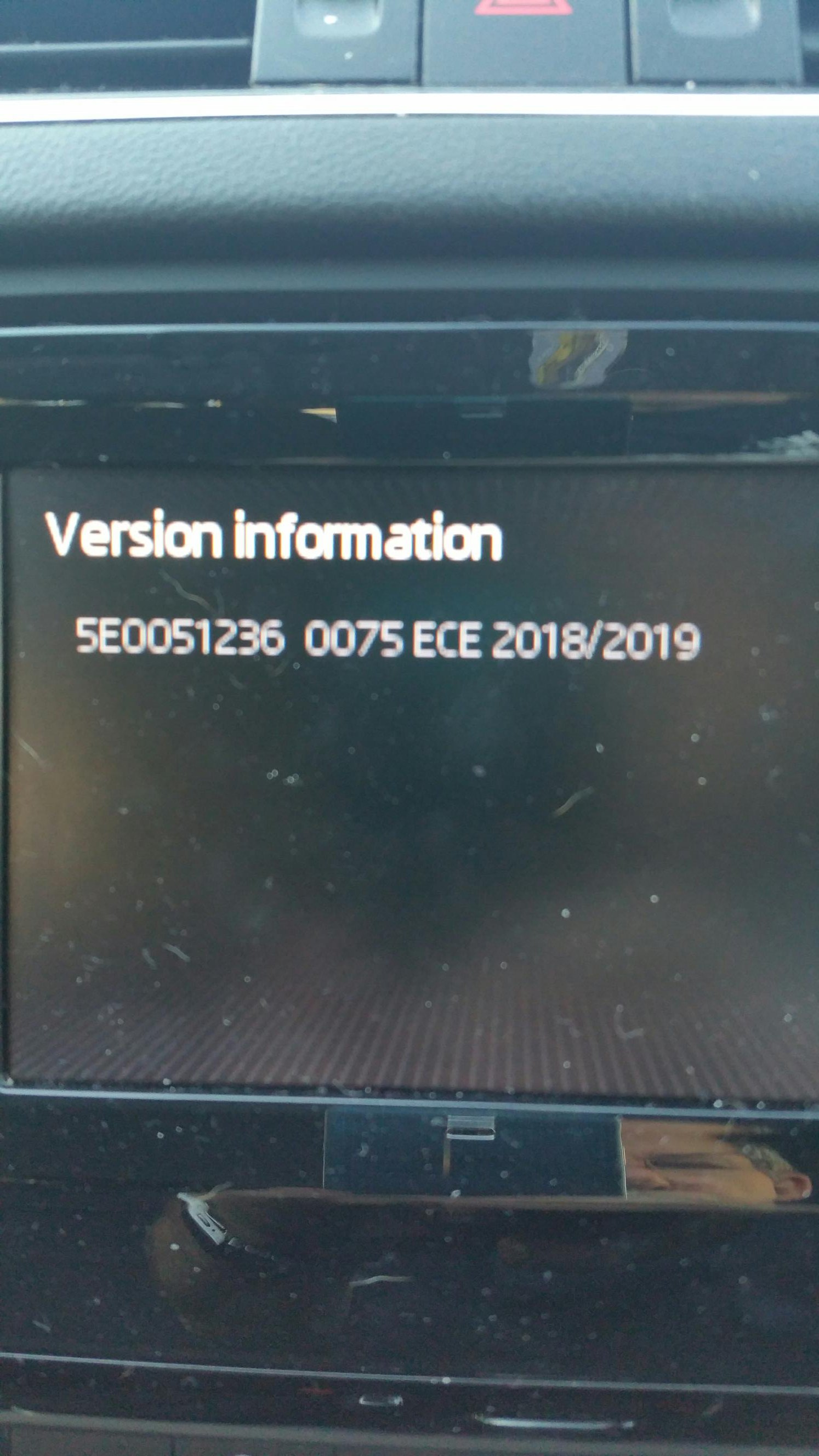

I don't actually know which it is but I think amundsen? It's an 18 plate. I'll check which software version it is but prob won't be until Monday!
17 hours ago, Welsh Boyo said:
Which Modular Entertainment System do you have? The SD files have been complied specifically for the Amundsen MIB2 unit and there have been no other problems reported by downloaders other than in creating the SD card image and executing the download process correctly. If your latest map update file was STD2_915EU_12018 then you should be OK. You could also press and hold the menu button on your unit to show the service mode data (the software version in my case shows as H29.319.51_STD2Nav_EU). I know that the Columbus and MIB1 units need different SD card files and I may be able to help if that is your situation.
Hi this is what my unit says

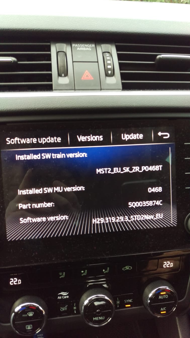

Your unit looks like Amundsen MIB2 so it should work fine. Maybe use the "delete my Poi's option" in the manage memory menu first and ensure that your SD card is formatted as fat32 before unzipping the "PersonalPOI" folder and "metainfo2.txt" file to it. You might also find that there is a system software update for your unit as my software train is P0472T and you are on P0468T. Your dealer should be able to update that for you. Also check that you are registered for Skoda Connect free if you do not already have it (your dealer should have set that up for you - but mine in Cardiff did not so I did it myself). Once online and registered go to the update option there to see if there are any other updates for you. Skoda Connect is free for the first year of a new car and then ridiculously expensive for what you get per year thereafter - something like £60 a year. If your car doesn't have an inbuilt SIM (those that do have a built in emergency call button near the rear view mirror) you will need a WiFi source to get online. I use a mobile WiFi device on the road and pick up my home WiFi at my house. You will get live traffic updates  which are quite useful as well as weather, rainfall radar, news etc. Did you also check that the map version you are on is STD2_915EU_12018? Good luck. I don't think there is much else I can help you with.

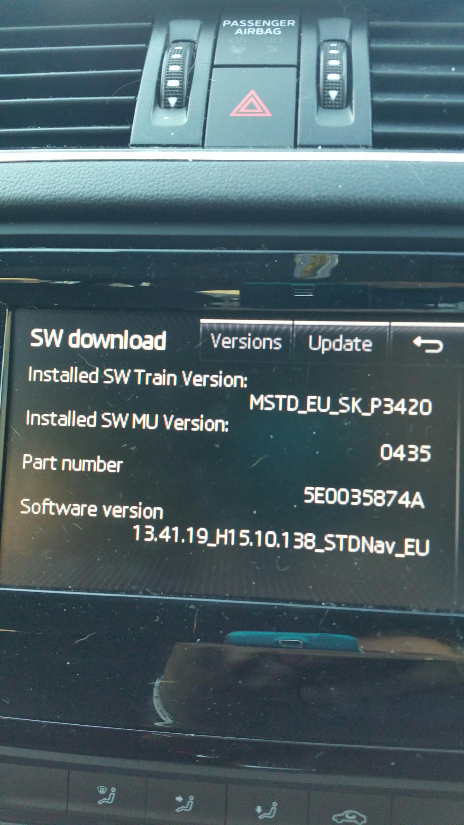

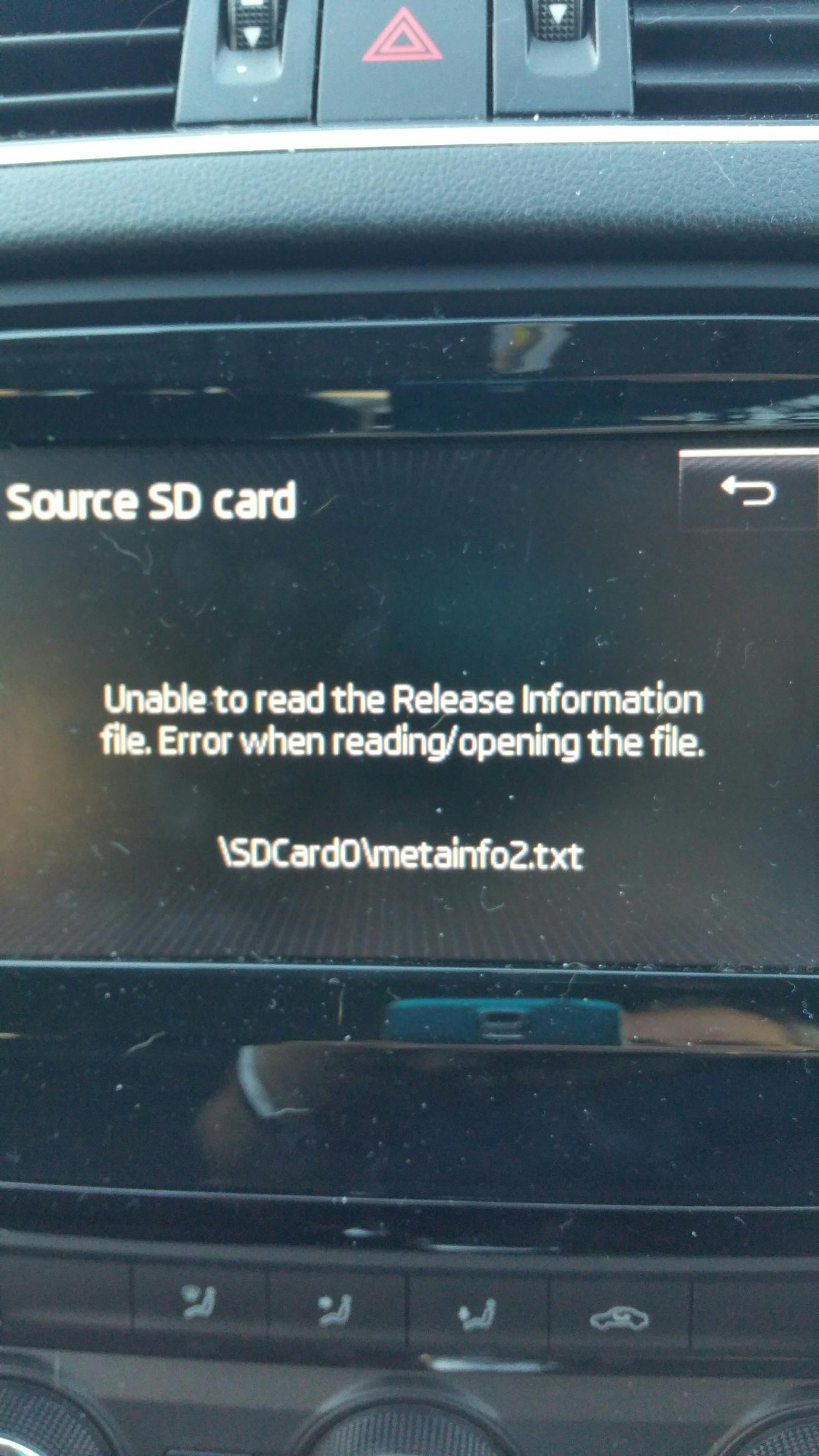

Hi Welsh Boyo … still no joy i'm afraid … formatted a 2gb sd card, unzipped cameras oct 18 (1.01mb in size)  and copied 2 unzipped files/dir to sd card ( metainfo2.txt and {dir} PersonalPOI both in root) … popped in sd card slot 1 and attempted to update … getting error message stating could not read metainfo2.txt … have attached all relevant screenshots etc … any other ideas ?
regards
RayStan
Try putting the files in the folder from the zip file into the root folder of the SD card.  The text file doesn't matter IIRC.
just tried that … still no joy …. have noticed tho that when I attempt to manage memory in nav setup, I do not get the option to update poi's … only 2 options available - define home address and delete user data … am I missing something ?
Checked that in my MIB1 Amundsen this morning - there is no option to add POIs.
All you can add is destinations by putting vCard format files onto an SD card and putting it into SD Card slot 1.
To confirm - there is no way to add POIs on a MIB1 Amundsen :sadsmile:
