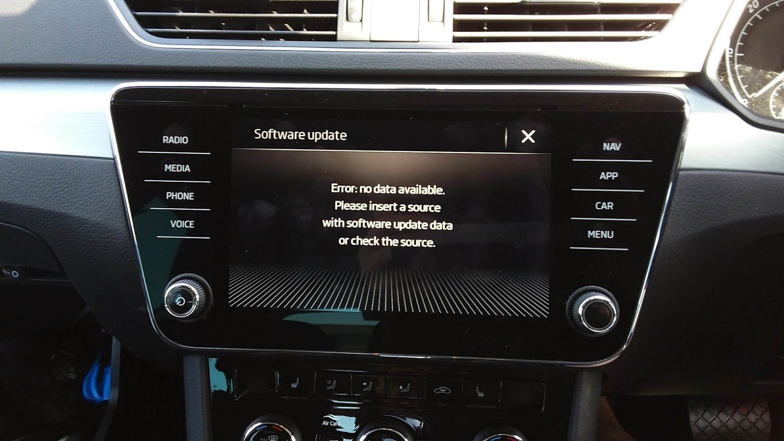

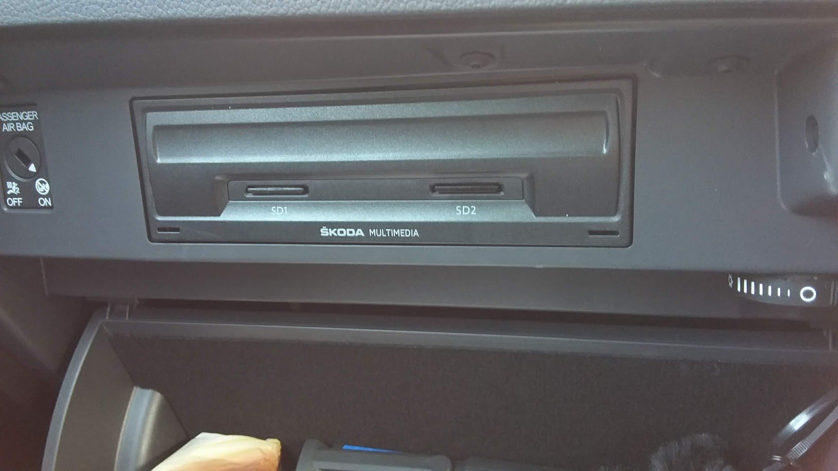

Hi, I was so very much hoping that this would all go according to plan, but alas, it hasn't.
If anybody would take a couple of minutes to consider this I would be very grateful. Please see pics of what's in the glovebox and the headunit I have.
Firstly, are they compatible with these files? Secondly, and I'm thinking this is the issue, I appear to have been able to unpack the zip files without putting in the password - has it all gone wrong here?
What it does unpack, I've put on an sd card and when I put the card in sd2 slot, it sees it but doesn't find any files, as the pic shows.
Any suggestions please?
Thanks.
Your system looks fine (looks the same as mine). The latest files were uploaded by me on 20th March this year and I have a feeling I did not password protect that zip file. Importantly, you need to work carefully through the steps I outlined in the very first post in this topic. Occassionally it is necessary, for some unknown reason, to eject and replace the SD card at some point in the update process. Good luck. Let me know when it works for you :)
Thanks Welsh boyo, I'm fairly sure i followed your instructions to the letter, quite a few times! I will try again and report back. Just to give me a bit of clarity, am i just unpacking the main folder, or do i have to go into all of them individualy, and how big is the unpacked data please, I'm  getting around 3Mb.
Thank you.
You keep the original Skoda map SD card in the left slot. Put a normally formatted SD in the right one with the extracted files from the zip on it. Once the POI's are loaded you can go back to using the right slot for music etc.

I'm up and running! Thank you very much.
I'd obviously had a problem at the unpacking stage, I did it again on a different computer using different zip software and it worked first time.
