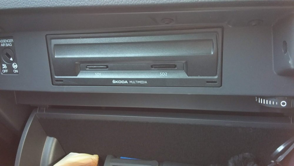

Firstly I'd like to thank WelshBoyo for going to the trouble of producing this database - Its very much appreciated.
Secondly I'd like to share my updating experience as it hasn't been straightforward and has taken a lot of perseverance on my behalf, which hopefully will help some others out there who may be struggling.
My car is a 2019 Skoda Octavia.
I won't give the whole trial and error process I've gone through but here are the steps that have worked for me;
1. Extract the zip onto a suitably sized SD card, check the unzipped files consist of just the "metainfo2.txt" file and a folder entitled "PersonalPOI".
2. Follow Welshboyos update procedure down as far as "Update my POI's" step.
3. At that point insert the SD card into (in my case with an MIB2 style unit) into SD slot 2 (the first slot contains the Skoda Nav SD card).
4. Now select the "Update POI's", at this point the card will be read and should go through the update process.
5. Carry on following Welshboyos guide in order to show the POI's etc...
One further addendum to the process - I've just remembered the first attempt of doing this resulted in the splash screen showing "searching for updates" and a spinning circle which went on forever. At this point I selected the "cancel" option and re-selected the Update my POIs step, and this time it worked. What I guess I'm saying is persevere as I did and you will get there.
