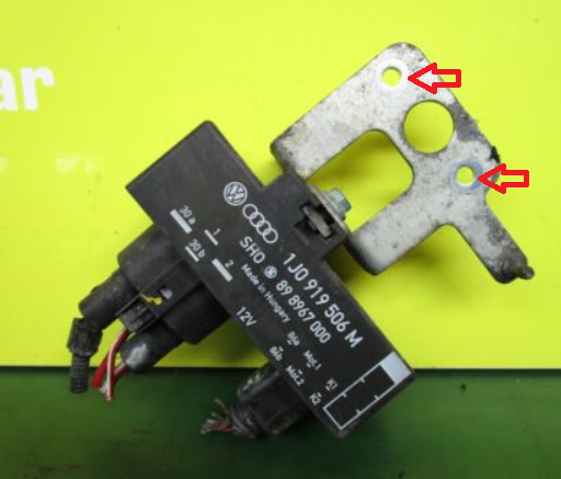

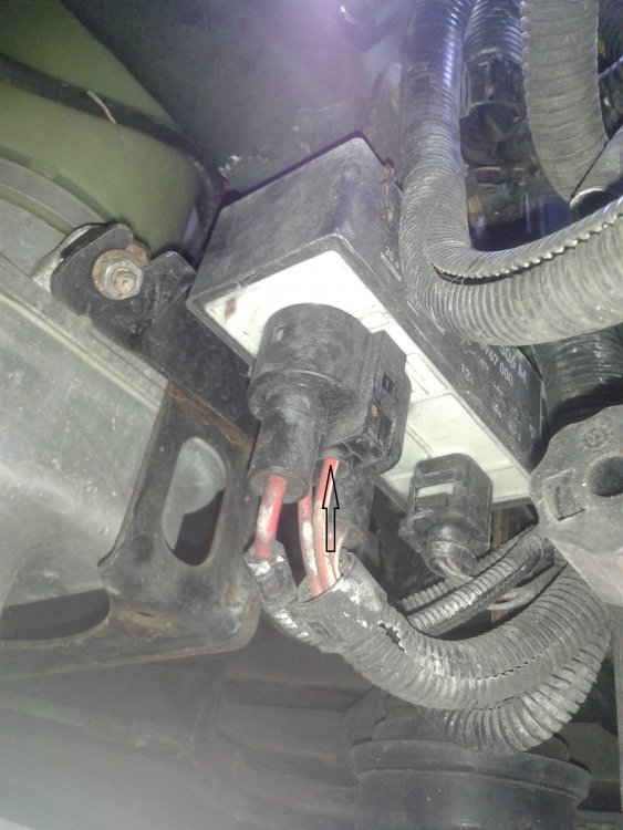

If the car has air conditioning, there are two relays (one for low speed fan operation, the other for full speed) inside a control module under the left chassis leg, just next to the power steering pump.

If you disconnect the small 6-way connector from the fan control module pictured above, and the fan keeps running even then, the fault must be within the module (a relay with its contacts self-welded).
The module is not easily repaired, so I would replace it.
If the fan stops when you disconnect the small connector, the problem may be a wiring fault/short which is making the module incorrectly 'believe' it needs to run the fan, or the radiator thermoswitch.

Hi Wino, how do one remove this radiator control module for replacement?
Undo the two bolts which hold the fixing bracket to the chassis leg. Unplug the two electrical connectors first.
