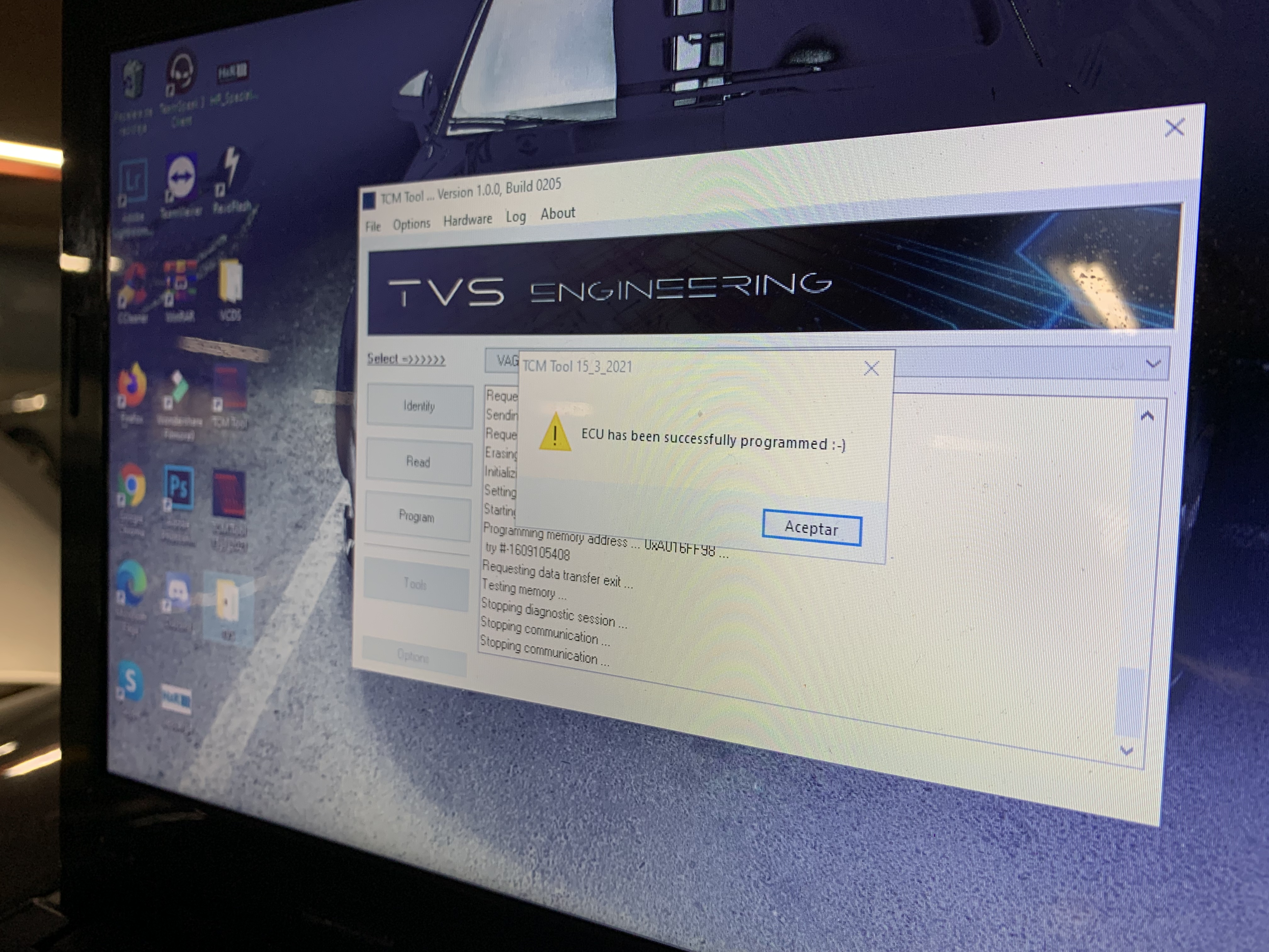

Time for the dsg map.
Went for the TVS stage 2+ dsg map.
Really good improvement over stock. Fast and smoother shifts and can maintain the selected gear in track and no more upshift whenever the heck the gearbox wants.

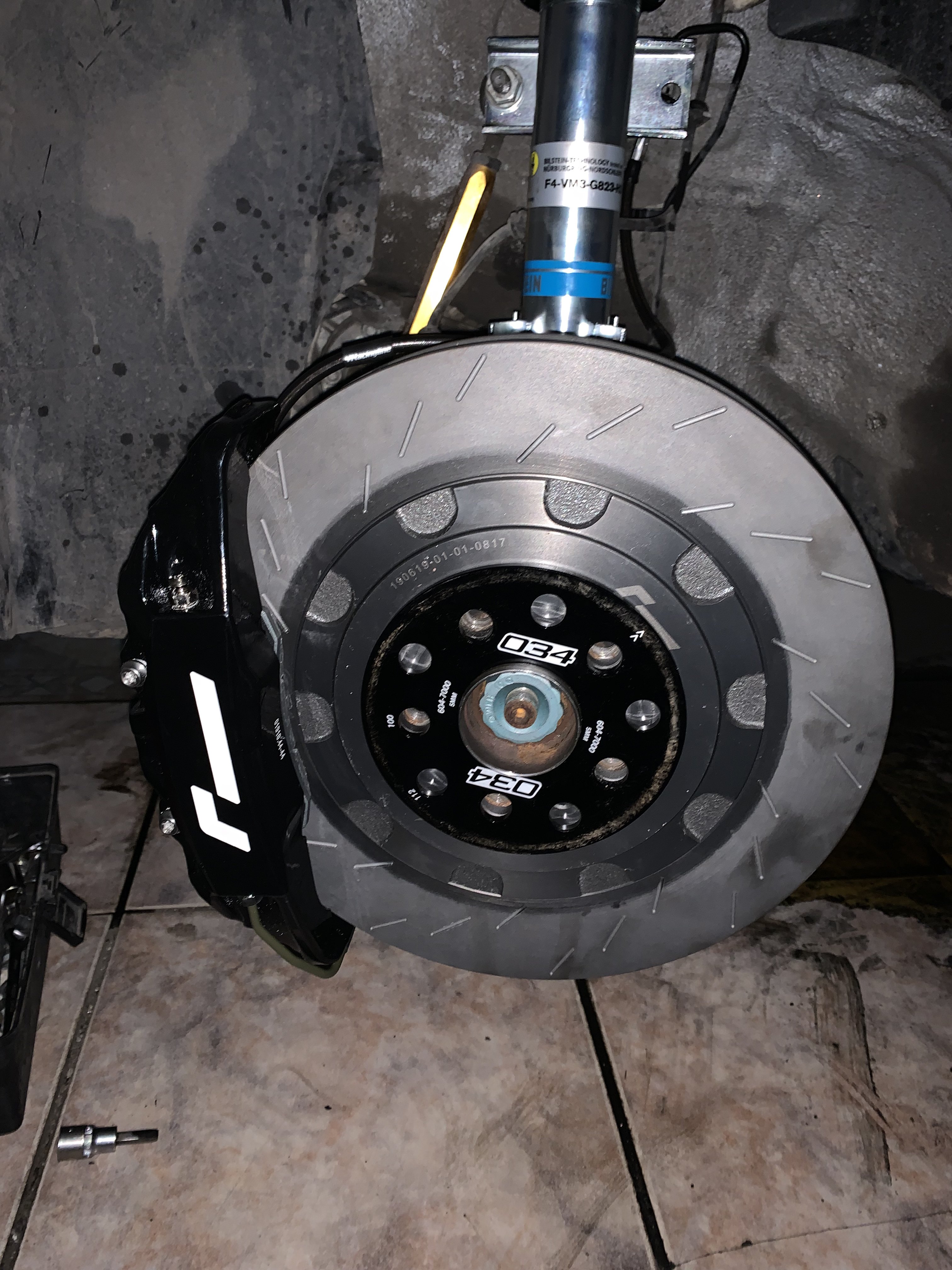

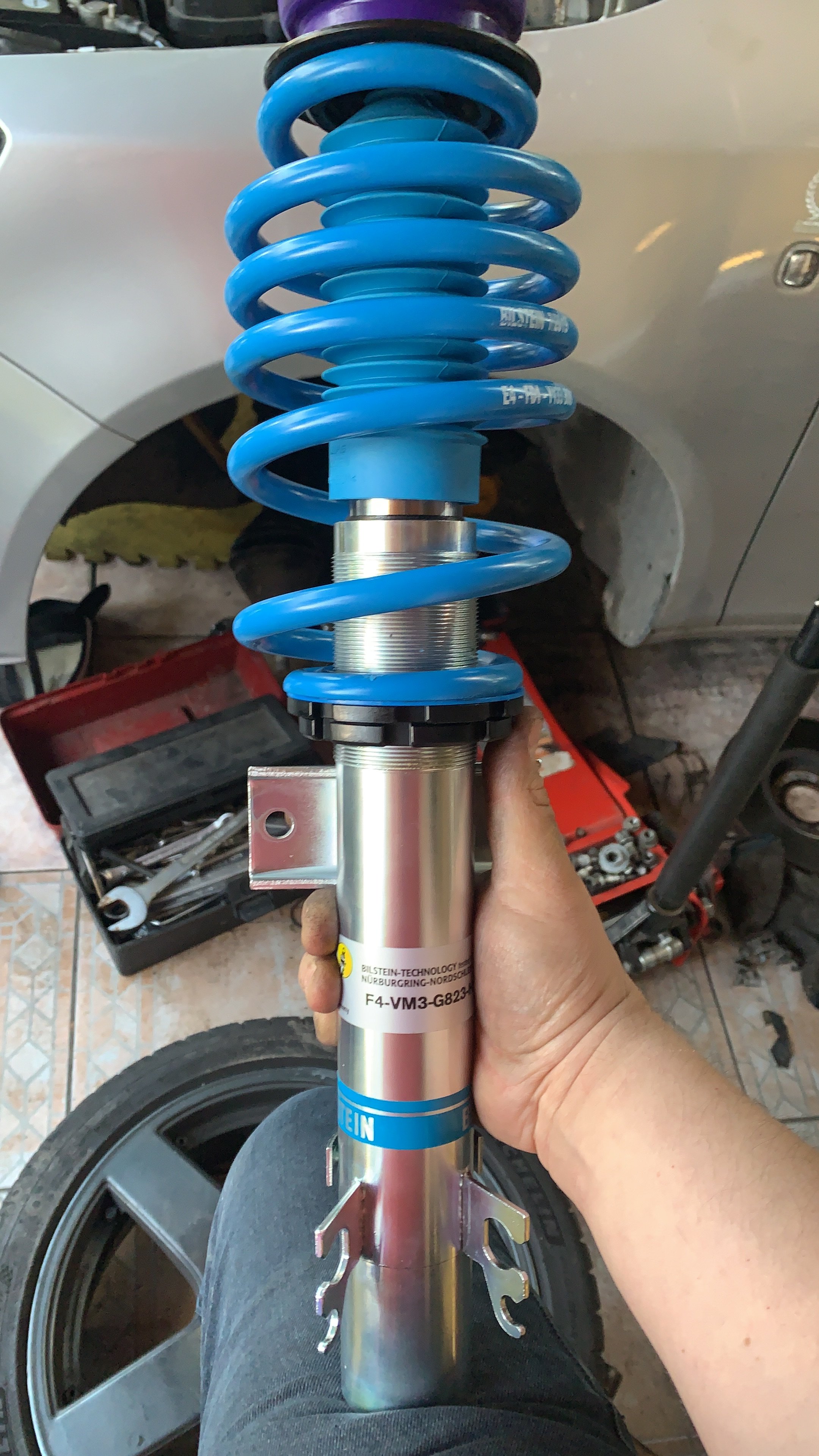

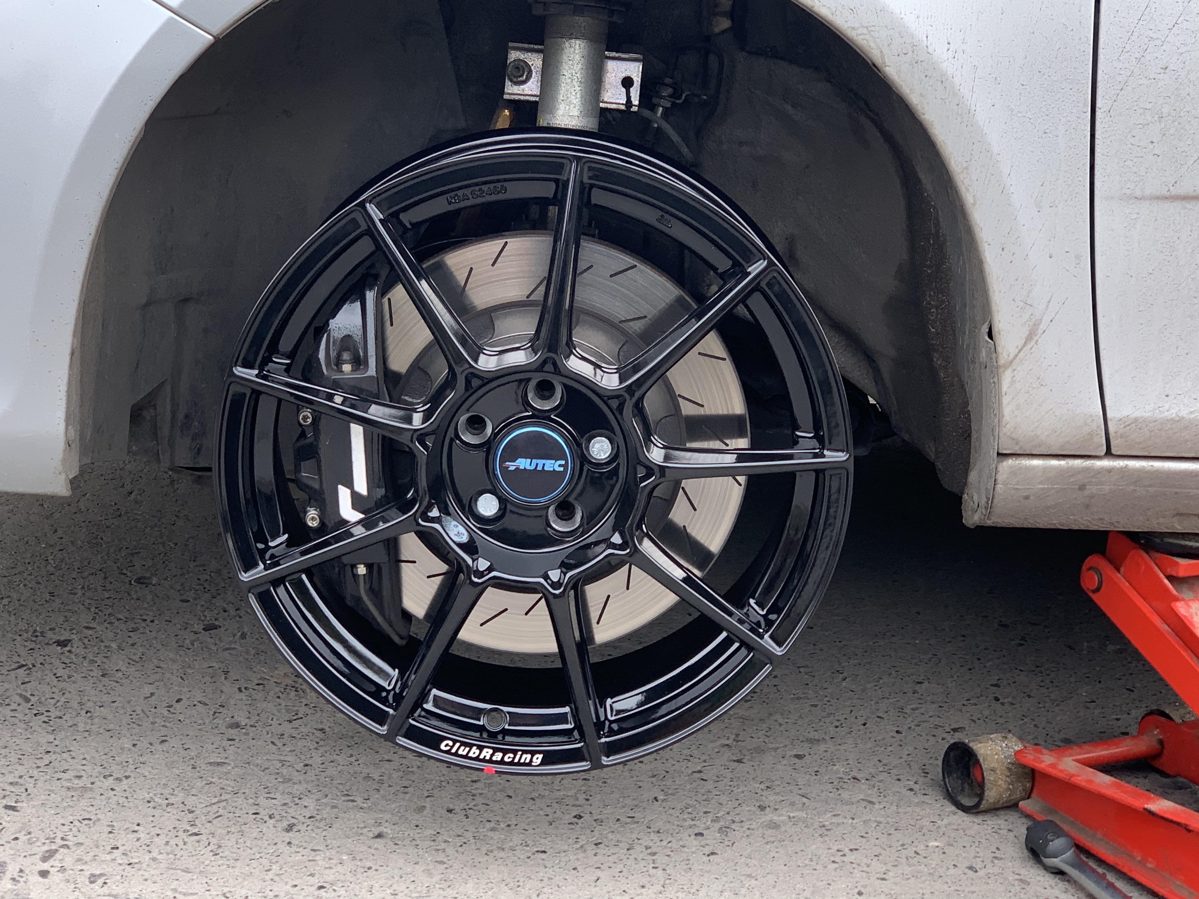

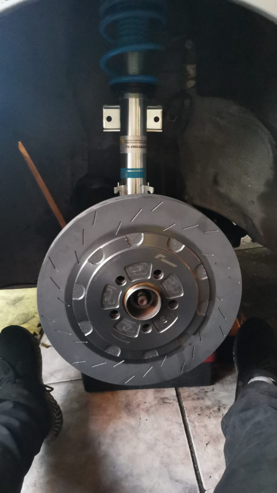

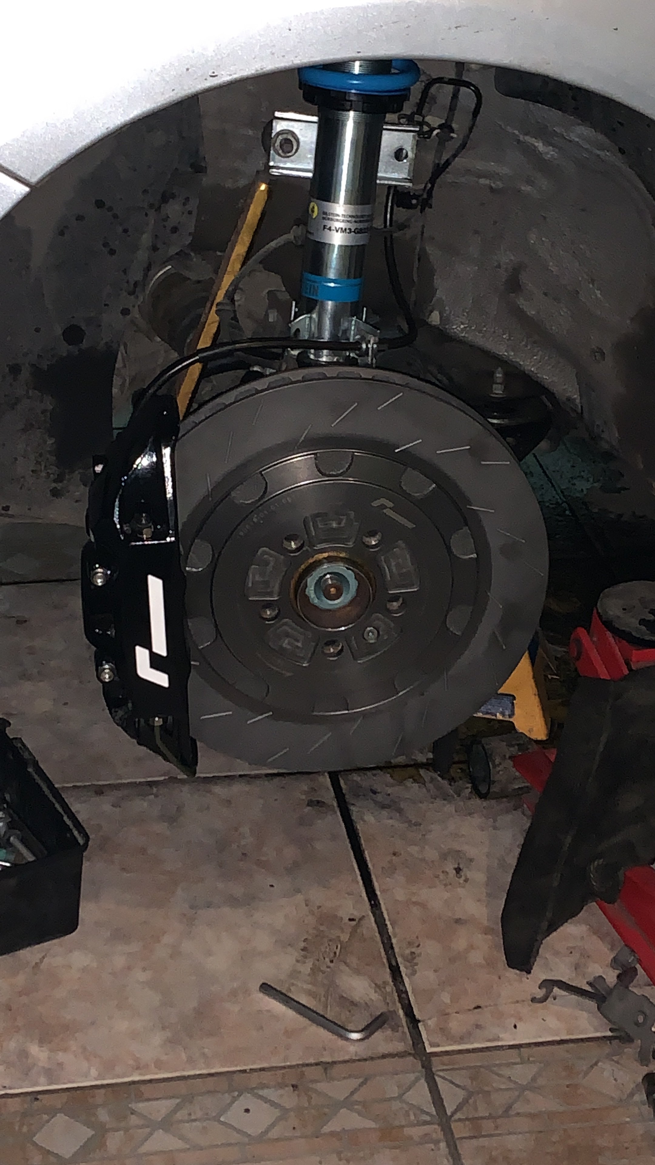

And…. Finally. Coilovers and brake kit install.
Needs to set up properly but this is kinda off a endless project so…

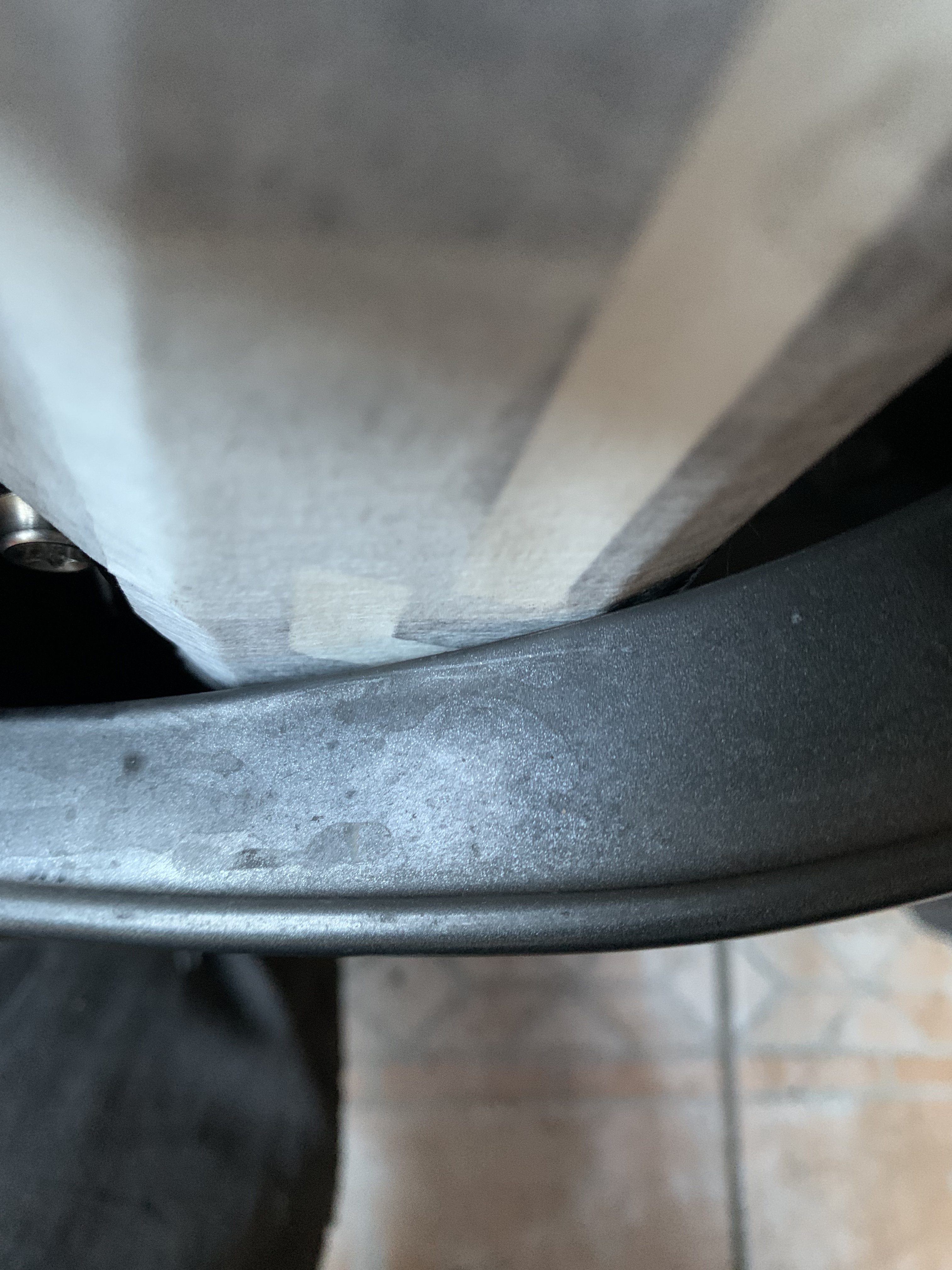

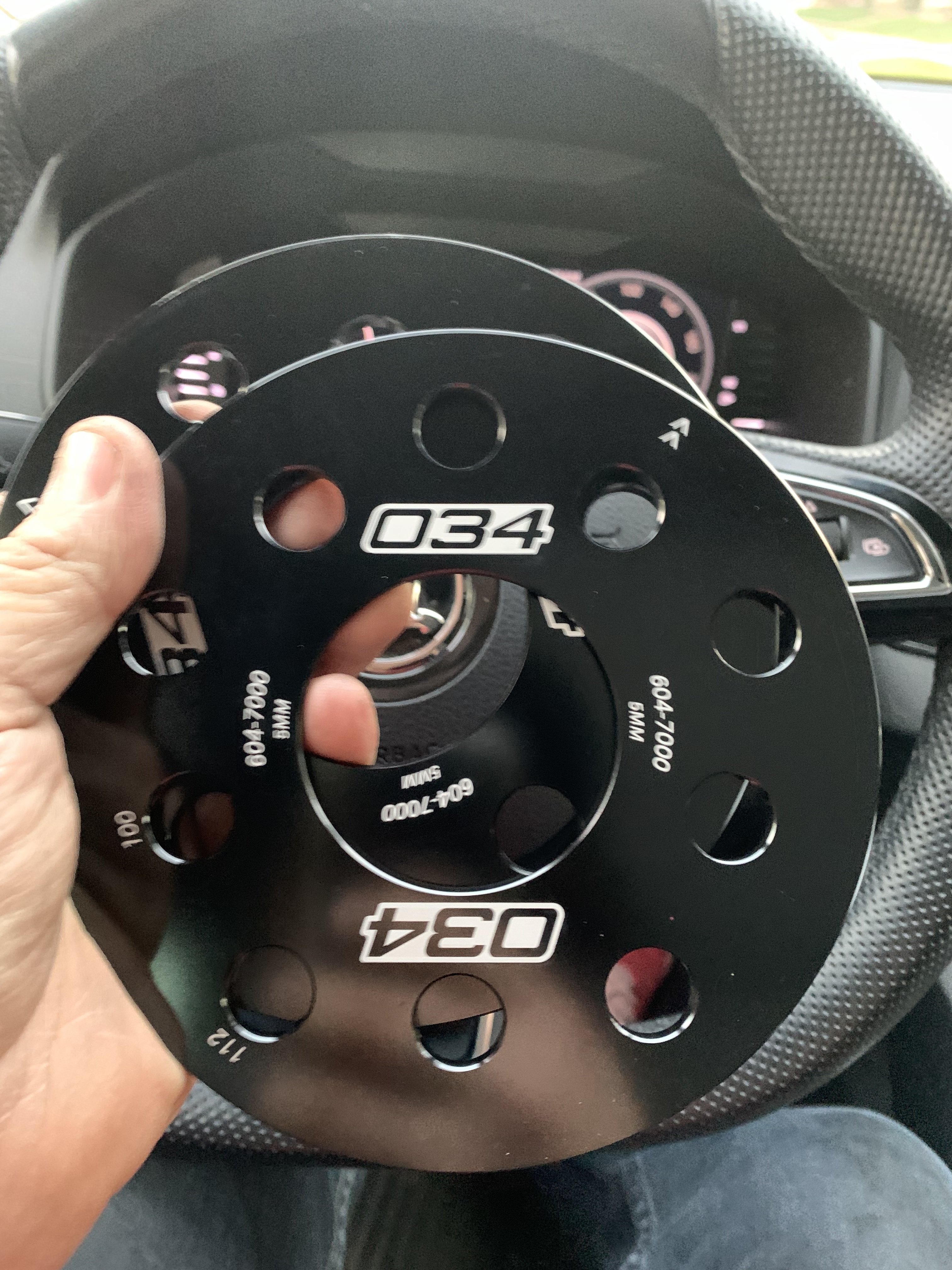

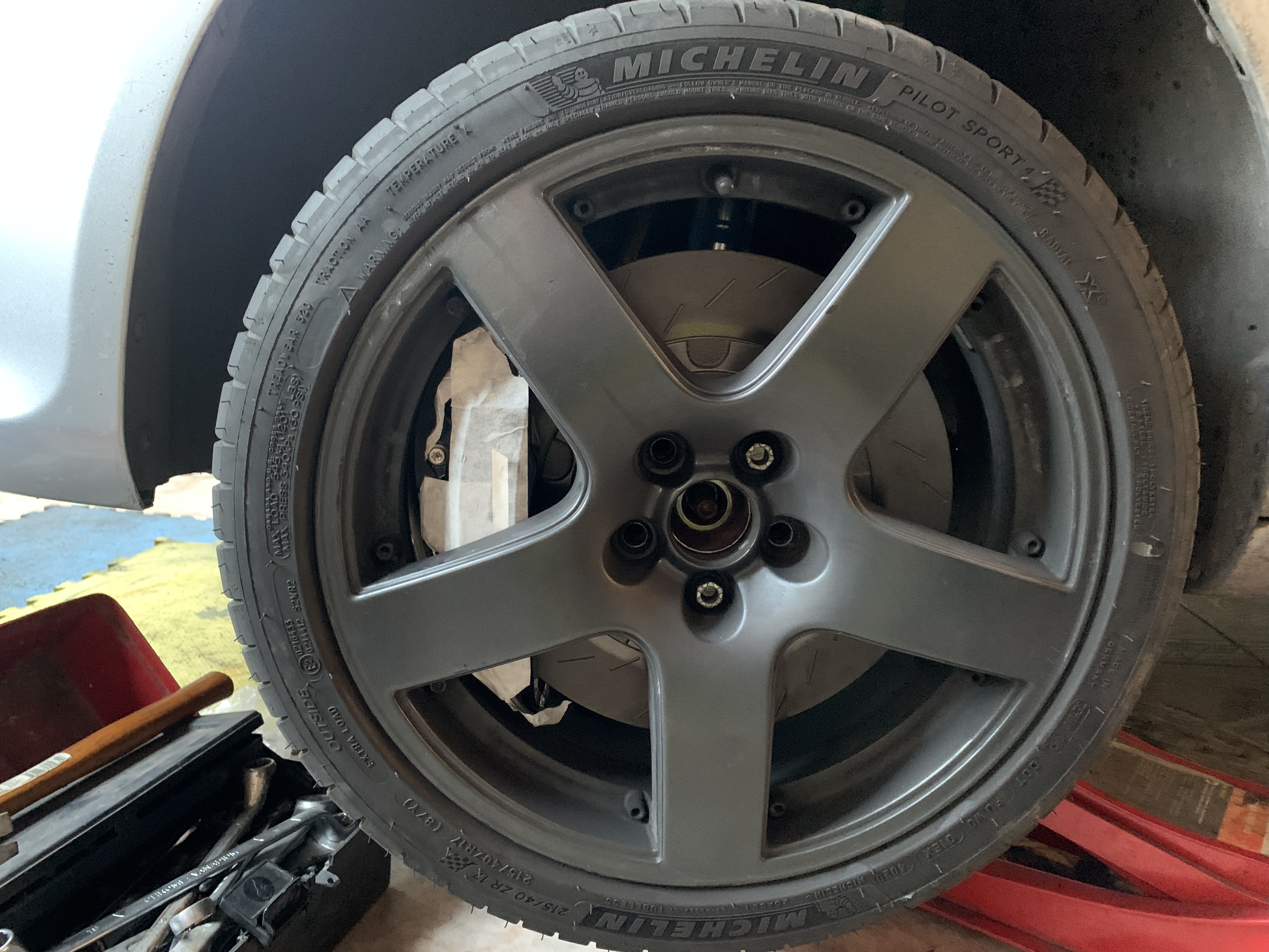

oem wheels? Forget it. Must use some 5mm spacers to clear this right.
Overall pretty satisfied with the brakes.  Less unsprung weight, feels “playful”
Rubs a little on certain situations but as I said. Still needs to weight/corner balance the car.
parts
bilstein B16 coil kit. (A1 8x / polo Gti 6R)
powerflex upper strut mounts
vw shock bearing
034 motorsport spacer 5mm
racingline VWR65P1GT brake kit
Goodridge rear brake line

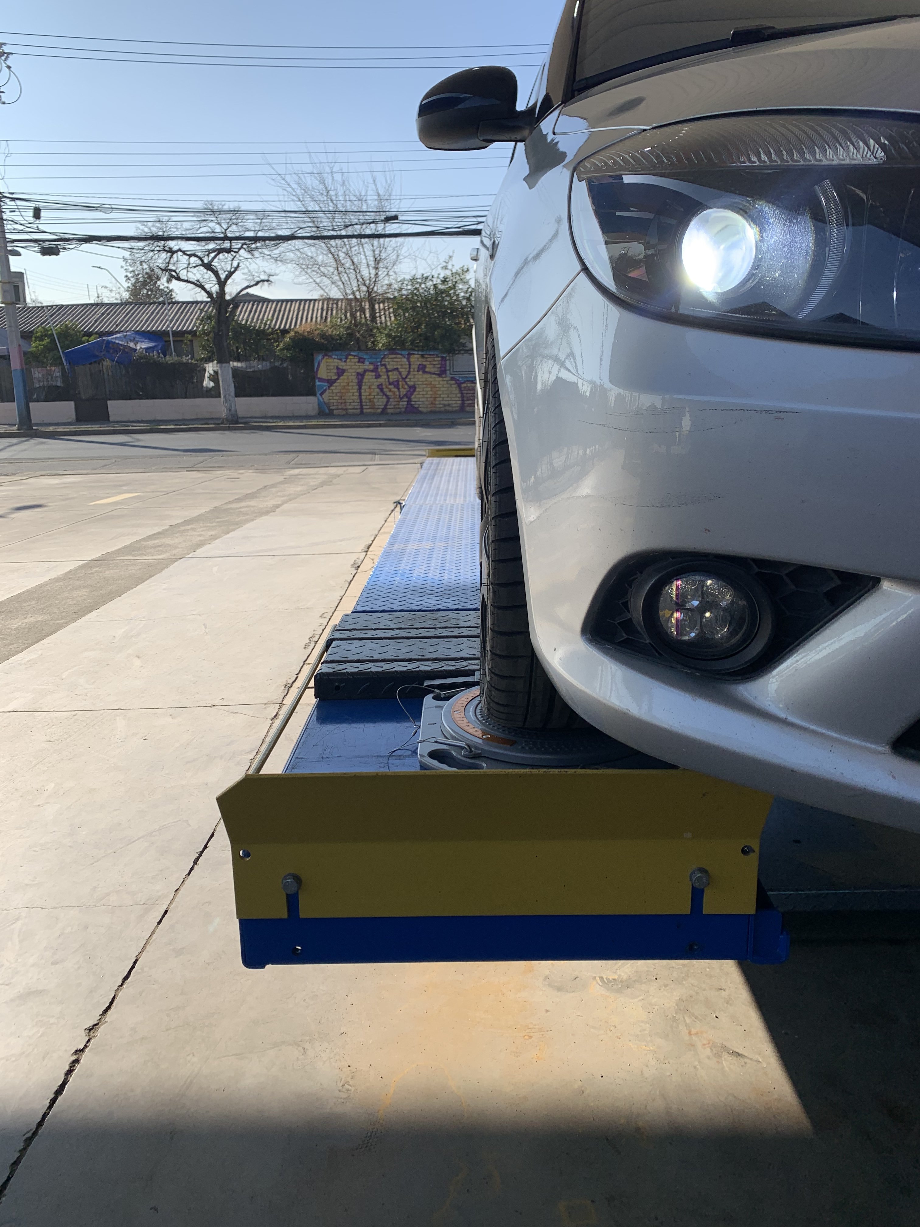

-1.54 degrees of camber
Hello Cris, great project. Are the spacers to save the caliper? The bilstein spring is above the wheel?
Thanks a lot.
Thanks a lot.
Yes, without them, you can't clear the caliper with oem wheels. This are 1C0601025K.
The spring is above? are you reffering to wheel gap in the arch???? if so, yes... but it can go as low as no gap at all and some wheel tuck under the arch.... not in my plans for the car.

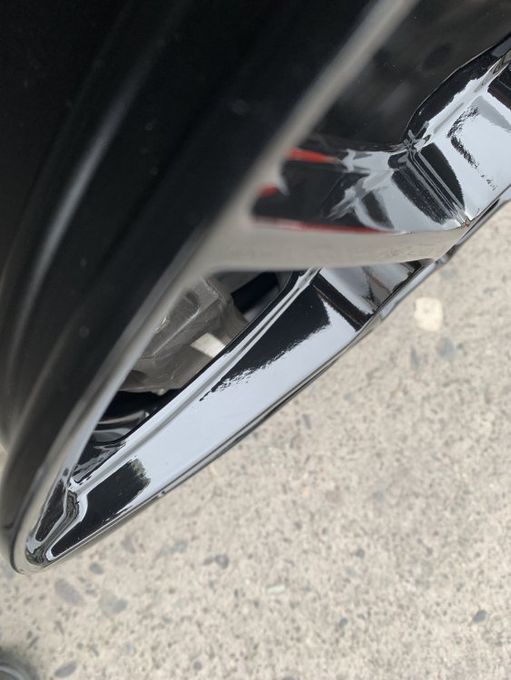

No, i talk about the distance between the inner top of the tire and the spring, because i've 17x8" rims and sits really near to the shock.
In other words, if like oem bottom spring seat of the shock, it's above of the inner part of the tire.
Thanks a lot.
Couldnt use some OZ crono 17x8 because they rubbed the shock... if thats what you're suffering, might be worthy to try some 7.5 et 35 wheels instead.

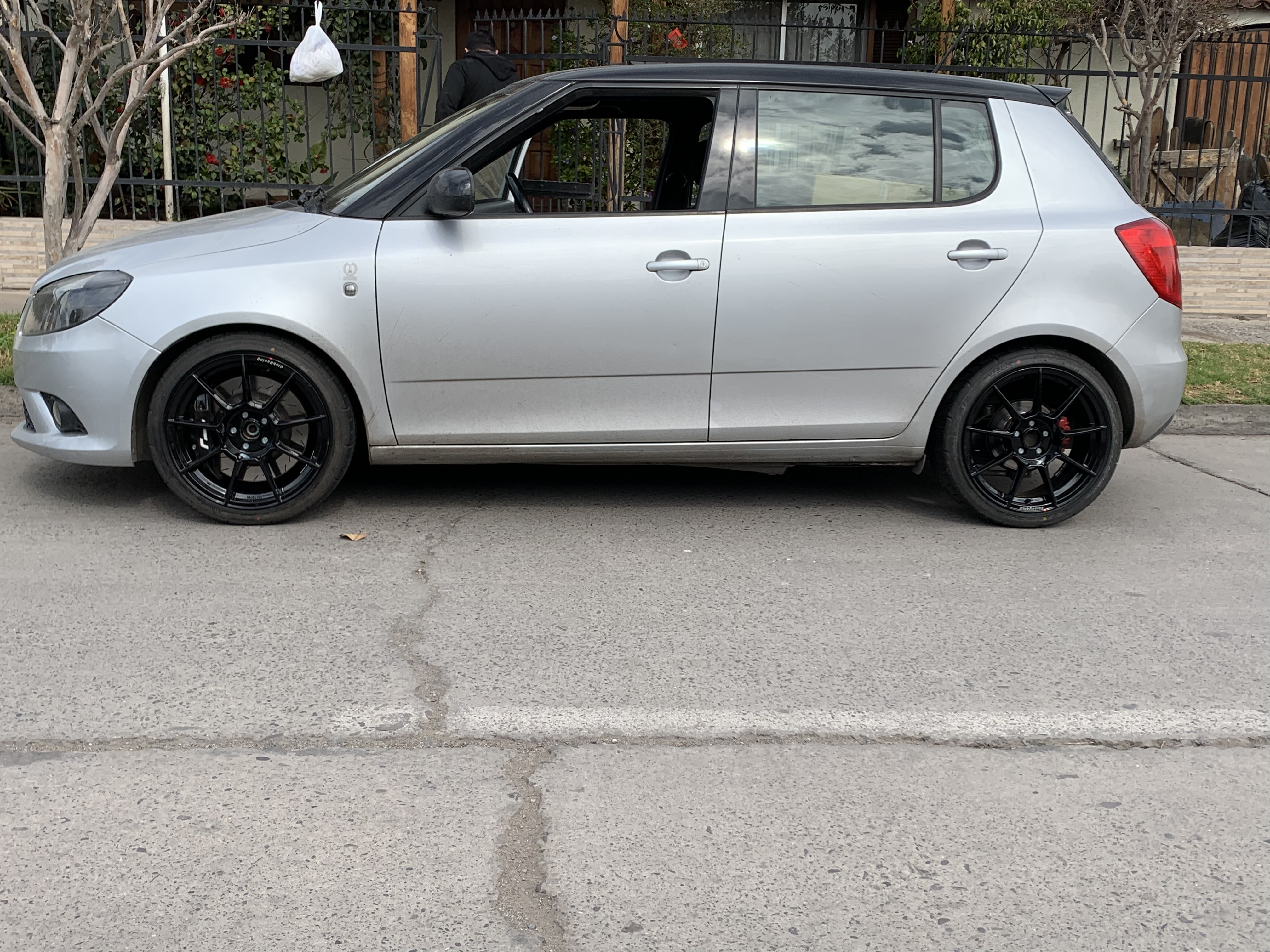

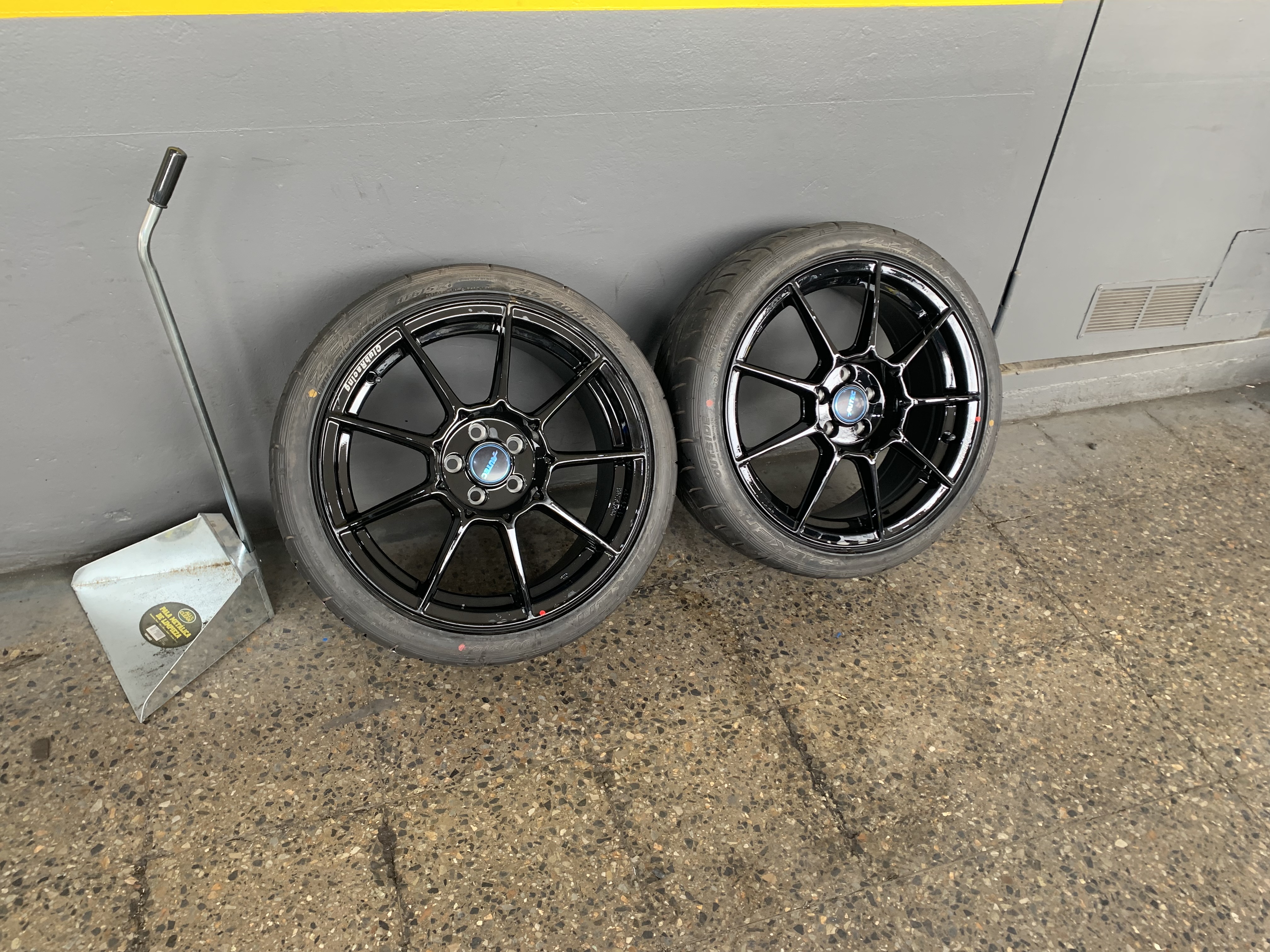

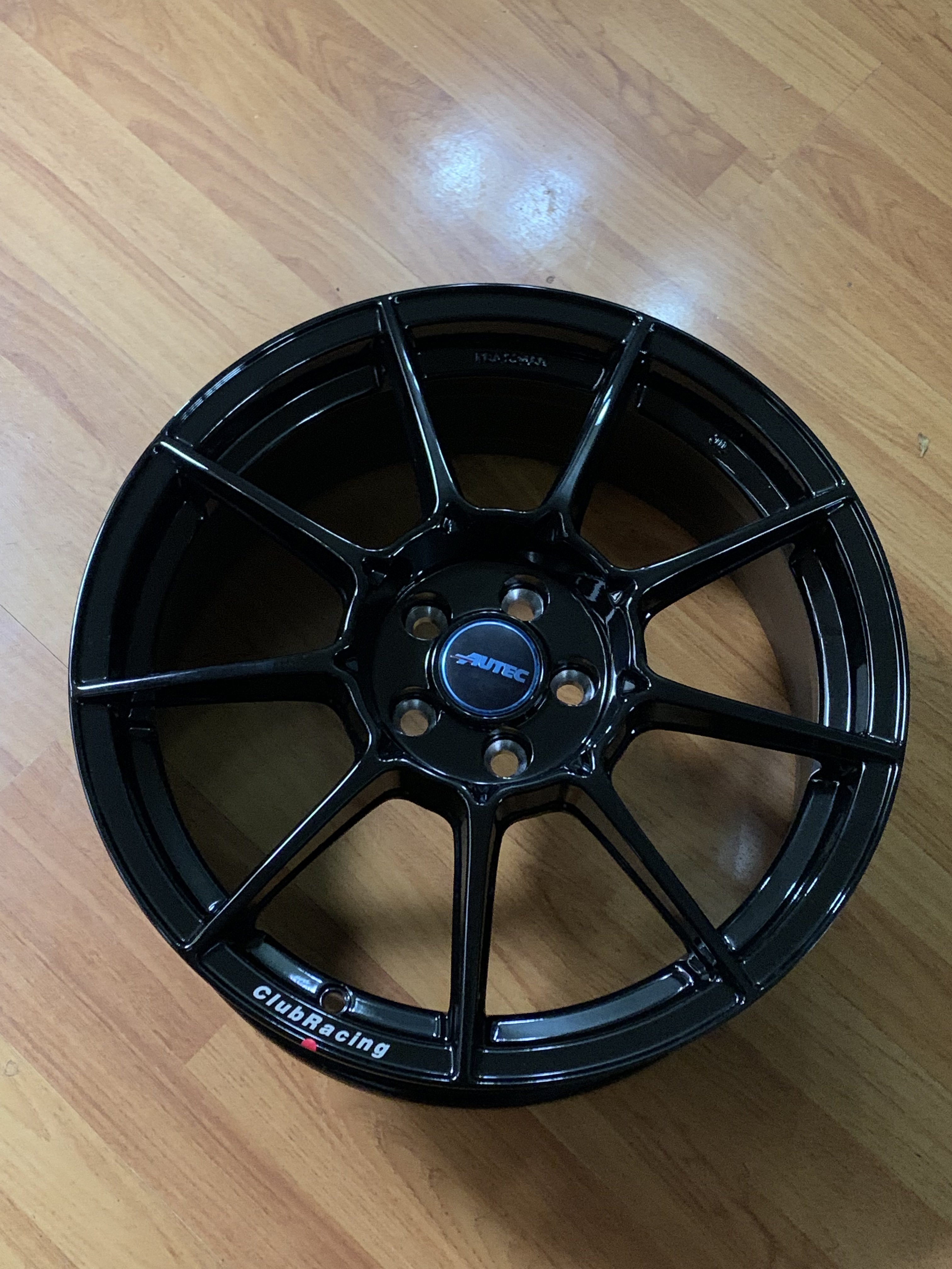

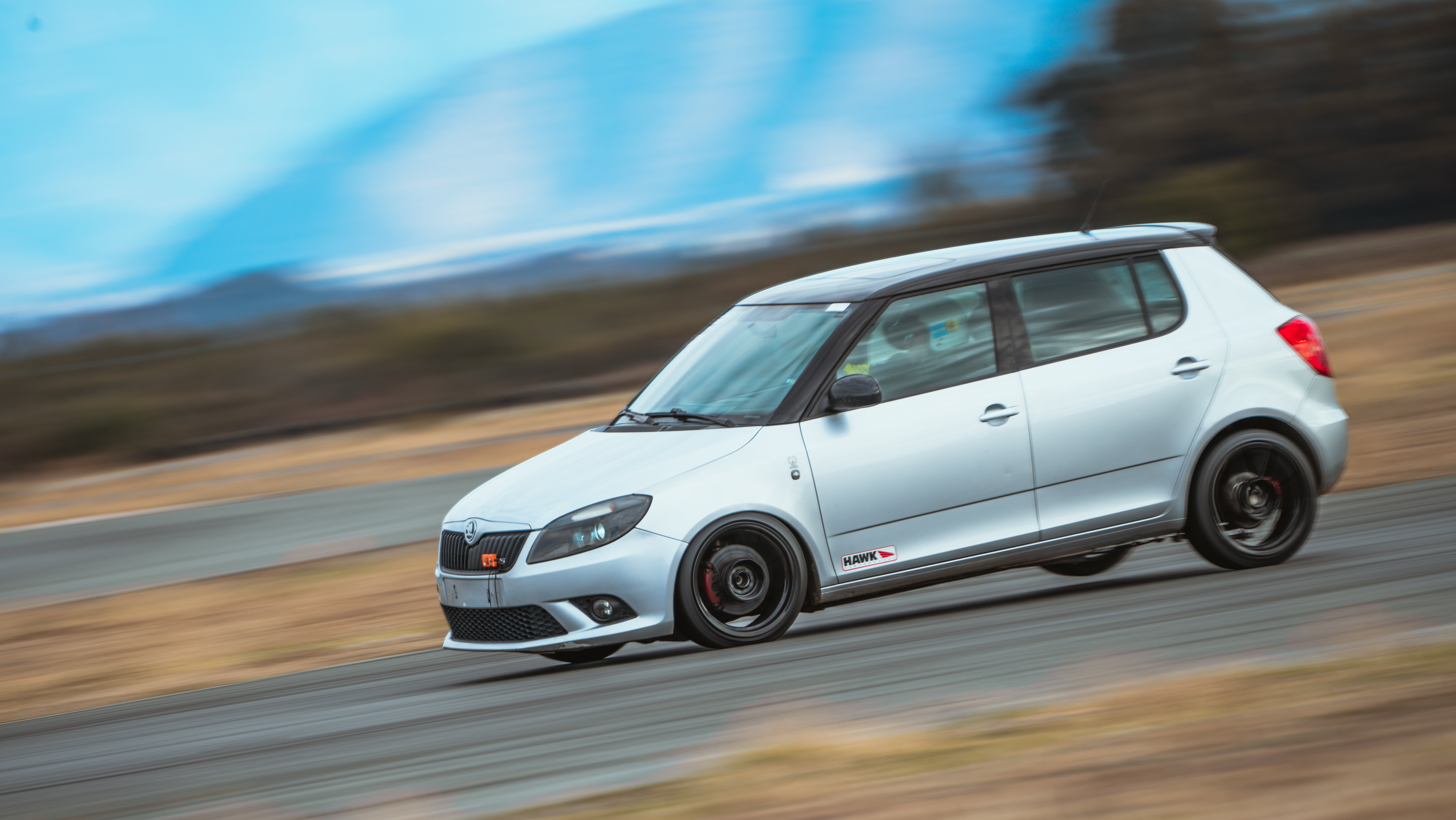

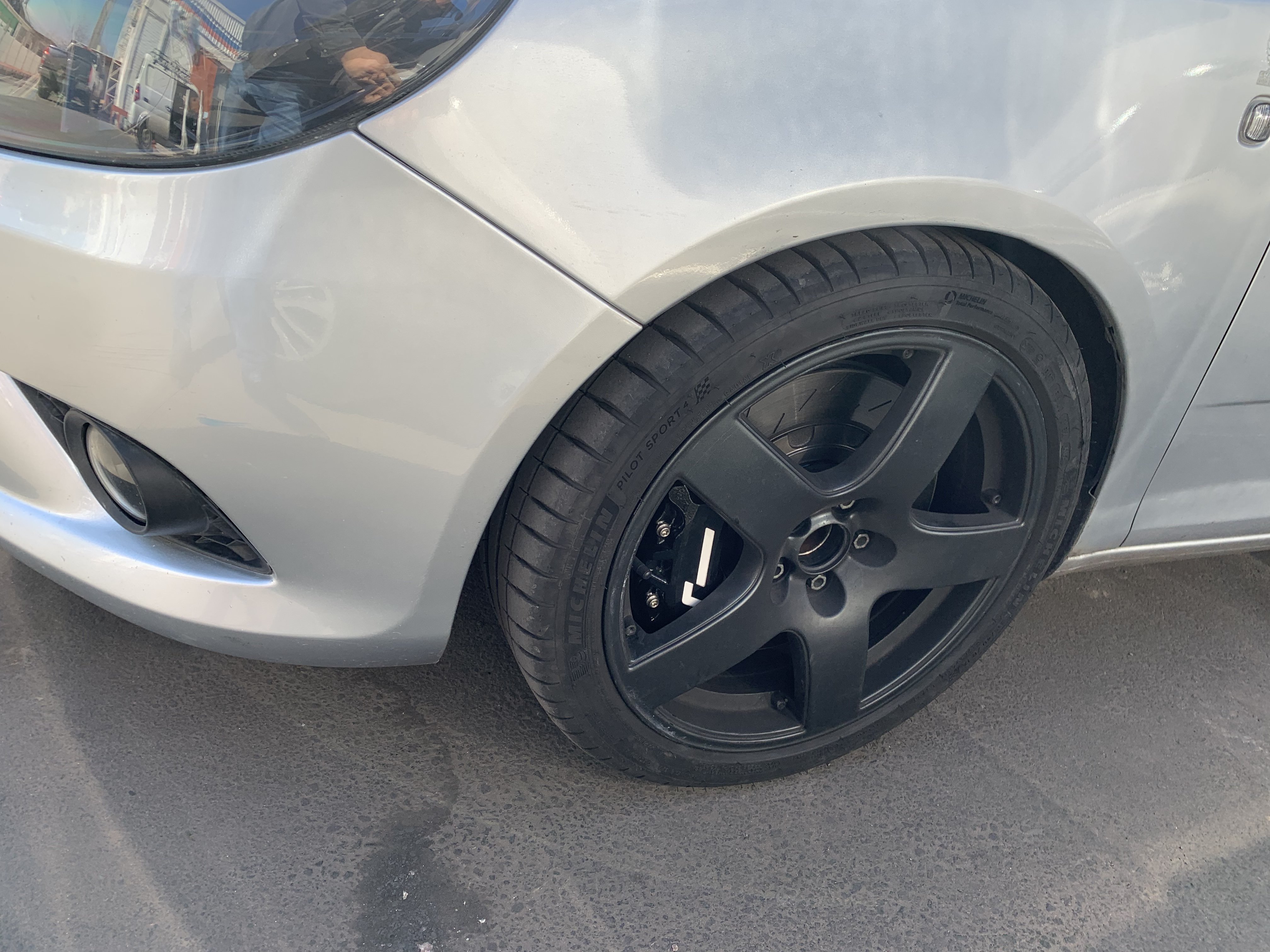

Well, finally wheels are sorted.
Autec Clubracing 17x7,5 et35
Wrapped in falken azenis rt615k+
215/40/17
will be purchasing another set for the road, most likely the silver ones because this wheel only weights 7.7 kg a lot less than the original gigaros

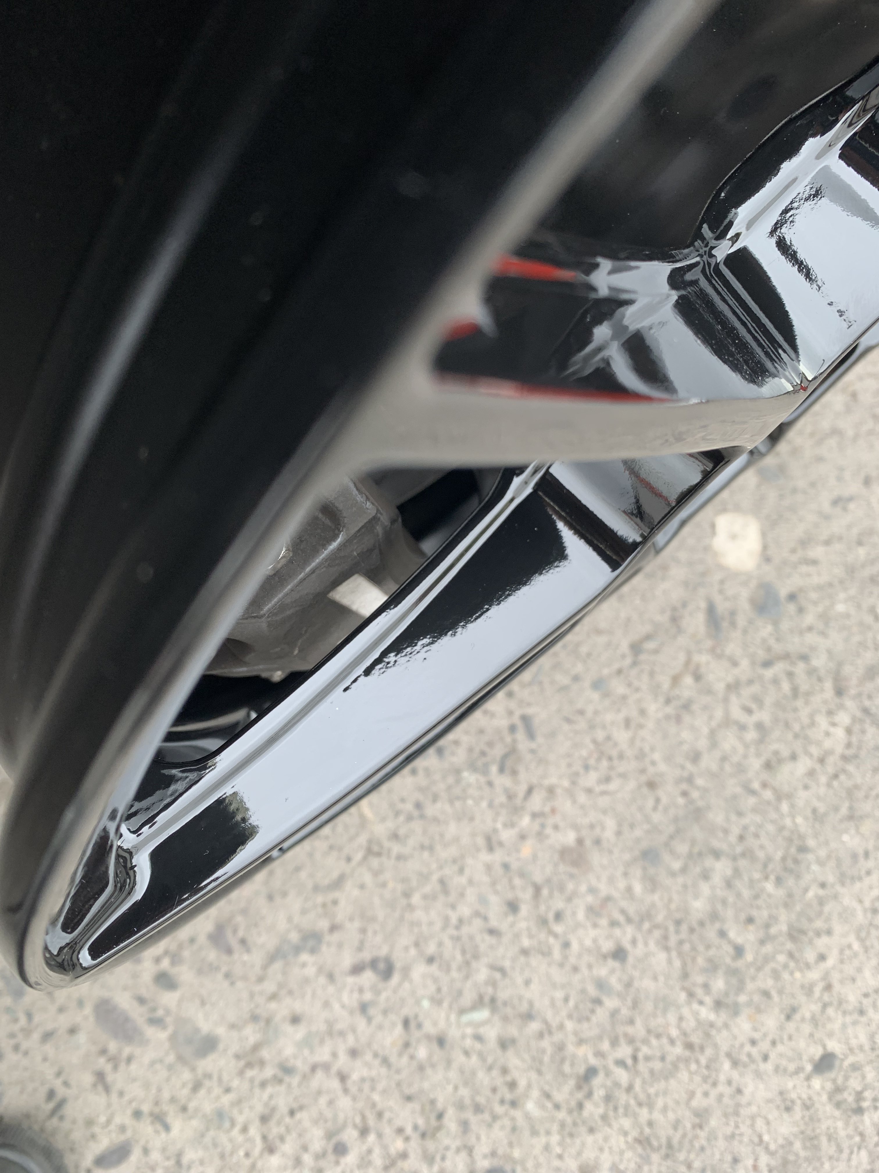

the whiteline rarb already loosing his paint so, f u whiteline. Ordering some h&r at the end of the month.

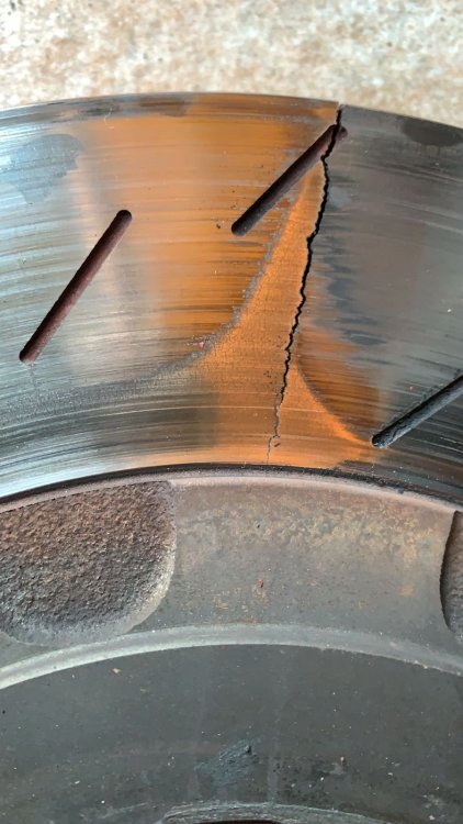

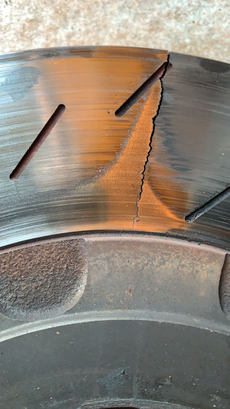

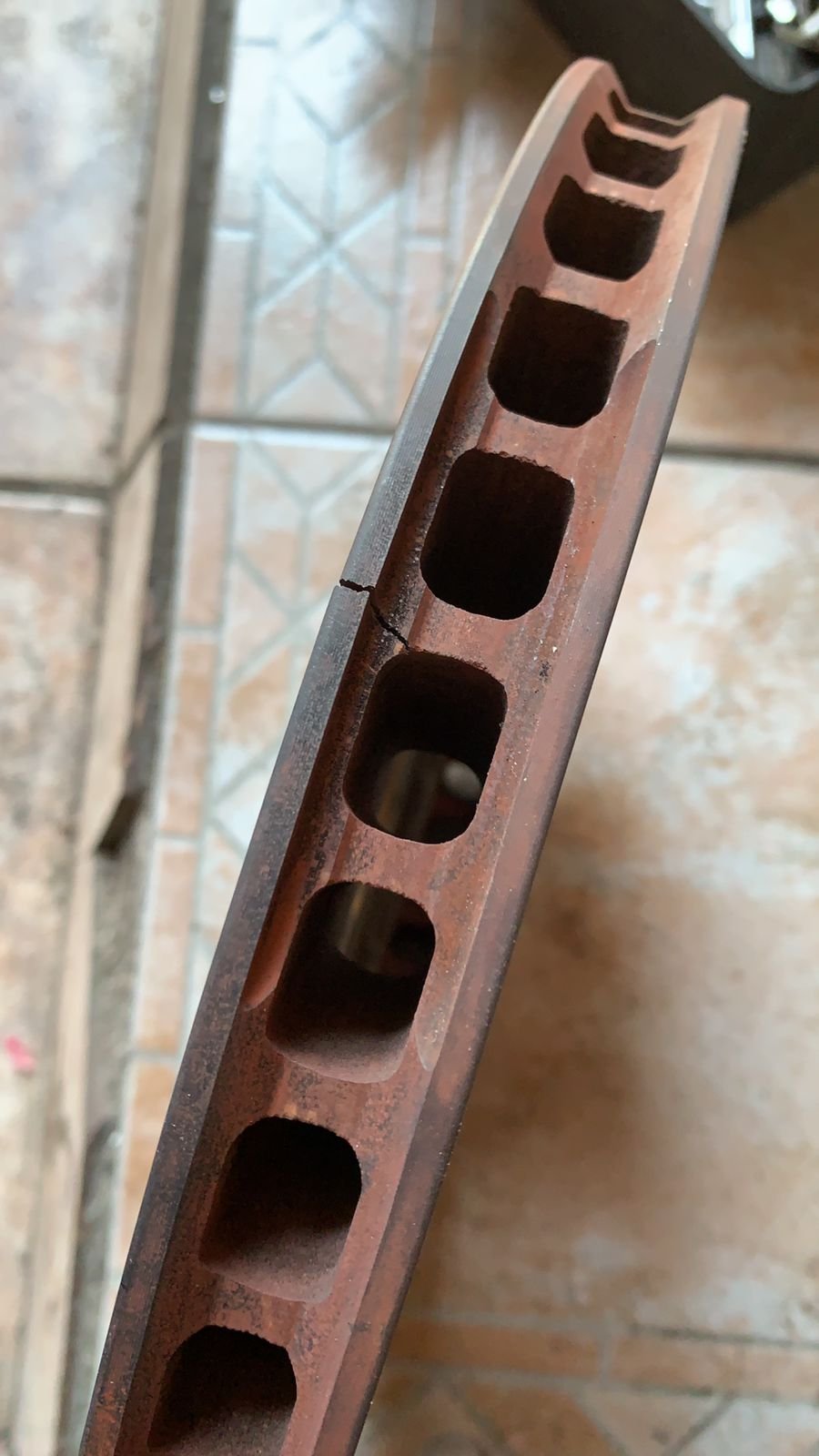

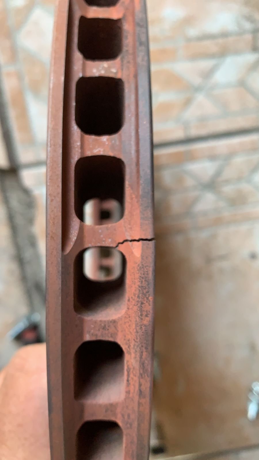

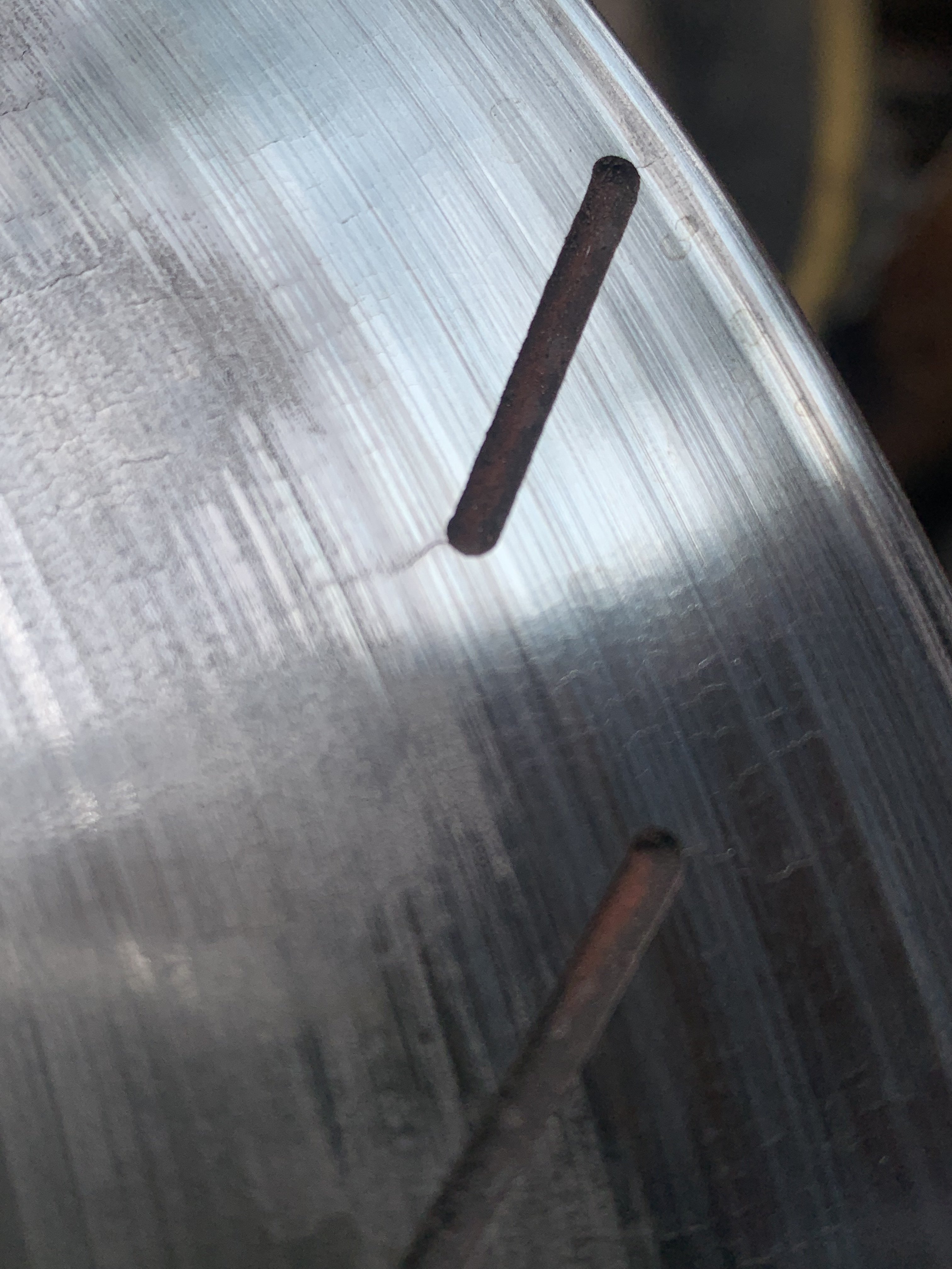

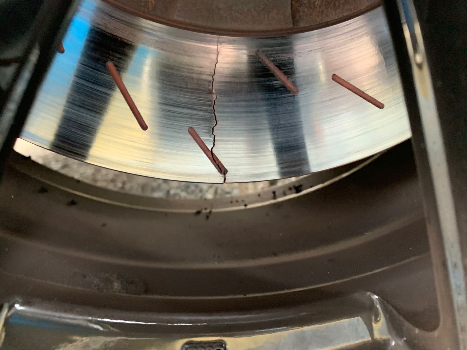

The brake kit failed both disc in the same zone, So maybe racingline should be called streetline, because it performs good only in streets. Gladly they respond with another EVO kit... maybe they found out the lack of performance and quality with the first ones.
Note to myself, never buy a brake product from a company that don't make brakes.

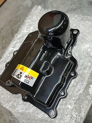

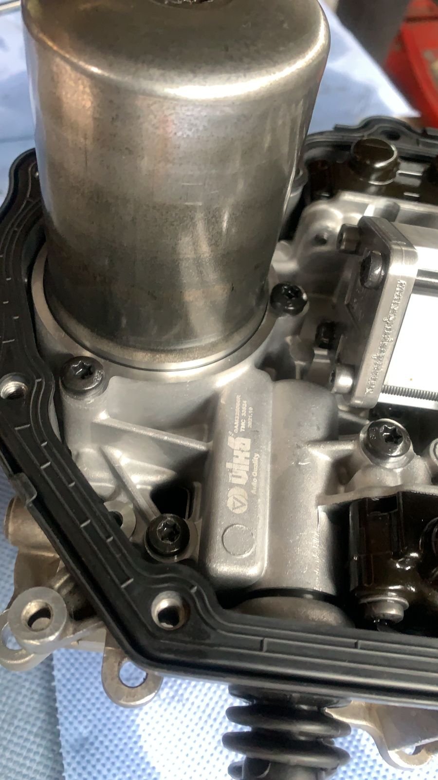

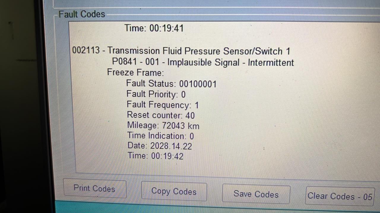

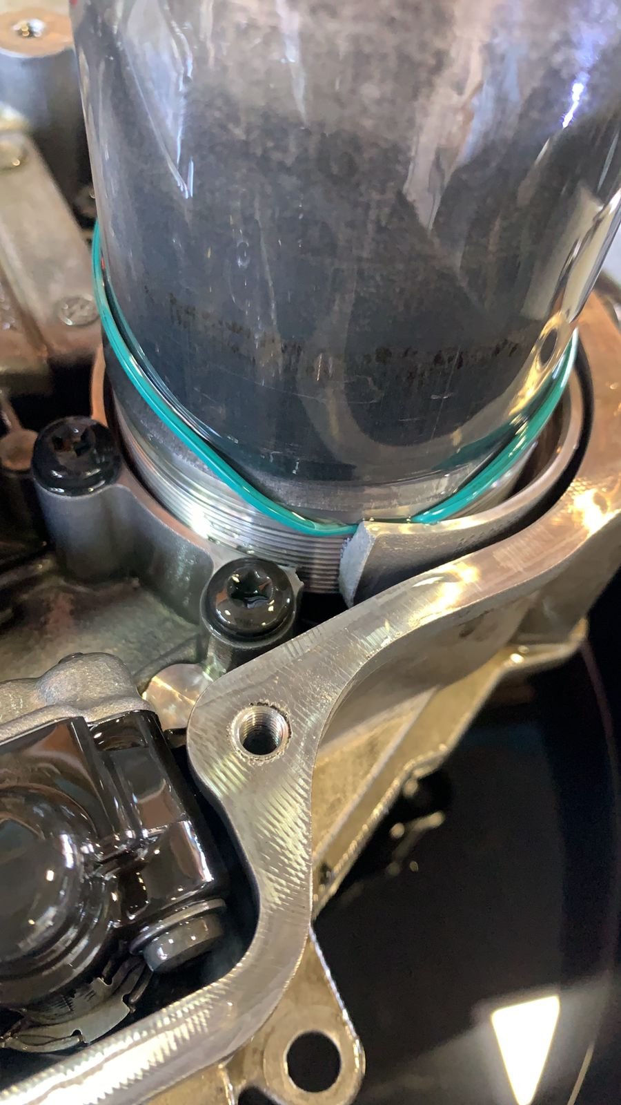

Then.... another bad thing.... the mech died on me, repaired with another valve body, worked,, but the pressure acumulator went bad also, so had to take it to a dsg shop, the pump was running constantly and thats no good... also cluth is going home, so started to save for the replacement one.
Can´t complain much, the car is an absolut weapon on track, rivaling times of cars with more hp so I couldn't be happier
TVS map is seriously good in the performance department. Car just love the track,
Ouch mate!, glad its fixed though and out of curiosity, How much did they charge to fix the mech in your part of the world?
