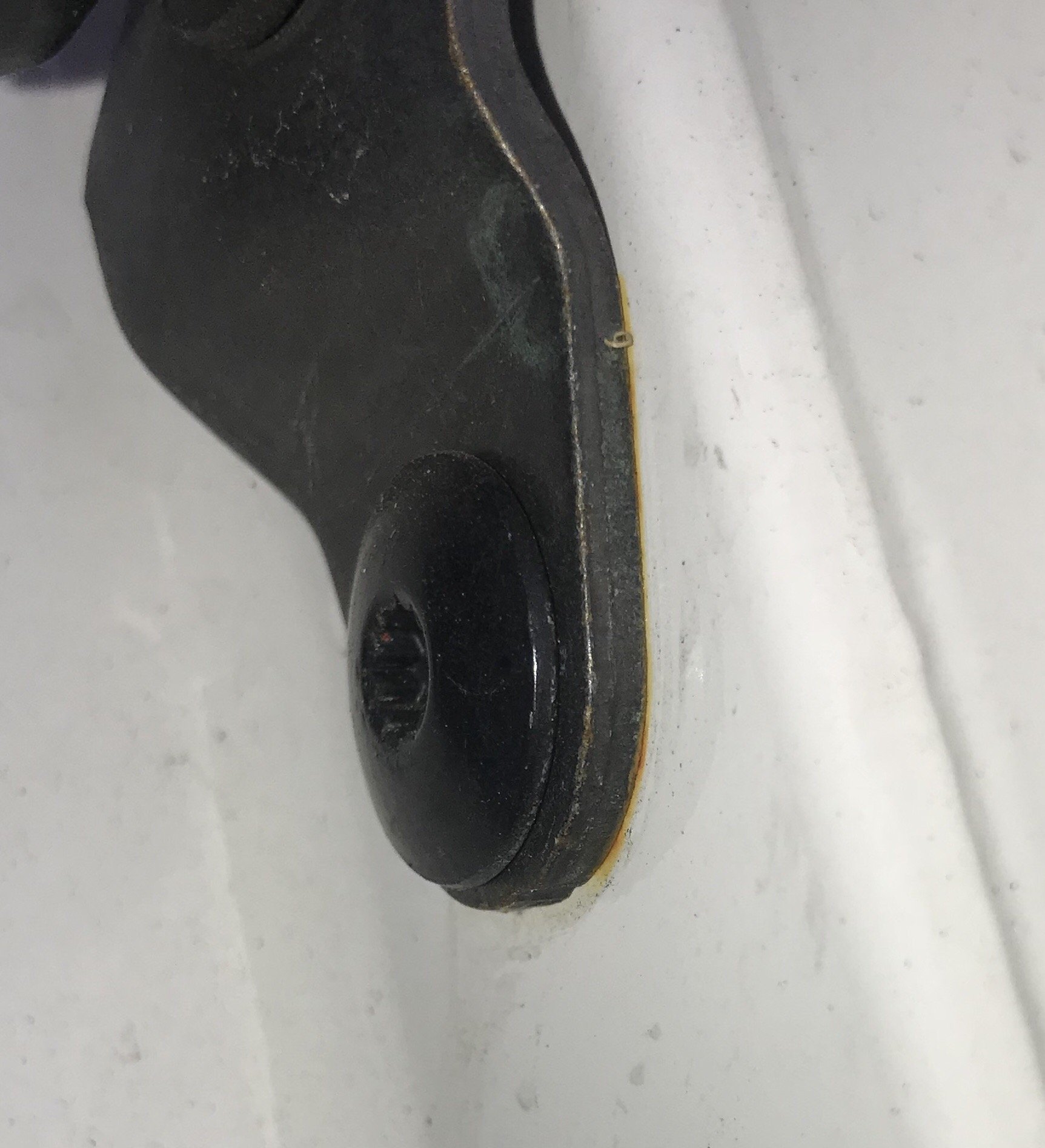

Hi all,
Just happened to glance at the brackets which attach the boot strut pistons on to the body last night.
I can see a clear orange discolouration between the bracket and the body!!!
Surely the car can’t be rusting already? It’s not even 4 months old!
Edited by boff180
Added photo
This looks more like it is from the bracket itself. It doesn't look very well painted...
Agreed.
Is it rust ? Could it be some thing like Duck oil, a spray put under the bracket to prevent rust.  In the picture there looks to be a bit hanging off the bracket.
Needs looking into though.
If it is a protective barrier / wax the Master Tech that removes the bracket will be able to confirm that easily enough,
if there are Quality Control issues or Fundamental Design, Manufacturing / Material Component choice and coating issues Skoda CZ can confirm that.

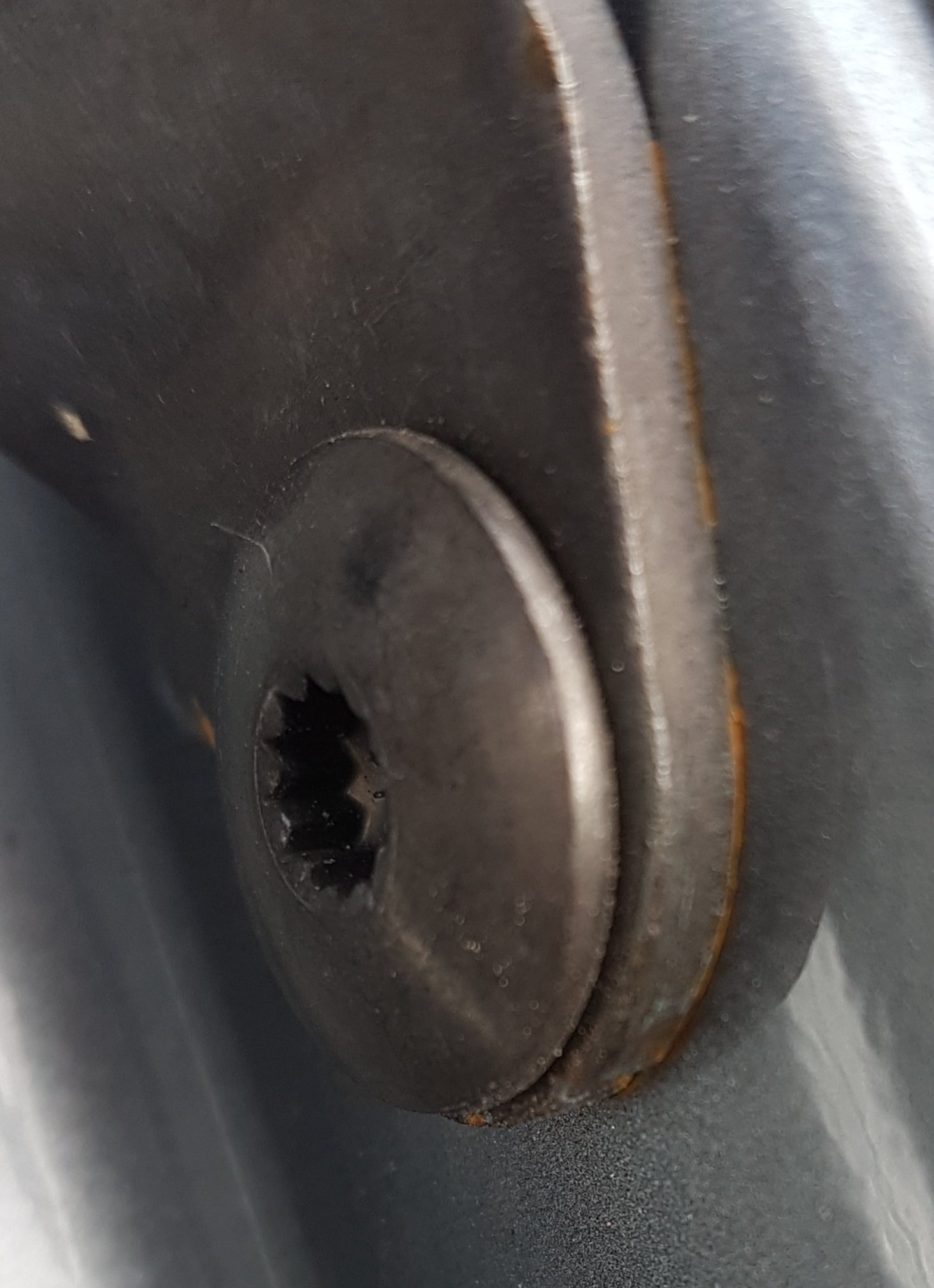

Mine looks pretty much the same! 4 months old also.

Right at the top of your photo there's some rust on the top face of the bracket, by the looks of it?
Yes it looks like it to me. Very similar to yours.
Doesn't look painted at all, more like just a black oxide coating similar to that of the head on that setscrew.

 Keep us posted - as you know I have exactly the same problem!!

I doubt that very much Offski, Just had a look at mine it's the same

Mine the same, must surely affect all Karoqs.
