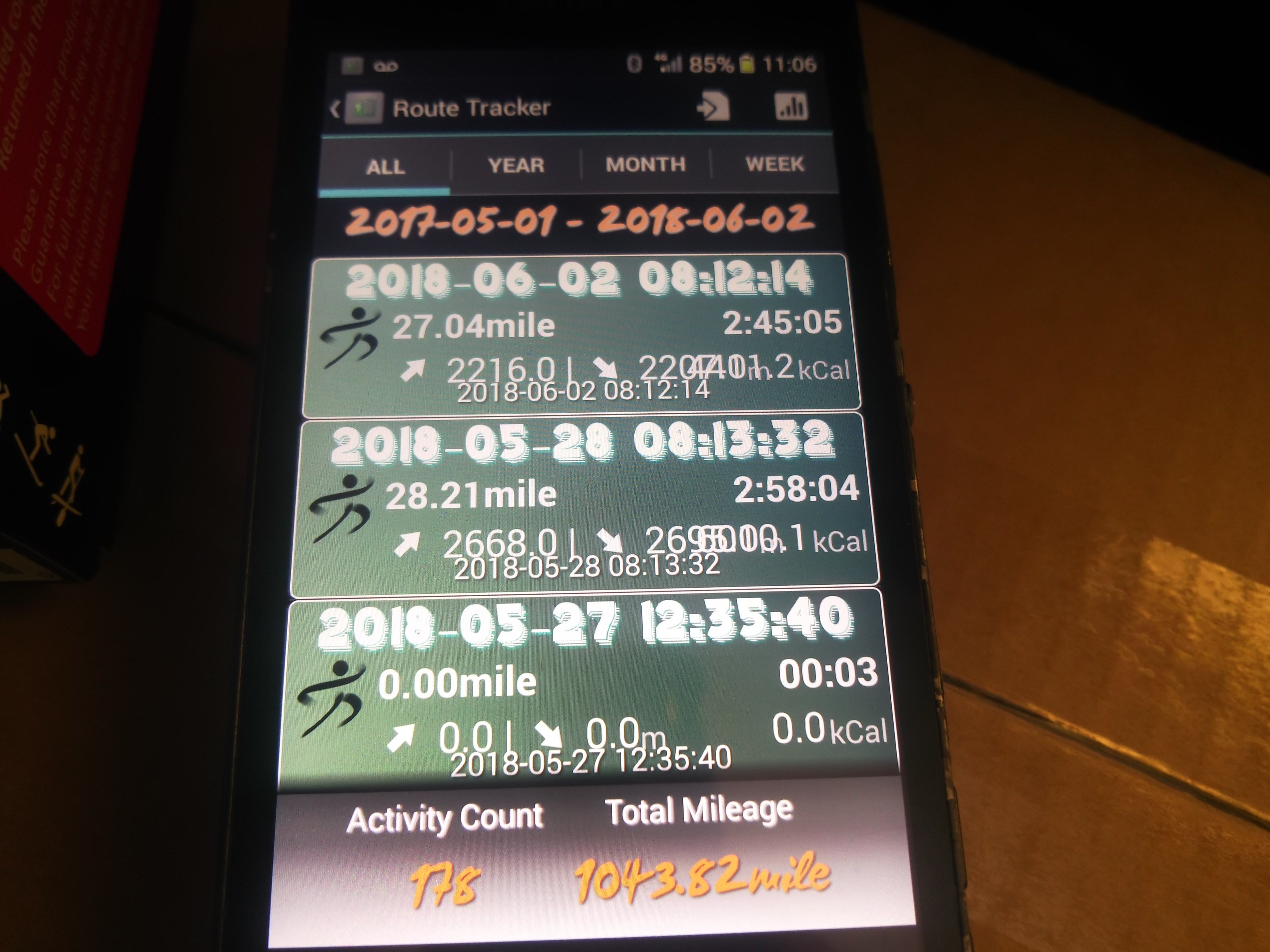

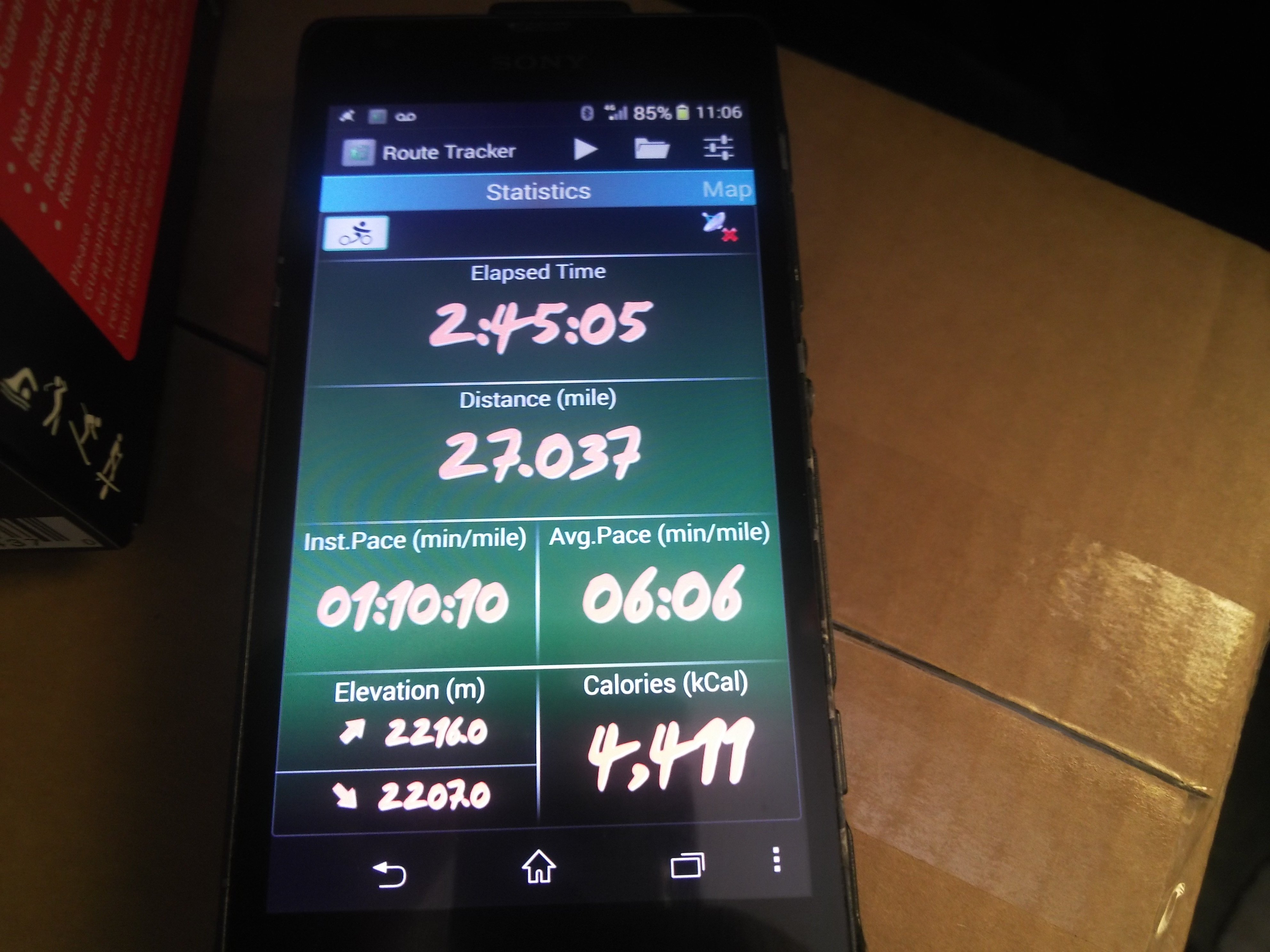

I have 3 GPS on when cycling on my electric bikes , the inbuilt one with the motor that is set by wheel circumference, then the Tracker GPS i use,
and the Garmin GPS on my HR Monitor on my wrist.
The GPS on the Phone and the one on my wrist do not give the same distance as the bike measures, it measures the actual miles the wheels turn.
