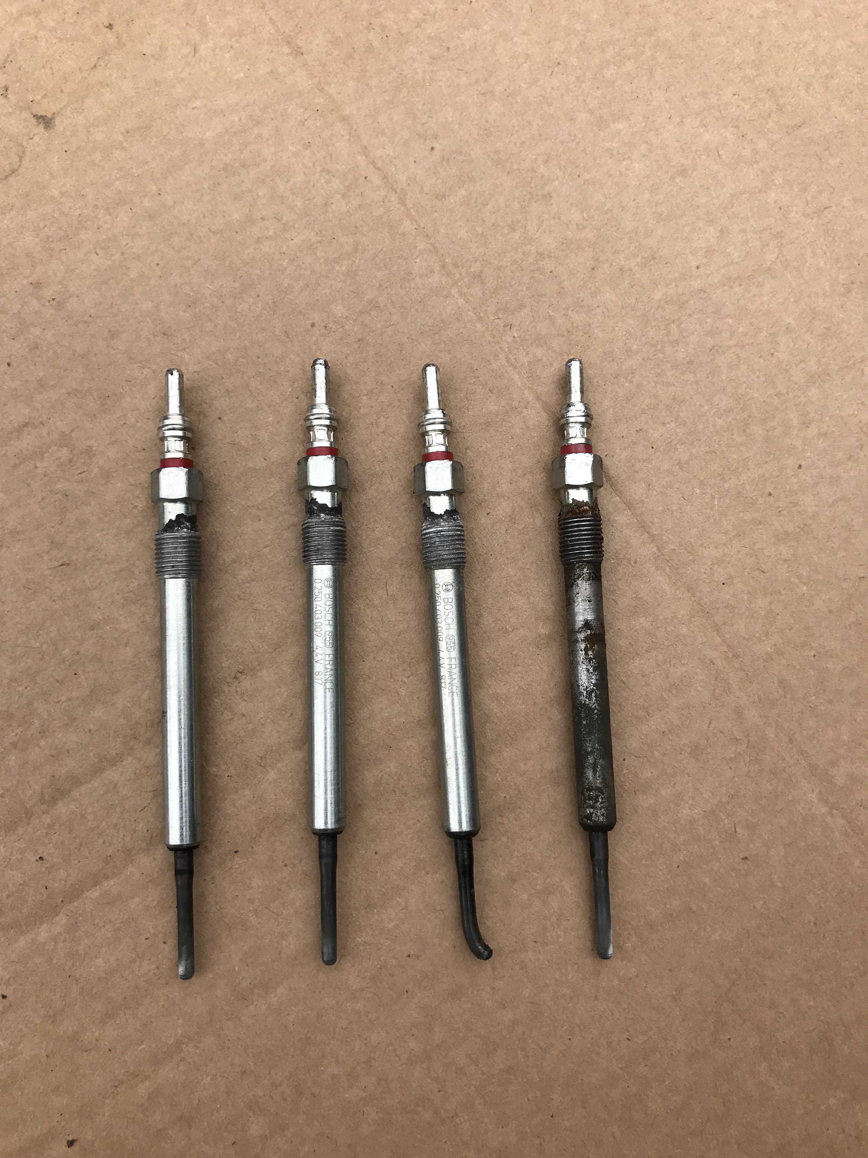

I started by removed the glow plugs which were changed 6 months ago.
1 and 2 look good, Number 3 is bent and number 4 looks very unhealthy.
trying to get my head around why the glow plug would be bent.  No.4 looks like leaking/misfiring/bad injection to me.
It’s a mystery to me too, the only way I’m going to know for sure is by getting deep into the engine and praying it’s not to severe.

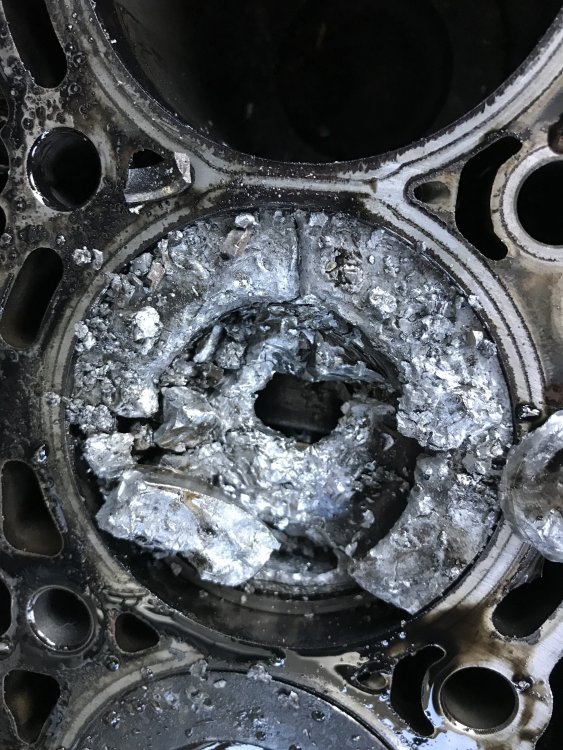

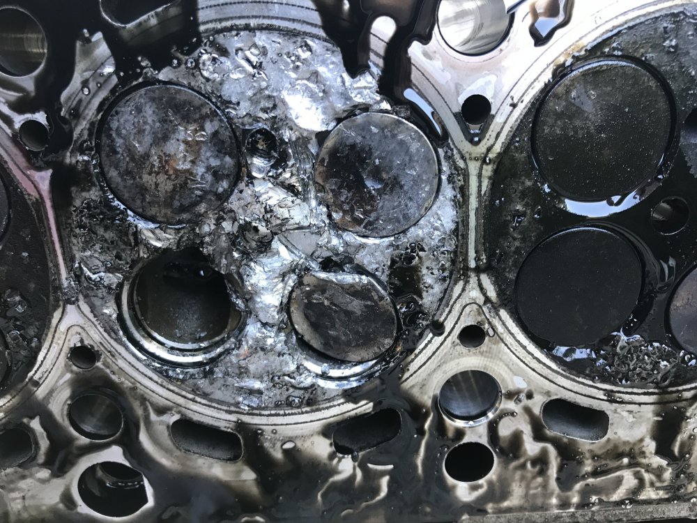

Been a while since I posted an update so here is a picture of what the problem was, and it definitely doesn’t need explaining.
Um, ****. Dare I even ask what the cost is going to be?
Yikes. At least you know what bent the glow plugs now.
It'll be interesting to know where this started.
Gaz
Edited by V6TDI
How many miles were on the engine?
cambelt/water pump or something else?
edit: actually is it just the one cylinder? Wonder if the tapping noise was valve noise, which eventually failed, dropped into the path of the piston and then got broken off and bounced around. Not good regardless.
Edited by cheezemonkhai
