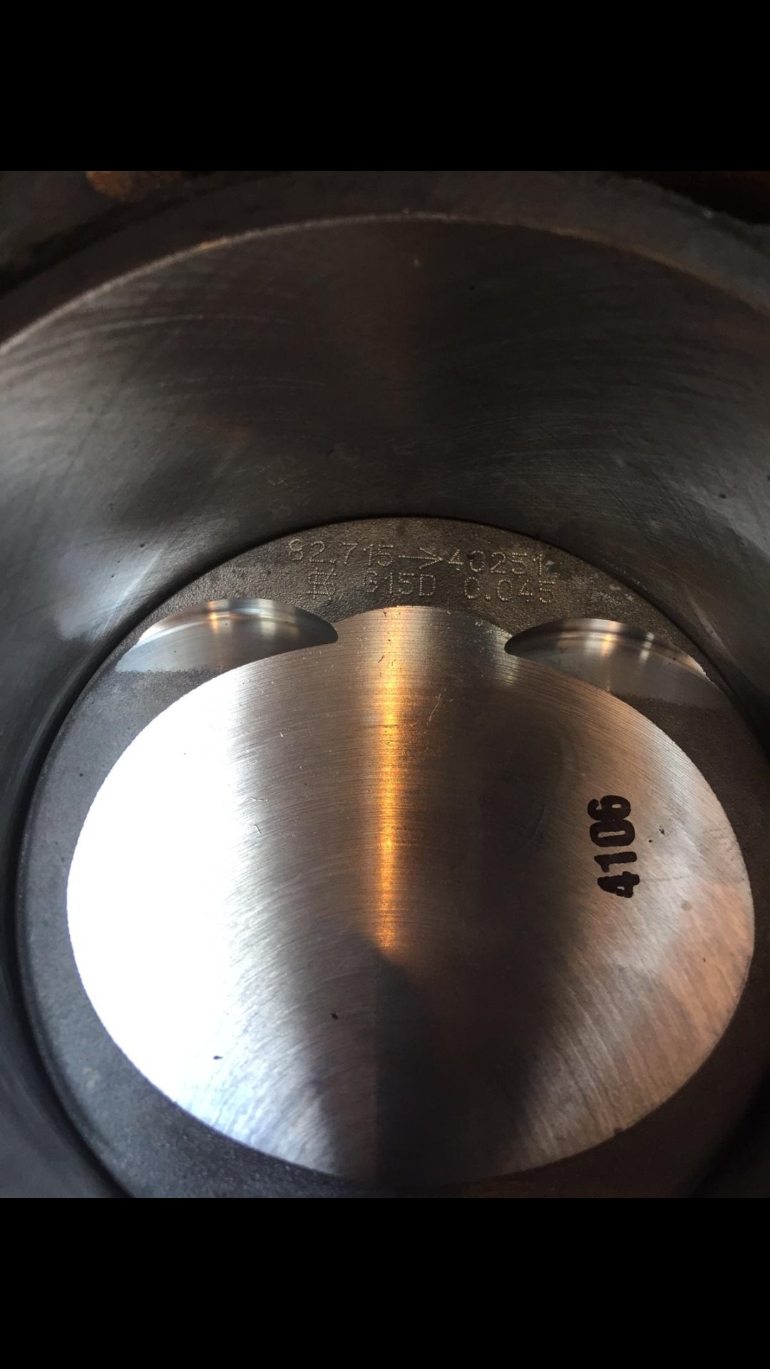

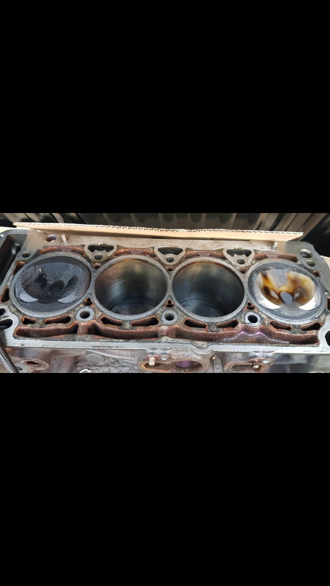

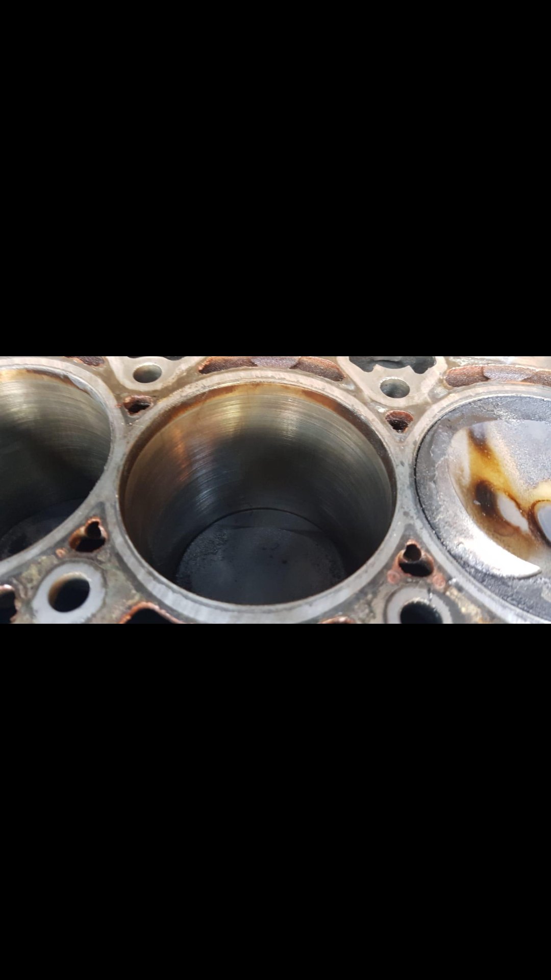

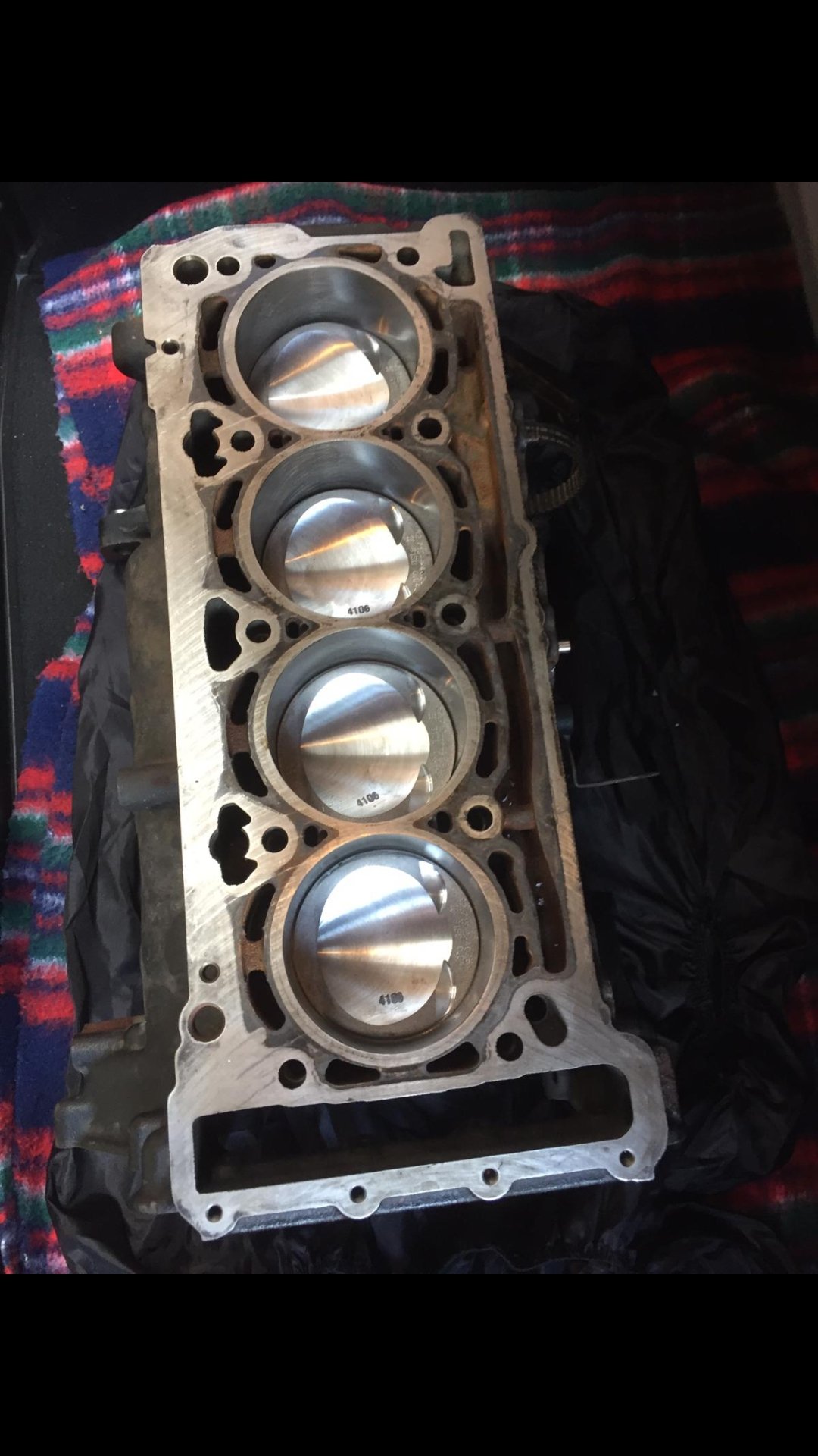

Here is some photos of before and after the rebore. The total cost of taking the engine out, doing the rebore, fitting the new pistons and putting the engine back was nearly £2k.
Luckily covered by the warranty.

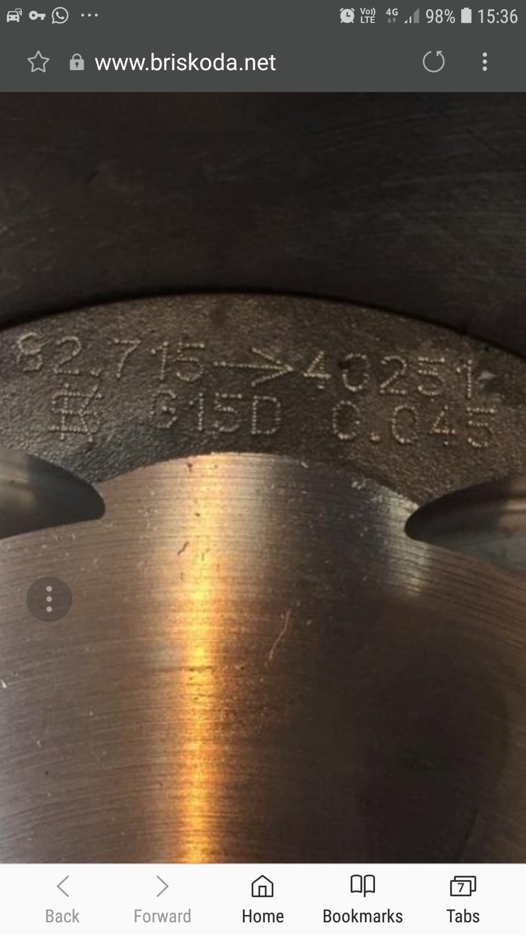

Can you mention pistons manufacturing code?
Engine looks pretty much OK and I hope after repair to be restored almost to its initial condition for your satisfaction.
Here is a close up of the piston. Sorry I don't know manufacturer.
I've done 500 miles since having the new pistons and rings. It hasn't drank a drop of oil. It would normally have had 1 litre by now. Job done.
