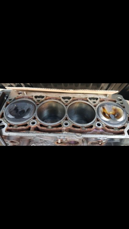

  • The results are in!!!!!   Skoda allowable oil usage 0.5lt per 1000km My oil usage 2.3lt per 1000km    The dealer is now being a complete arse and refusing to refund me, coming

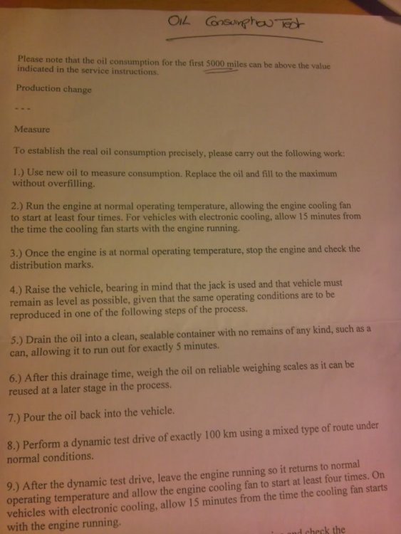

  • An Official Oil Consumption test is not £200.  Removing the oil, new oil and filter, drive the 186 mile / 300km, or really it should be 1,000 miles without putting a low oil, low oil pressur
or really it should be 1,000 miles without putting a low oil, low oil pressure light on, or if it can do 1,000 km / 621 miles without drinking .5 litre oil,
or times 2, so 1,242 without drinking a litre.
Then drain the oil which you weighed before the test and compare the oil use.   A test not fit for purpose.

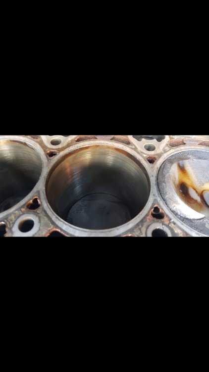

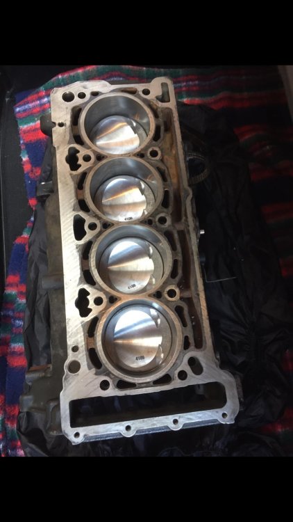

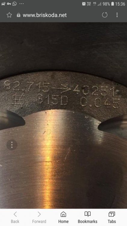

Known fault,
known by VW / Skoda, but Skoda are not fitting a new engine.   Reject the car.   The Dealership can get their new engine from Skoda.  Doubt it though.
It is 2 Minor Oil / Filter Services just without the Servicing just changing the oil and filter, taping up the oil cap and dip stick.,
then after draining reuse the oil that was only in for 180 miles
plus what was used because the test is done on an Excessive Oil user.

My local main dealer quotes me £198
They can quote what they like for there labour, and materials and VAT, but they are taking the Pith.
The test is not fit for purpose and never has been.   That one linked has a major error, a litre of engine oil is not 1,000 grams.
here is how it used to be done.
Edited by Offski
