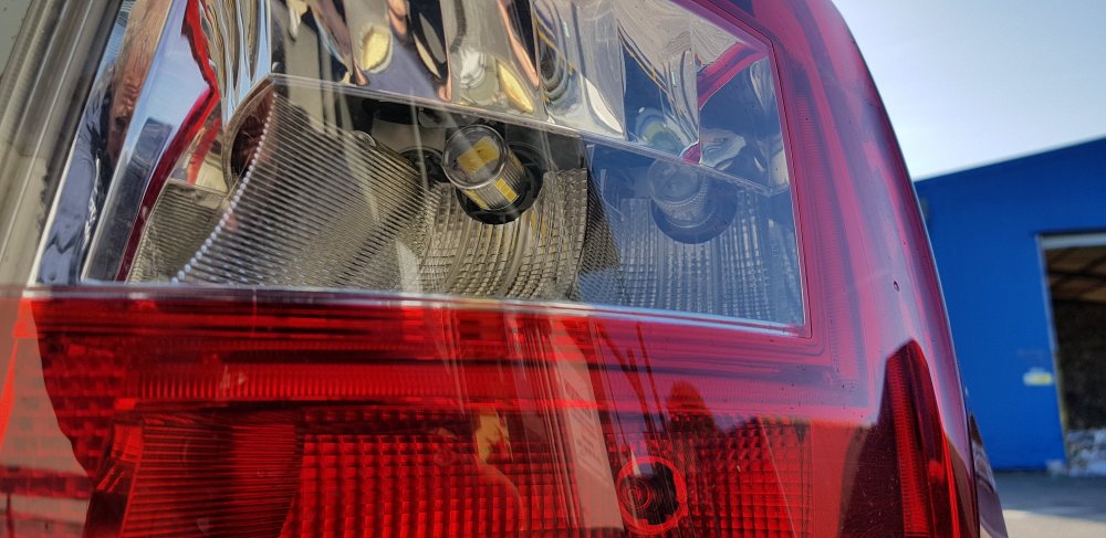

Replaced the rear indicator bulbs, no problem. Front ones not yet replaced as I have HID bulbs and no access to indicator bulbs. Can anyone advise easiest method of getting to them?
