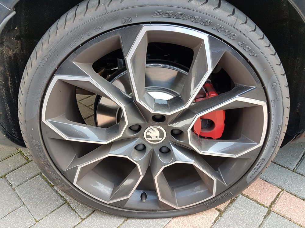

Just ended up damaging a tyre.
Obviously the warning light has come on.
If I get a local tyre garage to replace the tyre, is there anything they or I need to be aware of?
I actually have no idea how a tyre pressure monitor works and don't know if there is a cable or something that has to be connected to the tyre, or if something has to be reset or calibrated after.
Pirelli p zero 225/35/19 88y
