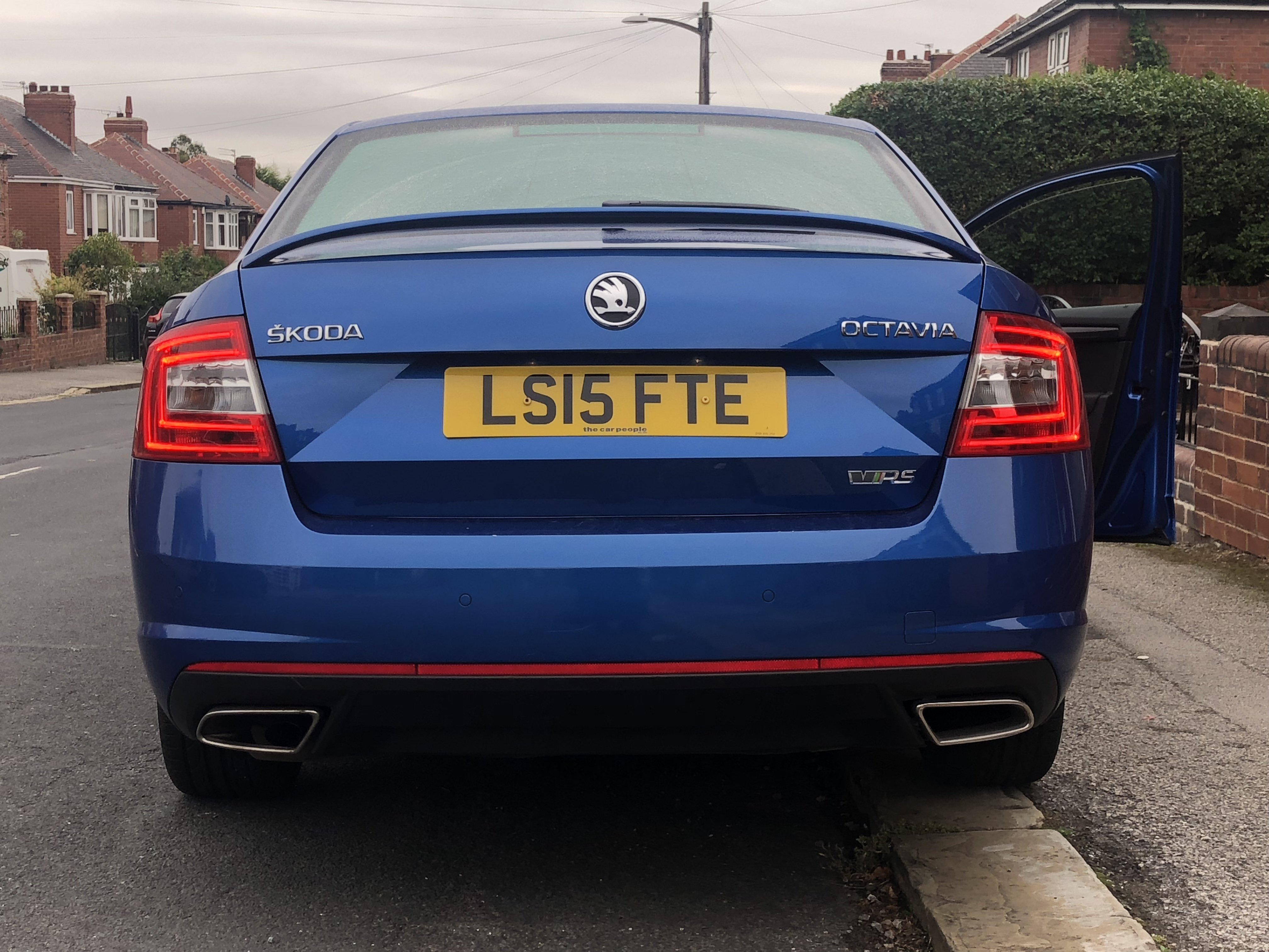

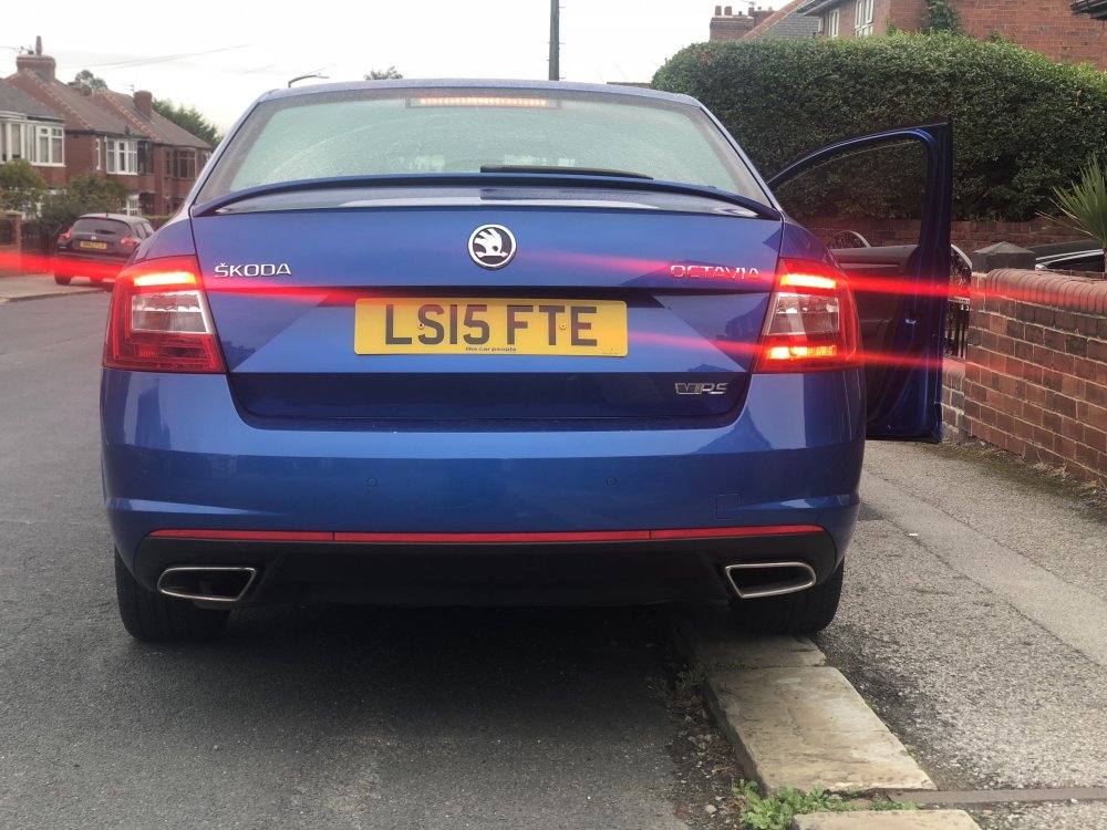

So, a friend notice my brake light was out on LHS,
appology if this has has already been covered
shown on the pics below....as an amature on VCDS I’m scared to make any adjustments to adaptation etc without guidance.
the bottom incandescent light which comes on with fogs on right cluster but not left...I had ago on VCDS and managed to turn it on as a fog light but still doesn’t light up when braking as shown below.
i tried changing Liechte function 26nsl....B26 and it work for dogs but then tried to do it as BRAKE LIGHT and adjusted the dimmer to 100 and no brakes worked at all......S#%t myself and undid every thing I’d done.
so the lamp works but isn’t programmed as a brake light whereas the other side is???
Any help greatly apreciated

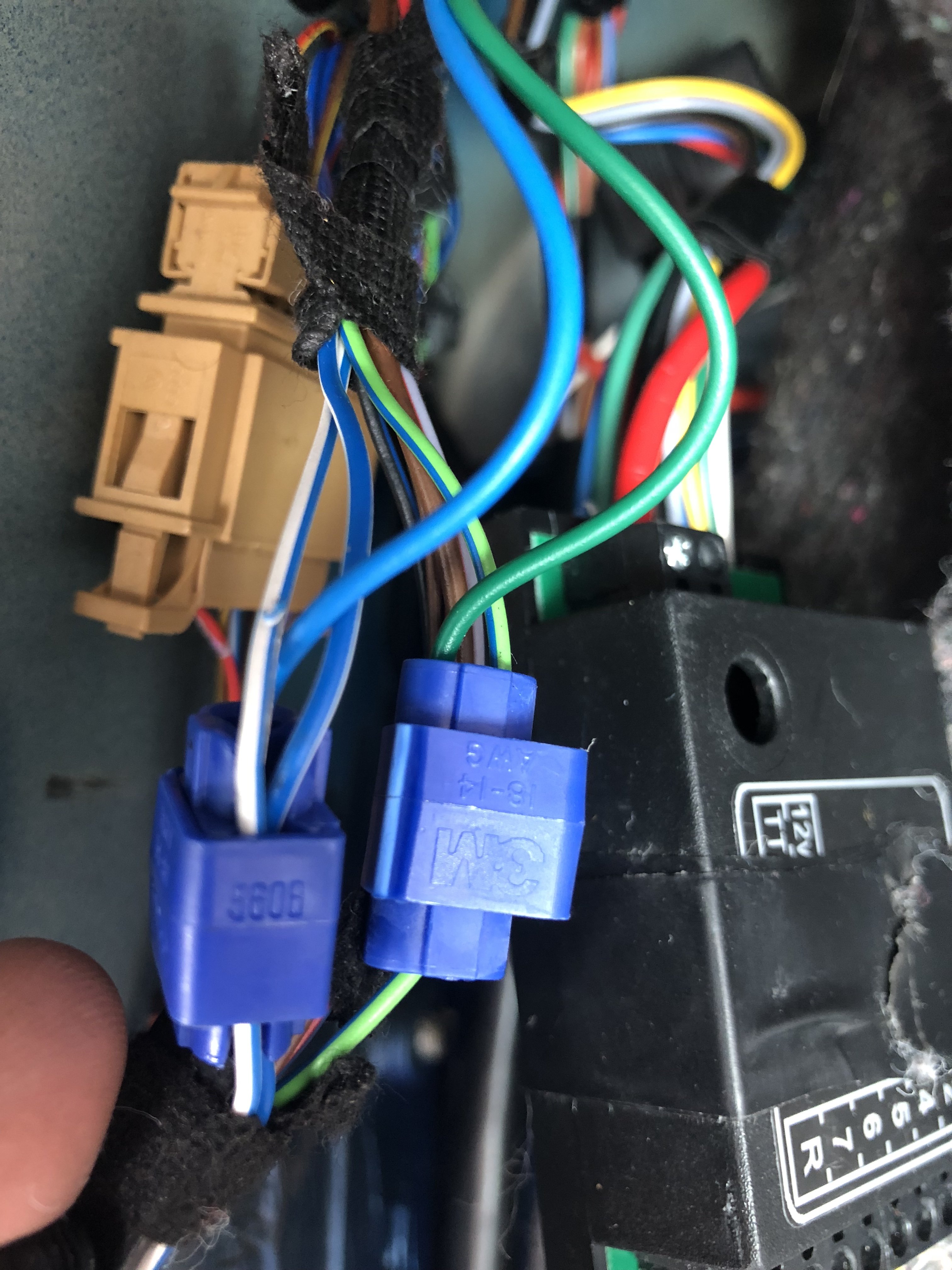

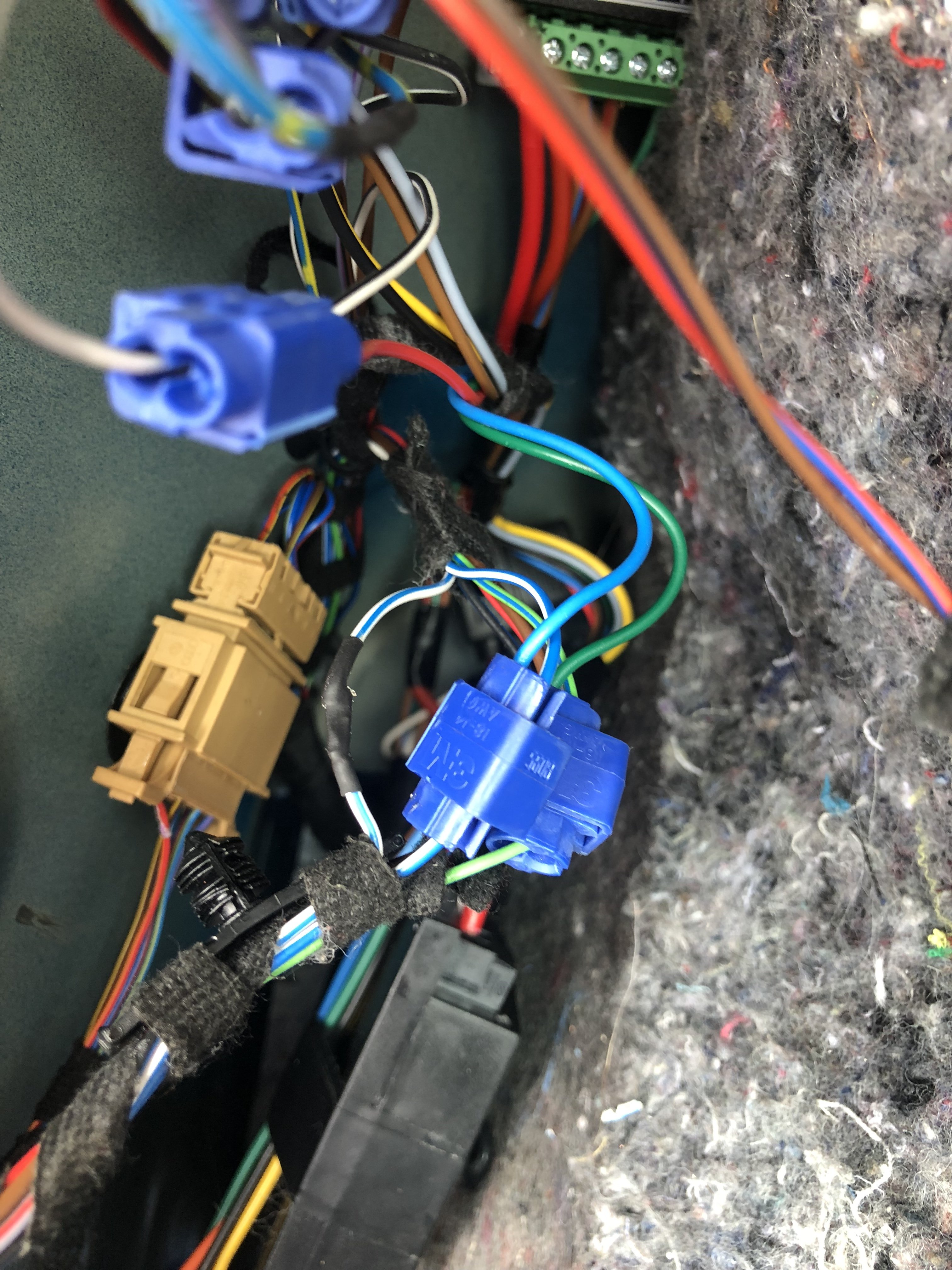

So... today is a good day.
thank you for all your help but it’s. Ow sorted...unfortunately is got it in my head that the light isn’t on instead of why is that light on!
The bloke who fitted the tow bar has taken a feed from the blue white white strip (lower incandescent FOG light) and for no reason shorted the white with blue strip (LED brake light) in one of those awful connector blokes
imageproxy.php?img=&key=66c1d7df650950da
I’ve removed and repaired the LED imageproxy.php?img=&key=66c1d7df650950daimageproxy.php?img=&key=66c1d7df650950dabrake light wire.
