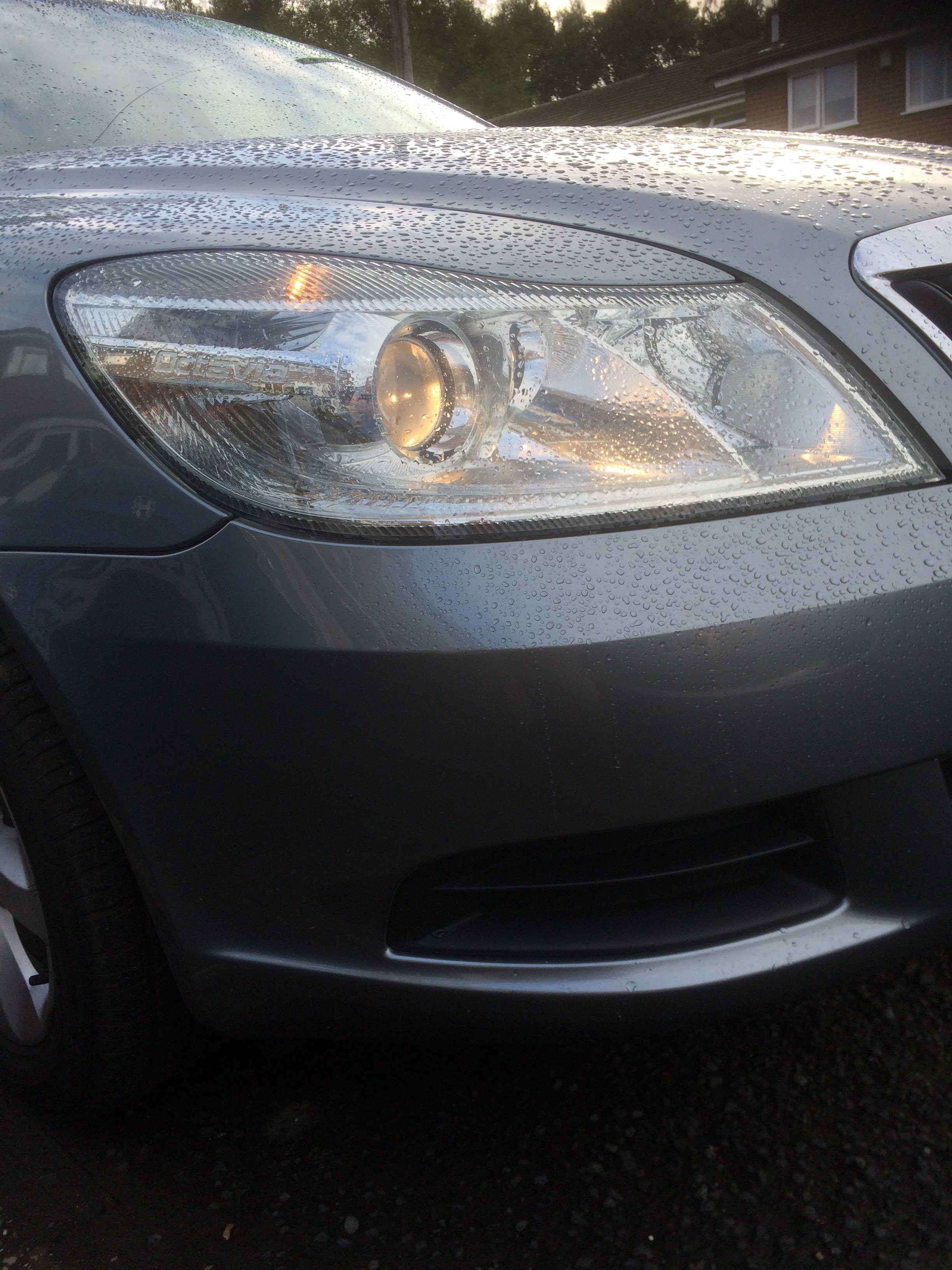

I assume these are the lights you asking about?
drlleft.jpg&key=4ff771bcba647869dde911c7
No fog lights on mine, just the headlight/sidelights as you see here, which are now permanently on. The rotary light switch is now effectively redundant. Oddly, the audible security “peep peep” sound which accompanied the remote locking is absent, so I think as you say vcds is the only way to sort this out. There is a lesson here about not messing with the factory reset !
Excellent, those aren't daytime running lights which is probably why the maxidot menu is absent and the indicator method doesn't work.
When you move the switch to 'sidelights' do the headlights turn off? At a guess, the light switch may have failed which would cause the headlights to always be on.

When I move the switch to sidelights nothing changes, remains as in the image. As mentioned, the light switch is now redundant. Your conclusion that the switch has failed is the same as in another thread I followed. Same problem description, he had it checked, new switch fitted, all ok.  It seems that as a safety feature the lights are designed to stay on if the switch fails.You were right about the "ata confirm" in the maxidot too, ticked it, peeps back on.  Well a big thanks to you Langers for heading me in the right direction, I'll get the switch checked out and see what happens. I will let you know what the outcome is. Thanks again !

Is that what you have in the picture, sidelights & dipped headlight.

Again, remains as in the image, no lights control at all.
