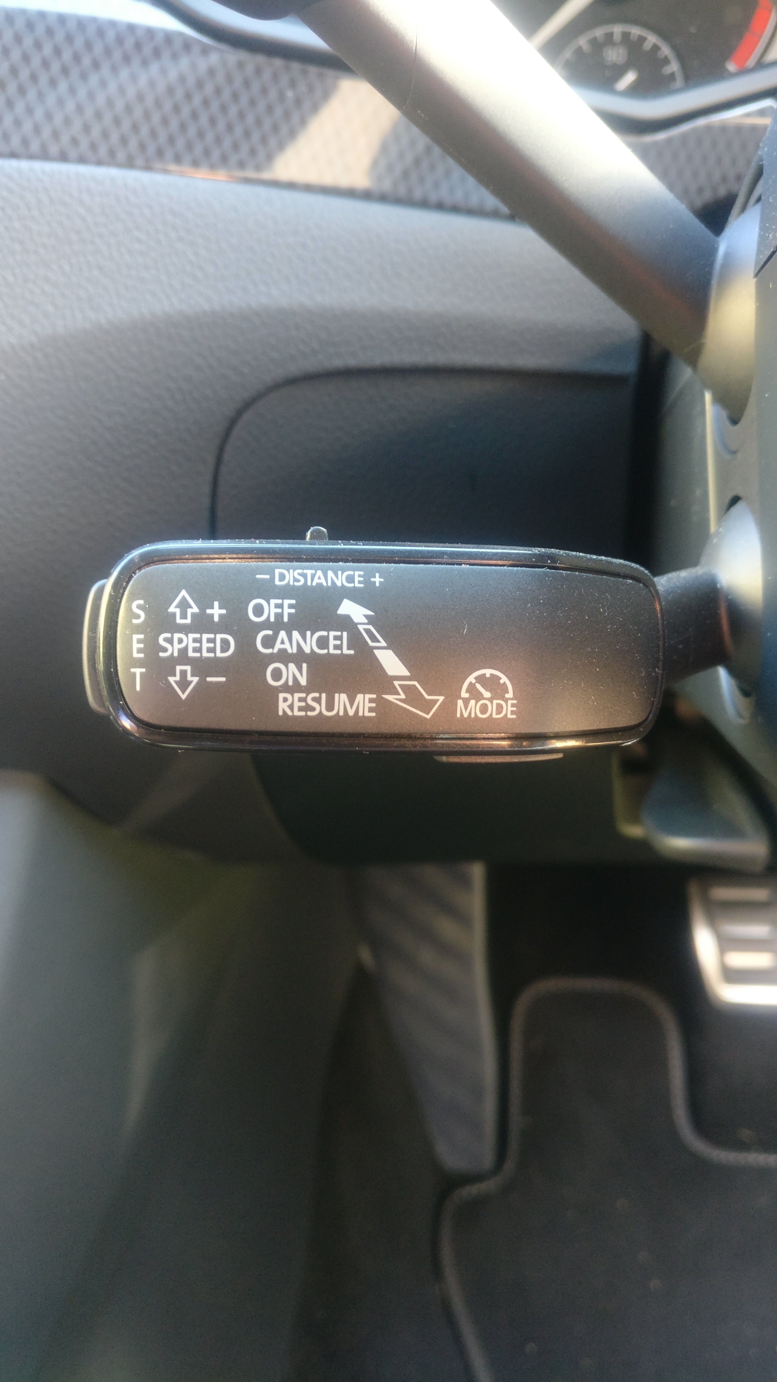

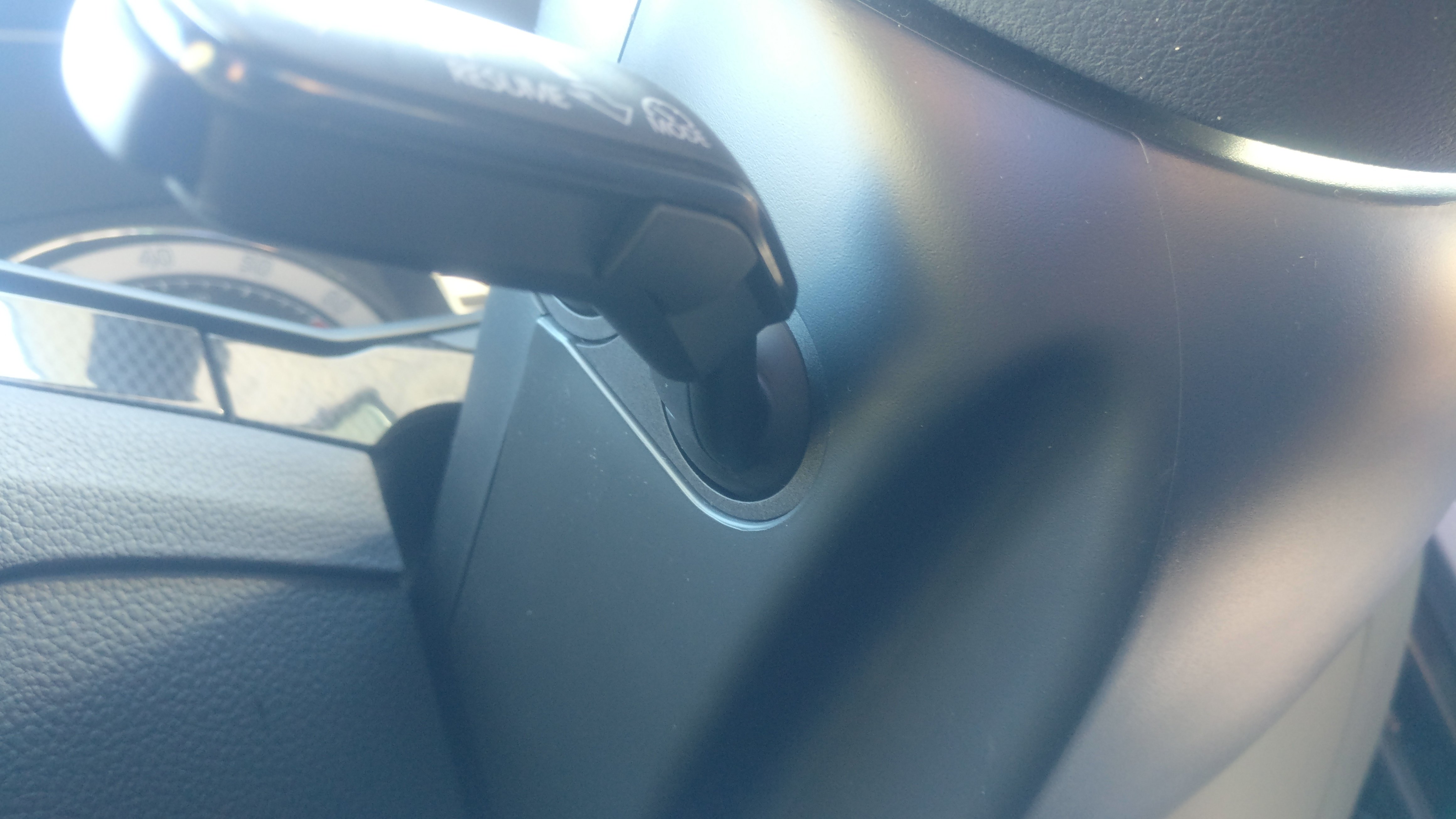

Attached 2 pics, if you have the mode button it wilk say mode, you can "just" see the switch under and also a pic of underneath the switch showing the actual button. IMG_20180927_121735.thumb.jpg.30eb20d701feb7b8955950617b39a956.jpg

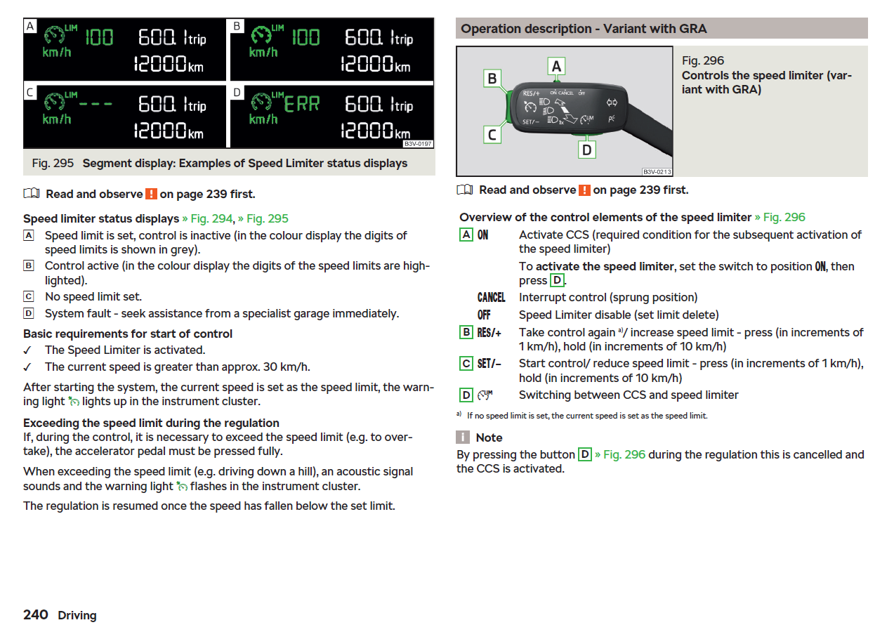

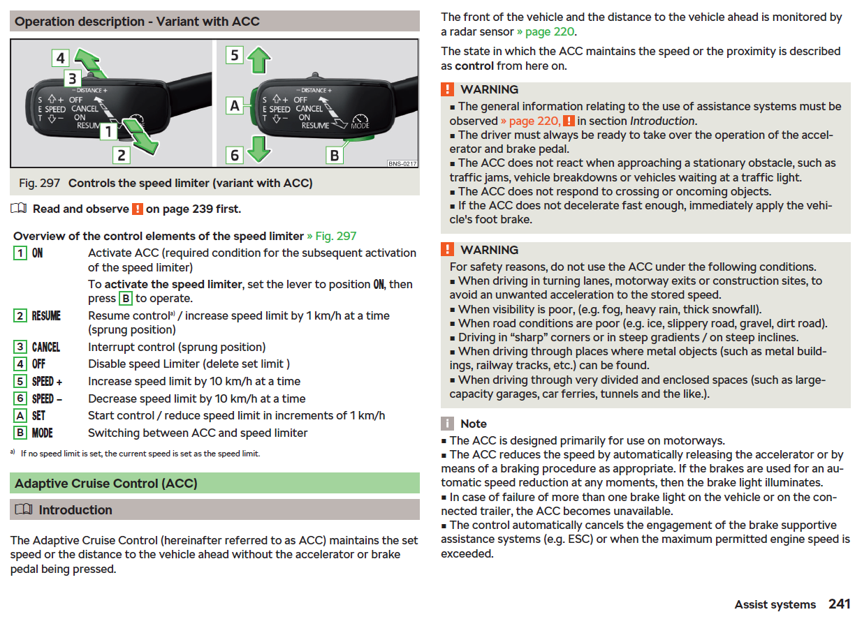

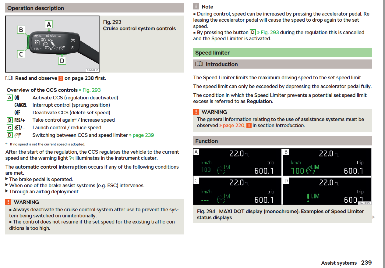

It can also look like these shots below dependent upon variant ACC or regular cruise.
This button was added for 2017 or 2018 models, not sure exactly of the year, but our 2016 model also doesn't have it.
