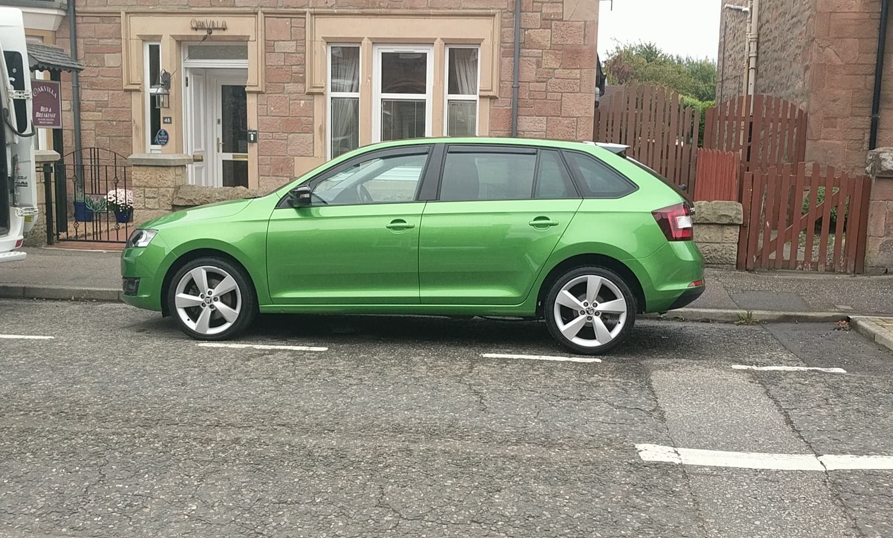

Coming off of this....

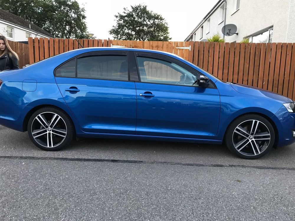

...And wanting to put them on to this...
I wouldn't bother with 2nd hand cheap springs. Go for Eibach or H&R or similar makes as they are very good quality and won't ruin the ride. I put H&R springs on my Superb and have been very happy. I've had Eibach before and they were great as well.
I would be checking that the springs (especially the rears) are compatible with swapping from the Rapid saloon to Spaceback.
Or even the fronts. Is the 16V donkey heavier than the older 8V 1.2 in that blue Sport hatchback?
The previous 1.4 16V was heavier and needed the same spring rates as the 1.6TDI (which is well heavy).
I would go to eibach online and buy the 30/30 drop for your exact model.
The H&R website doesn't differentiate between the Rapid models which makes me suspicious of using them.
@Stormchaser on here had a 1.2 fitted with the wrong springs (by his Skoda dealer), gave it a nose up attitude and dodgy high speed handling.
And look in "Rapid Projects" on here for cars that have been done.
Edited by camelspyyder
Yep, I echo the statements above...
a few people got the wrong sprigs from skoda.
eibach differentiate for model :) easy to use website to.
I’d save up and get the right ones.
they look so much better with a 30mm drop.
Cheers for the advice folks... Ive took all you've said on board and told the other guy im not interested, eibach have had good reviews from what ive seen and will be looking to get from them hopefully in the near future. Will keep you posted
