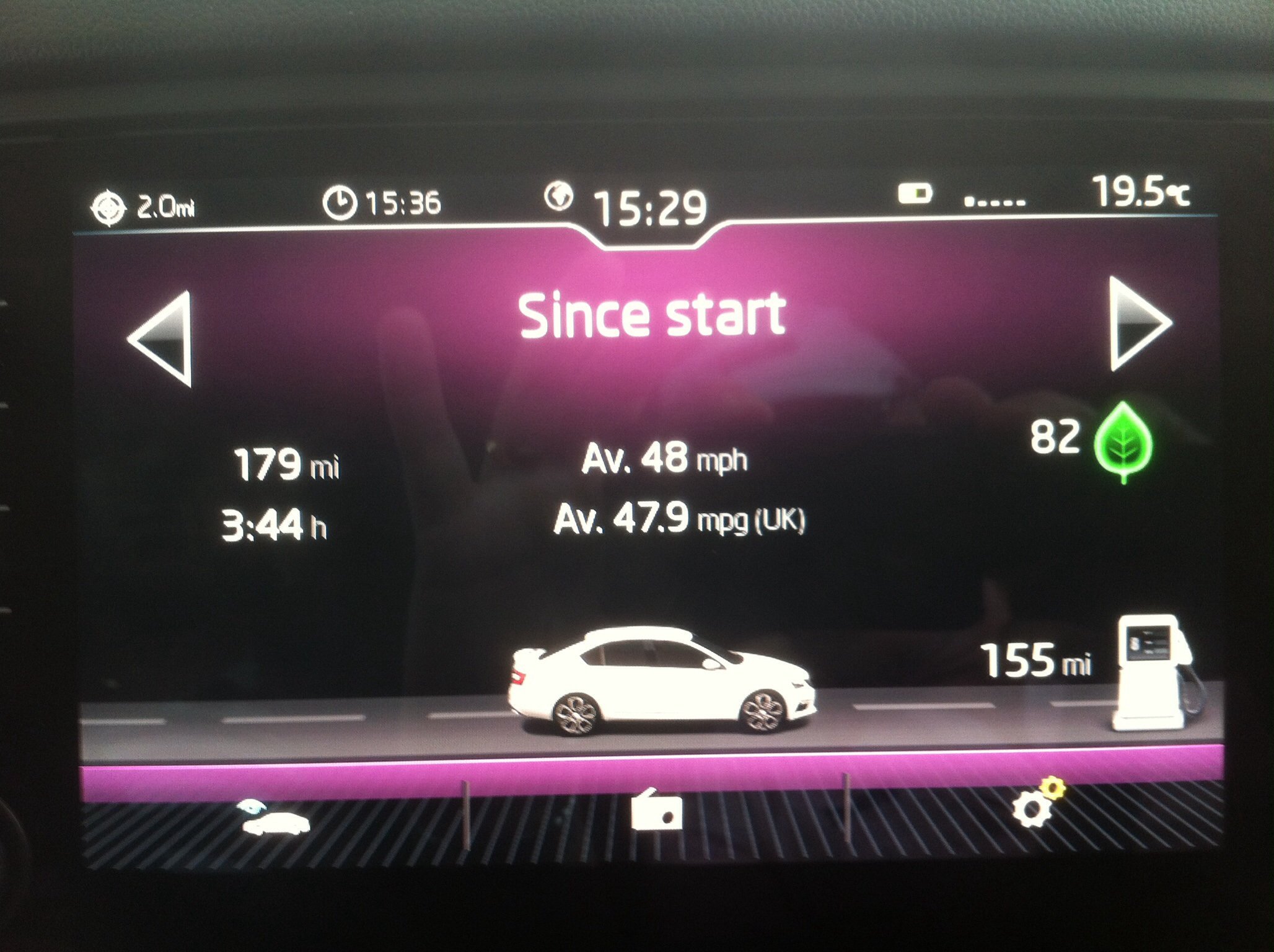

Recent example on our return from Sandown on the Isle of Wight. Not bad for a 300bhp car!:angel:
Just shows that a 1.6 petrol with not much power and a automatic pre DSG & totally practical can do pretty good economy as a commuter.
Especially  if compared to 1.0 & 1.5 TSI's even the latest with Cylinder deactivation.
