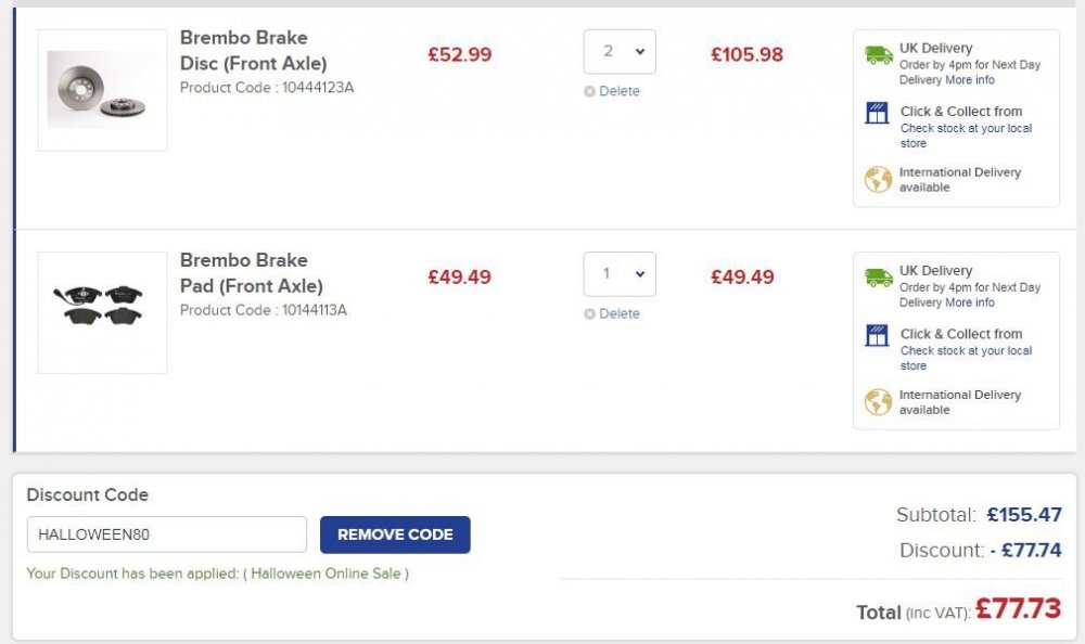

Either way I'm going to change them myself next week. Any suggestions on a good brand of discs and pads?
There isn't a TPS near me in York so I'm looking at a local motor factors, genuine Skoda (local dealer) or an online order via eurocarparts.
I wouldn't normally consider buying genuine parts from a dealer, but I was curious to see if they end up being much more expensive than elsewhere.
Time to do some ringing around.

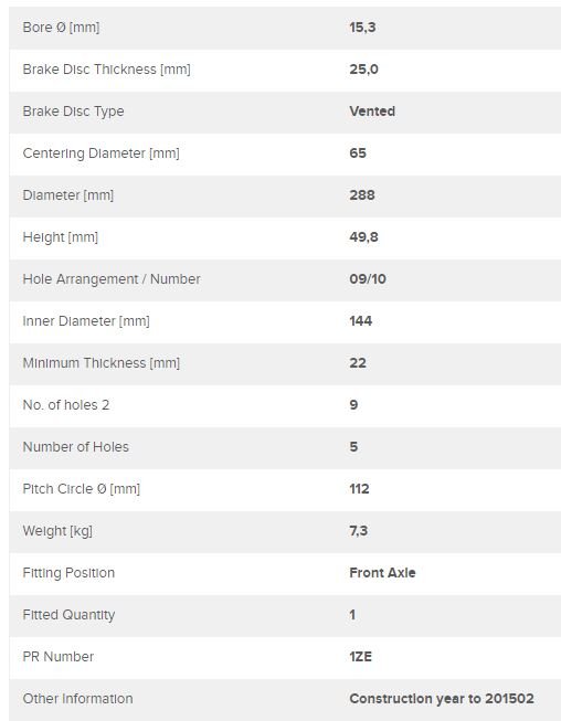

Looks like I'm going to have to do some measuring, quite a few sizes for my car (2011 Superb CR140 Twindoor).
These eurocarparts prices are assuming a 288mm disc...
