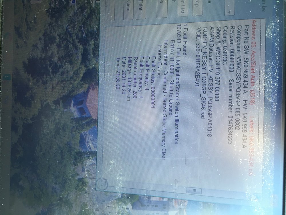

Kessy Related Warning VCDS
I saw this on my Superb with keyless entry, should I be concerned?
Bulb for Ignition starter switch ?
If you clear the fault, does it come back immediately (or after starting the engine)? If it does not, probably something intermittent.
