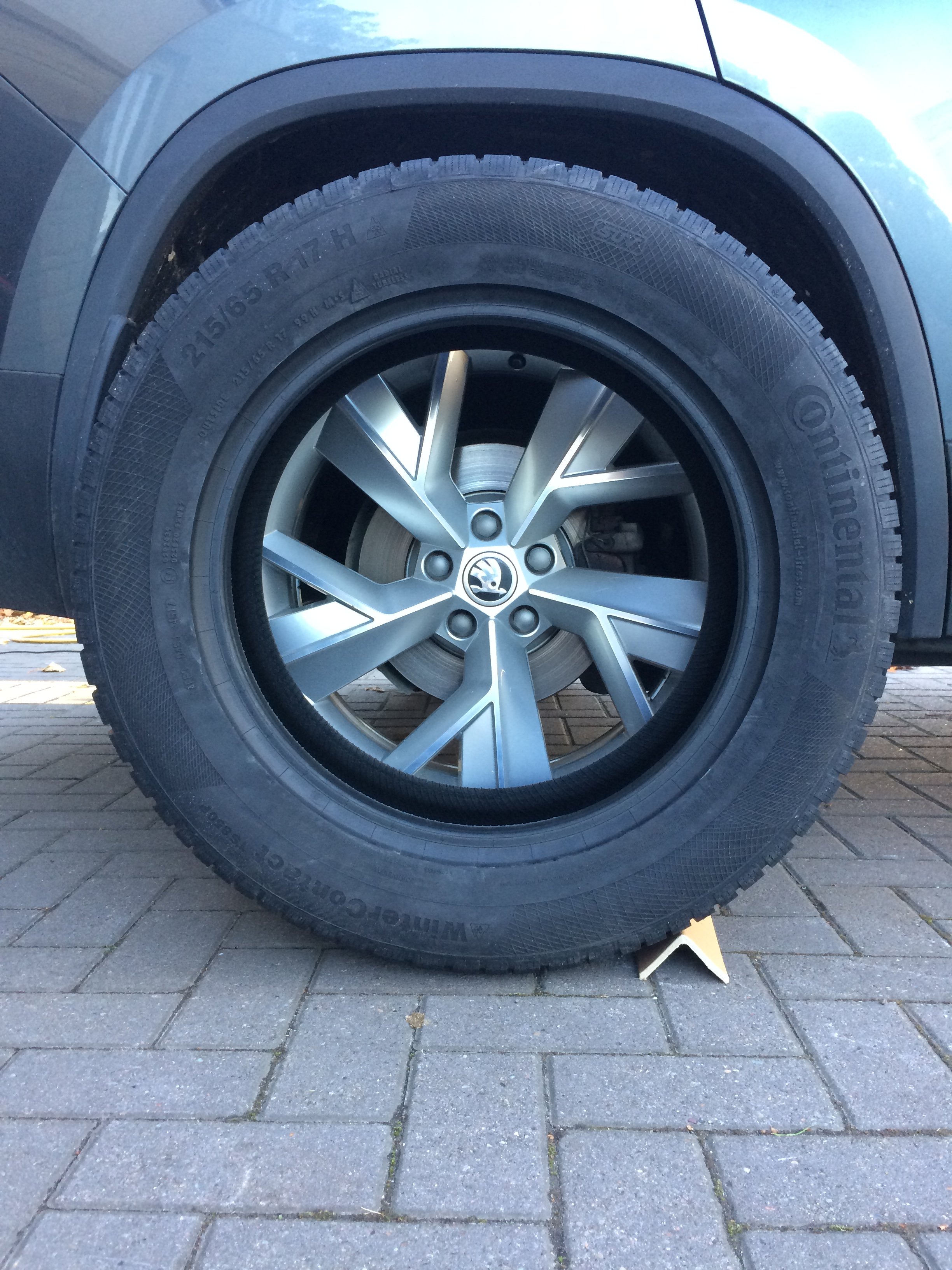

  • I fitted my 17” winter wheels a few weeks ago. Not much clearance with the 340 mm discs.

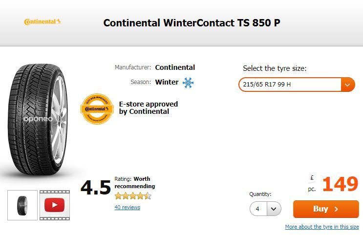

Going for this.
Should last 3 or 4 winter on more than one vehicle.
Our Sportline will be getting Nokian Hakka R2 or 3 on OEM Skoda Crater in 7x19.
In my opinion only premium winter tyres is good enough for a Norwegian winter, but anywhere with snow and ice I would never use all season tyres
£176 x 4 = £704
£149 x 4 = £596
TOTAL = £1,300
Plus fitting.
I get the fact that whilst the winters are fitted the summers aren't wearing, but that is quite an upfront investment...

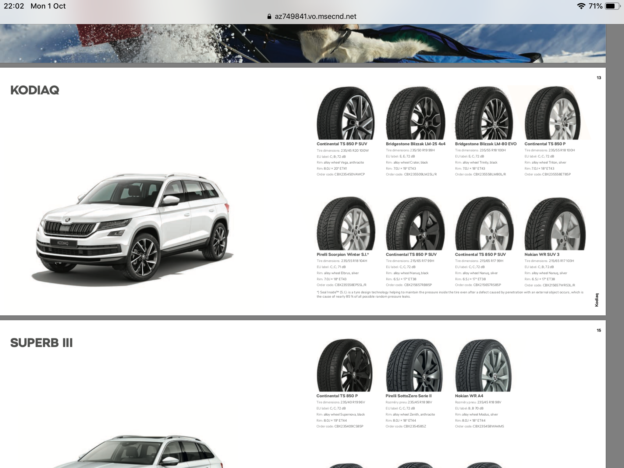

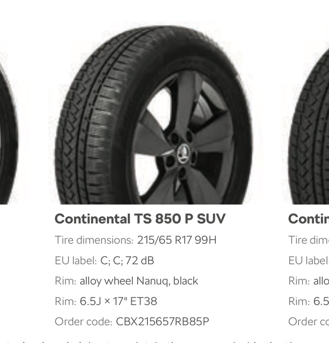

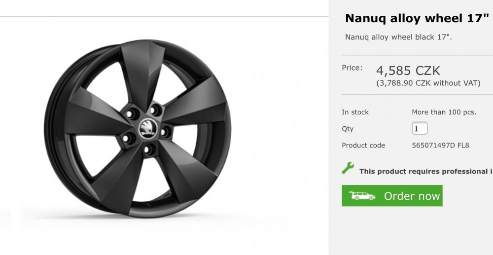

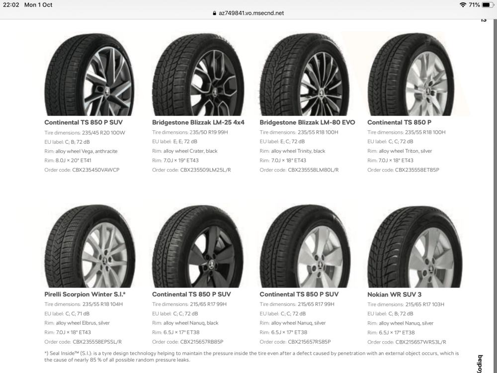

My Nanuqs are coming from my nearest dealer. Cheaper than Superskoda at 899€ +PP IIRC
Wheels and tyres are coming slightly cheaper than suggested above.

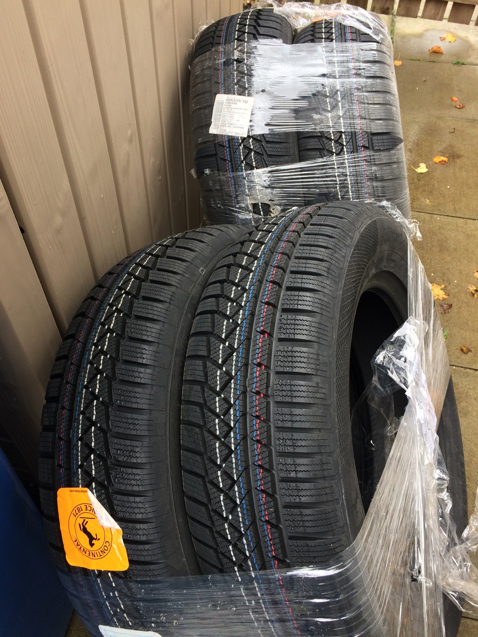

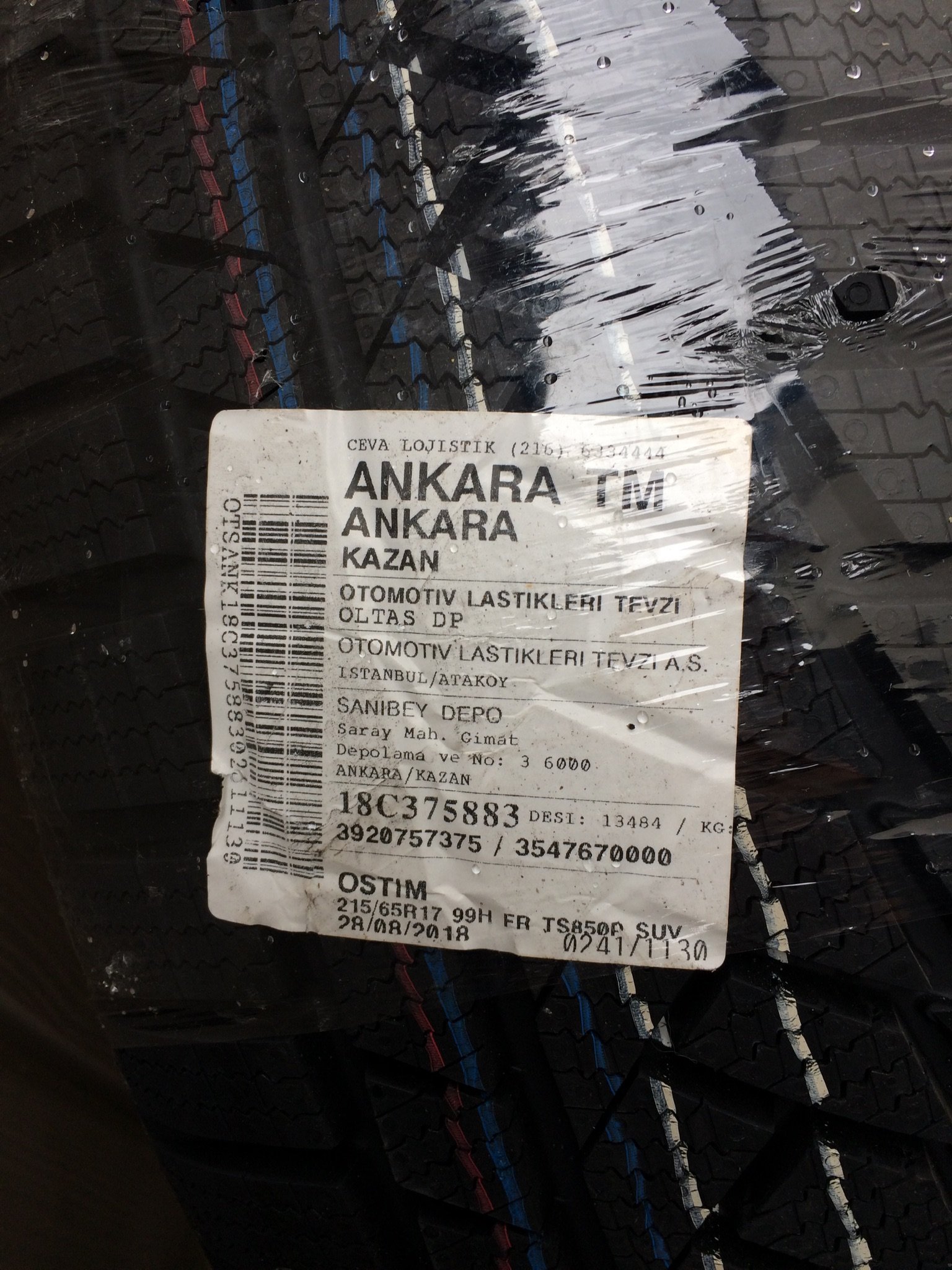

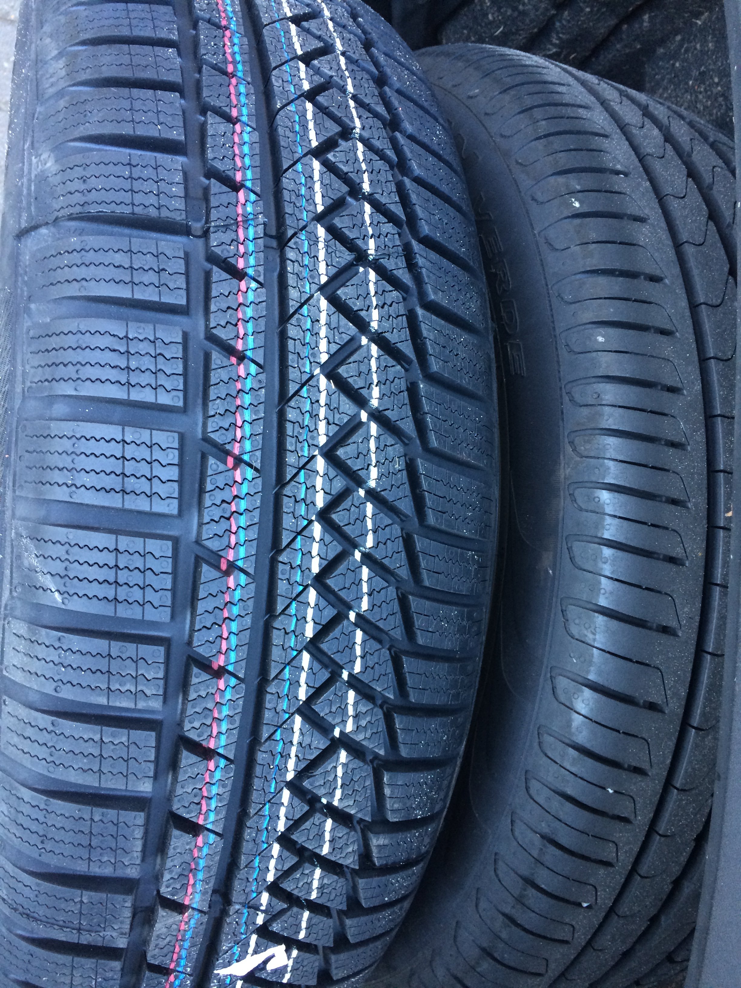

Tyres arrived promptly. Well travelled. Date stamped 2017.
Wheels must be coming to dealer from a far off land (in 2 weeks).
Must point out to tyre fitter crew that the tyres do have an “Outside”.
Once upon a time a dealer gave me a set of 4 RH wheels :-)
Date stamped 2017? What month is on the DOT code?
Even if they're late 2017 they are almost a year old, worst case scenario nearly two years old.
Given that winter tyres only spend (on average) half a year on the car, and winters tyre being more susceptible to drying out and cracking whilst in storage I'd be asking for some new ones?
When you're paying a premium price for premium branded tyres it isn't unreasonable to want them to less than 6 months old.
I had an issue with some Nokian winter tyres that failed prematurely, they were only a few years old...

I don’t think the Continental Winter Contacts have a right and a left. They have an “Outside” because the tread is asymmetrical. If you stand them up as they would be on the car does it look they have a right and left or does the tread go in the opposite direction on one side?
You’re correct of course. They are marked “Outside” as I said, not “Directional” like many performance tyres.
My previous dealer experience example was simply that the dealer got 2 of the tyres on the wrong way round.
I'v got exact same tyres...we'll see how they can handle a winter. Last winter was joke...rain and water. Dealer took them off last season and didn't write which tyre is which. So I measured the depth of tyre tread and look carefully which way the tread was worn. Cleaned everything ...even waxed the wheels with Bilberry angelwax and no eady for winter:)
