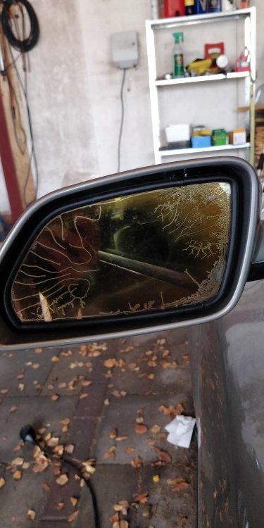

What happened to my side view mirror? Octavia 07.
Hey!
I wonder what's happened to my mirror? How do I replace it? I just pry it from one side to get it out?
Also, how do I check what type of mirror it is? I know its heated, but I dont know if its reducing the lights coming from traffic when its dark, (dont know the word for it).
Are they expensive to buy new?

The photochromic ones have a blue tint to them.
Did is some sort of solvent get on the mirror? Looks odd.

I don't know anything about it really. I just bought the car, now it's my problem to take care of it :biggrin: I might try to peel a layer off, maybe it's a aftermarket film of something on it. The right one looks perfect! This one has a yellowish tint to it.

Looks like the protective film was not removed!

I've just done a bit of googling, and it seems that this is caused by the auto dimming function in the side mirror. It's some kind of liquid embedded in the glass, and when that starts to degrade/leak out this is what happens. So I'll just buy a new without auto dimming function :)
Dimming glass is expensive are you sure it is dimming my elegance has normal heated mirrors
Thats definately a dimming mirror, you can tell by the fact the mirror glass has a rubber seal round it. Nice and pricey if you want a direct replacement :crying:

Yeah I was shocked over the price difference! Normal ones for £20, and the dimming ones for £250 :biggrin: I won't bother with dimming ones.
