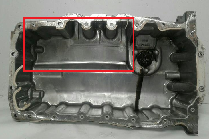

If there is anything specific you can tell from that, then please do let me know. I've had the car sat on flat ground whilst doing the oil changes.
Browsing a few images of the sump via ebay and the part number that I could find via your engine code, it looks like there's a significant 'pocket' at the rear of the sump that's deeper than the front half. If the engine also leans at a bit of a backward angle in the bay, this would probably explain where the missing oil was hiding.
Like the Fabia engine I referred to earlier, to extract most on this car, it looks like quite a steep nose-down attitude will maximise extraction via the dipstick tube.
Another good illustrative photo in this listing https://www.ebay.co.uk/itm/VW-AUDI-SEAT-SKODA-1-6-2-0-TDI-DIESEL-OIL-SUMP-WITH-SENSOR-2009-2013-03G103603AD/153153153874?hash=item23a8a3ab52:g:VpkAAOSwik9bgUVG:rk:4:pf:0
That's a great bit of detective work - I wouldn't have known what I was looking for / at. That you.
Next oil change I shall try getting the rear of the vehicle up as high as I can. Would the usual home mechanic ramps be high enough do you think?
