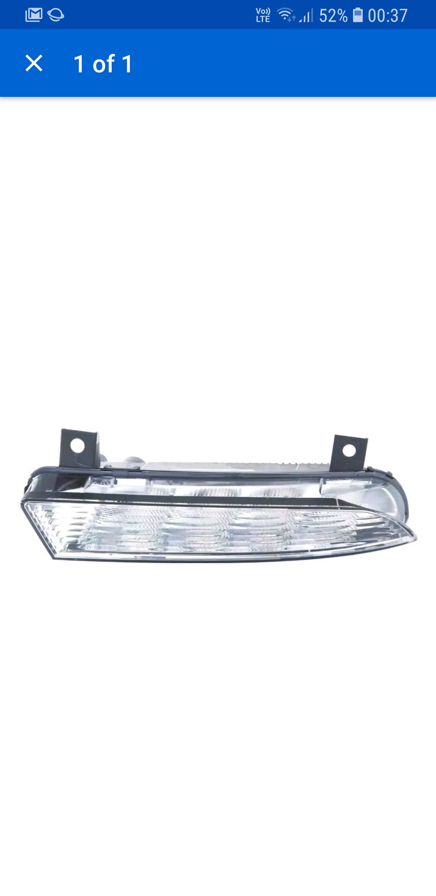

Hi so one of my drl stopped working and and ordered a brand new one off ebay from a trusted seller and today i installed it by my self but no luck it still wont work so what could be the problem? Do these need coding ?
First thing to do is to take the bulb out and test it by putting it across a 12 V supply to see if it lights. Could be it was dead on arrival.
If it worked put it back and try again. There is no coding required but when you switch on the ignition the car performs a bulb test. If it finds a faulty bulb it will remove the supply to it until you next turn on the ignition.

It is this drl led also works as parking light. I will do the 12v test but if the bulb passes it then what else could be the issue? Got mot in 2 days
Try the new one (and your old one) on the other side, you will then know if the issue is with the wiring or BCM
Wish i could because on the other side there is a washer bottle blocking the connector
Just noticed yours is a Vrs.  My answers apply if you have factory fitted bulbs rather than LEDs, and uses the side lights as parking lights.
