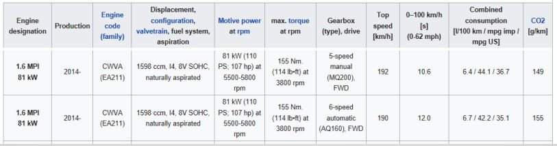

With your engine and transmission option I'm assuming you are in Egypt.
According to a Wikipedia table you would need a tailwind or a slight downhill to achieve a true 200kph.
The speedometer display is usually optimistic by up to 10% so your friends may only be doing 180kph unless their claims were verified with a GPS.
Check you own speedo accuracy with a GPS. At least it will quantify the problem, if any, and cheaper than putting your car on a rolling road which would be of little value unless one of your friend's 'good' car is also tested for comparative purposes.
Edited by Gerrycan
Thanks for this table. Actually one of my friends took a photo for his car with that speed. Whatever I don’t need 200 km/h but at least be able to get 170 km /h to check that there is nothing wrong with my car
thanks for your help
