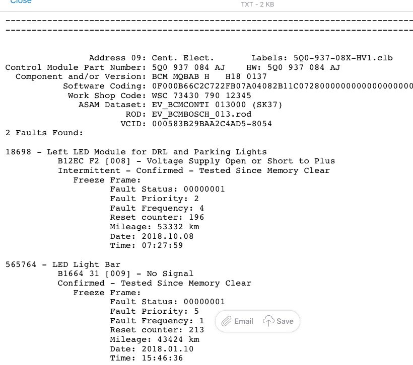

I feel the OP's pain, I hope the MOT info is correct. My left hand DRL bulb alerts is showing intermittently as failed with the  headlights on. If I set the DRL to 'Off', both DRL illuminate only with the headlights on and don't throw up a fault. I think it's the power/control unit, as the DRL work faultlessly wiithout the headlights illuminated. I have copied the VCDS log which shows the LED light bar and LED  module throwing up voltage open or short. If any reader knows where the power/control module is located, I'd be grateful to them.
The LED DRL Control Module is a good shout actually, forgot there was an external controller for it. See this thread for more info on location and part:

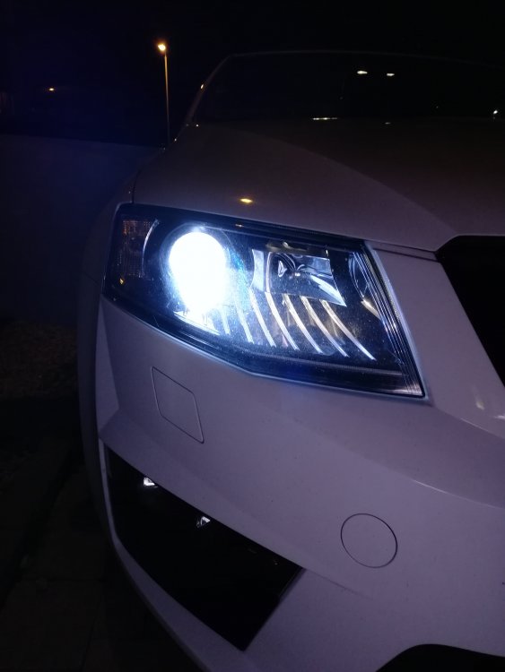

If you have LED DRLs with halogen headlights, isn't there still an H15 dual filament bulb fitted which it uses for the sidelights? In which case I think you could probably configure the car to use the H15 for DRLs instead of the LEDs using some CAN fiddling.
Edit: just seen the photo. Can't do this with xenons.
Edited by Rodge
Just now, CHJG said:
Thanks for all of the replies - as you can see, the LED light is out. When it first happened, the light would flicker and then turn off. Next day it may have worked for 5 mins then knocked off. Now, it is permanently off.
Unfortunately, when headlights are on the DRL are on, so it looks a bit daft with one on and one off! Looks like an expensive repair for such a minor issue!!
