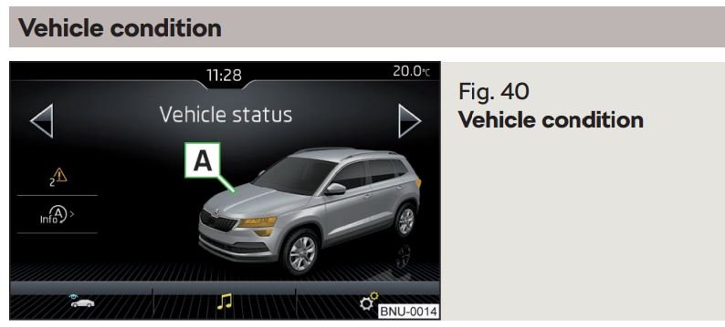

If it happens again remember to check the vehicle status...

silver1011: Next time I wont panic. I will indeed check the vehicle status and get some photos.
