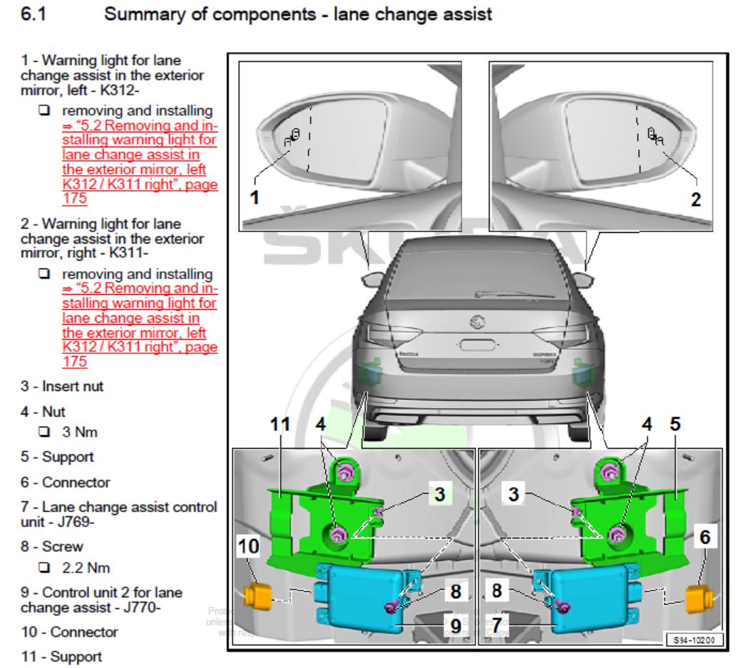

On 16/11/2018 at 23:43, JR RS said:
5b054ed4a033d_SummaryofComponents-LaneChangeAssist.thumb.JPG.6e76ac51b50d549770cfcfc527afcc14.JPG
Had this problem flag up on the M6 yesterday evening.  We were up near Penrith and the weather was grim so I assumed it must be some water ingress.  However, still no joy.  Looking at hte image above, are the control units in the rear bumper?  Or do we think they're mounted towards the front of the rear arches, perhaps behind the arch liners?

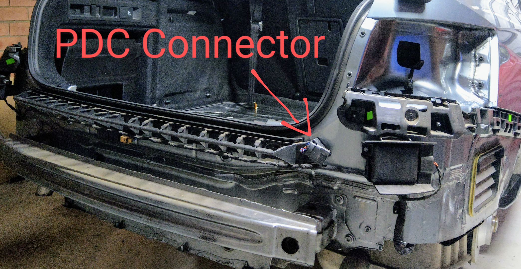

No, they r not behind the wheel arch liners.
They r directly below each tail light, inside the rear bumper.
just ignore the text in the image.
1123414419_Screenshot_20230423-1001282.thumb.png.0cb4a82ab9462748cd7787304a4b7c54.png
Ta for that.  Nice and handy location 😂  Maybe I'll leave it for the garage to look into first to see if it's throwing any error codes.
