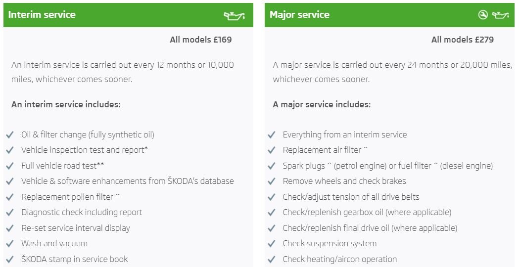

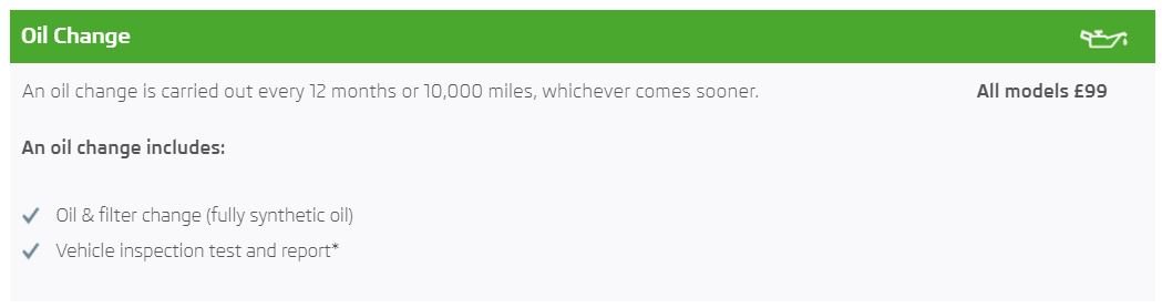

Service Schedule - Item List of things to do
I'm not quite sure why someone would complain at a £139 main dealer first service being overly expensive.
Assuming it's an oil and filter change plus the usual bits (diagnostics check, visual check and wash and vac) then it's very reasonable in my opinion.
If your car is collected and dropped off, you used their Wi-Fi, or drank their coffee, watched their TV, read their newspaper, put miles on their courtesy car etc. then I'd be hard pressed to arrive at a figure that would seem better value.
'Skoda UK' insist nothing, it is just in the T&C's,
they have a Website and an offer from Participating Dealers and some participate and some do not and some are cheaper and some are more expensive and Rod McLeod or some other Skoda UK Management if asked likely have not a clue and need to look see what the website says.
Whilst Skoda UK do not insist that dealers offer these prices, they do insist, by the very fact it is mentioned in their terms and conditions, that your car must be three years old or older.
But, as mentioned, in the same way some dealers won't offer these prices, my dealer will, and also on cars less than three years old.
So my advice would be if your chosen dealer won't honour these prices, or apply them to cars less than 3 years old, then find a better dealer.
