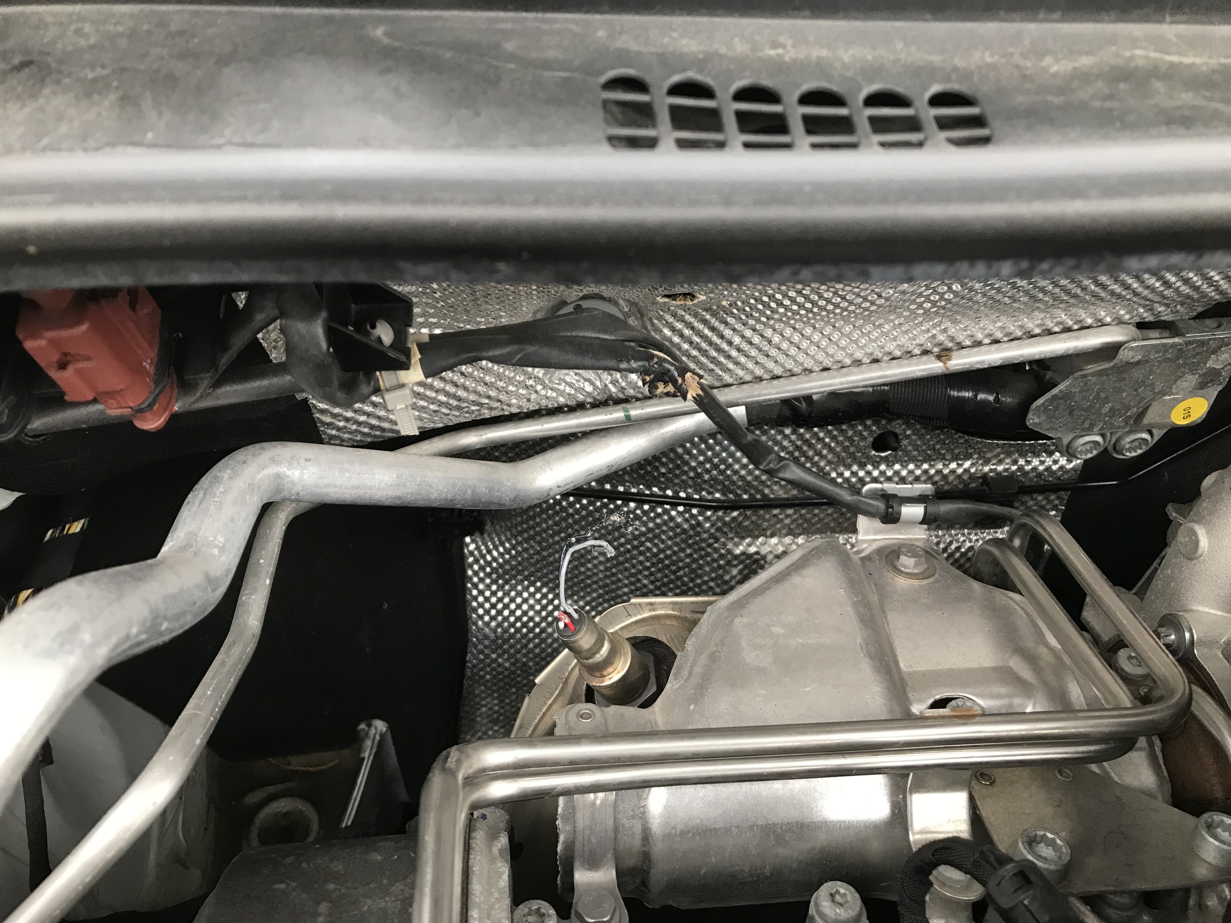

Hey all,
So the engine light came on whilst leaving the house today.
i popped the bonnet after arriving at the shopping centre and it appears a rodent has chewed through one of the cables (photo attached). Does anybody know the purpose of this cable?
Cheers

Hi - I'm back home now. It was -3 when I took the photo and made the post, so sorry for the lack of info.
Our car is a 2016 Fabia, 1.2tsi.
I believe the chewed cable connects to the EGR.
Thanks!
Lambda sensor, you will need to buy a new one I'd think and it will come with all the cable form so you just need to unplug the old cable. B1 S1.

Looks like an oxygen sensor to me.

You're right, it's definitely a lambda sensor.
I live in the Czech Republic, and during the harsh cold snaps small animals like to seek refuge in warm engines. Weasels are particularly problematic as they love to gnaw on cables:
