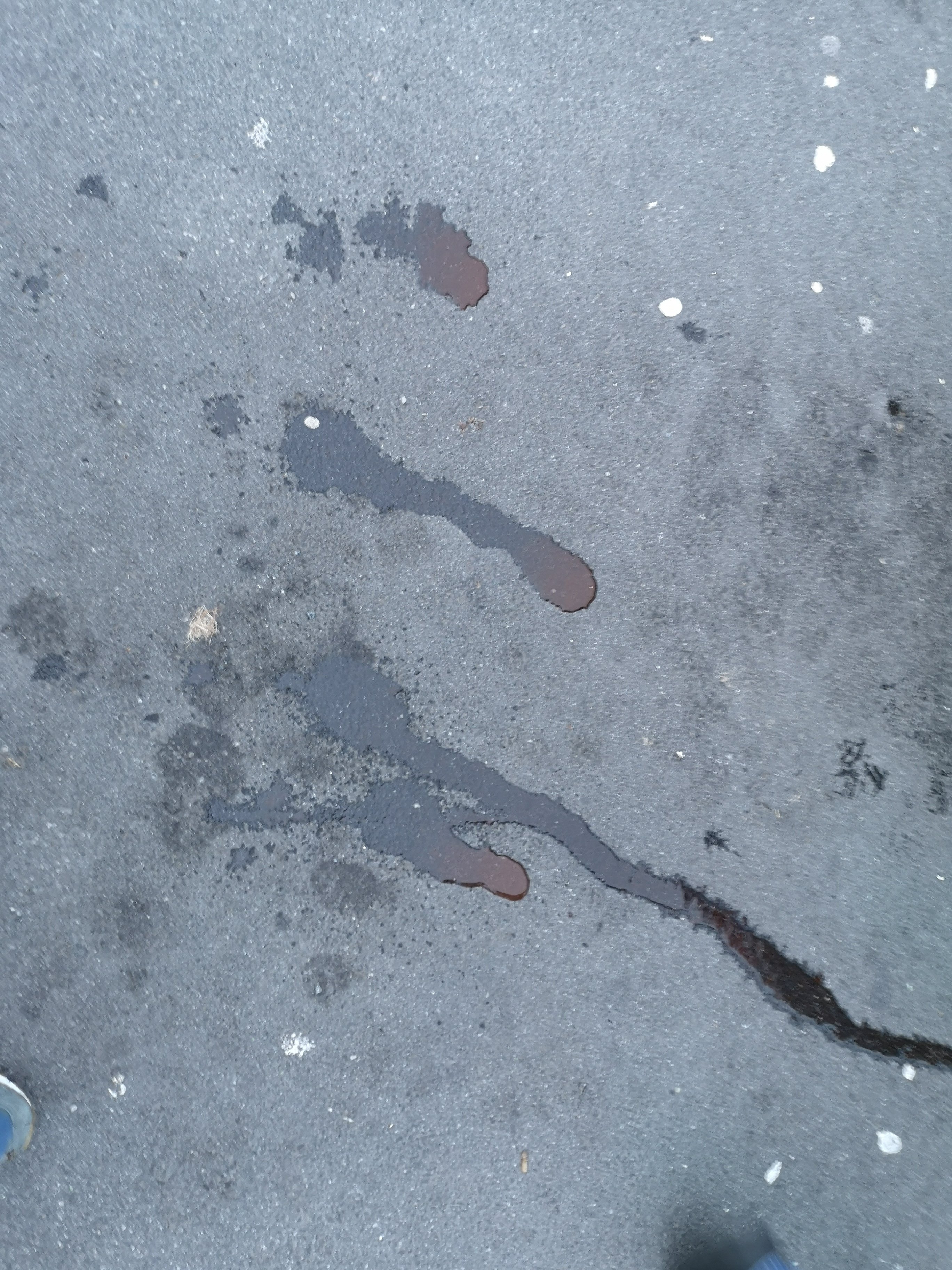

Earlier today, I drove about 35 miles. Mostly on the motorway at 70. I stopped for 1hr and 40 mins. I then drove back home but after about 25 miles, the coolant warning light came on. When I stopped, I put water in but I could visible see it going down from between min and max, to empty. I looked under the car and it was leaking straight back out. I will attach a picture because it looked like it was coming from more than one place (unless dripping along?)
It was mentioned above that it might only leak when warm.
Thanks for the help :)
The biggest patch is from below the coolant tank.
If you’ve got an actual leak a garage should be able to find out where from. Now it’s visibly leaking they should easily trace it. I’d be inclined to use a VW group specialist garage who will be aware of the water pump and coolant tank silicone issues.

Just been out to it and as I poured the water in, I could visible see some of it dripping out the bottom. The car hasn't been started today. Not sure if the water is running down something and going across but to the right of the coolant tank, at the bottom of the car, I could see a build up of the water.
Get it booked in ASAP.
If water is now visibly running from underneath the car then take it back to the garage that did the pressure test and ask them how they managed to miss the leak the first time.
Just lifted the coolant tank out slightly and it's very wet around the hose on the bottom of the coolant tank. It also looked like some of the silicon around it has gone.

Seems like a rubbish garage if they can't even find and fix what appears to be a simple coolant leak.
Yep. I won't be going back. I'll pop into my local Skoda garage and get it booked in. The car doesn't appear to hold any water now. Just floods straight out.
