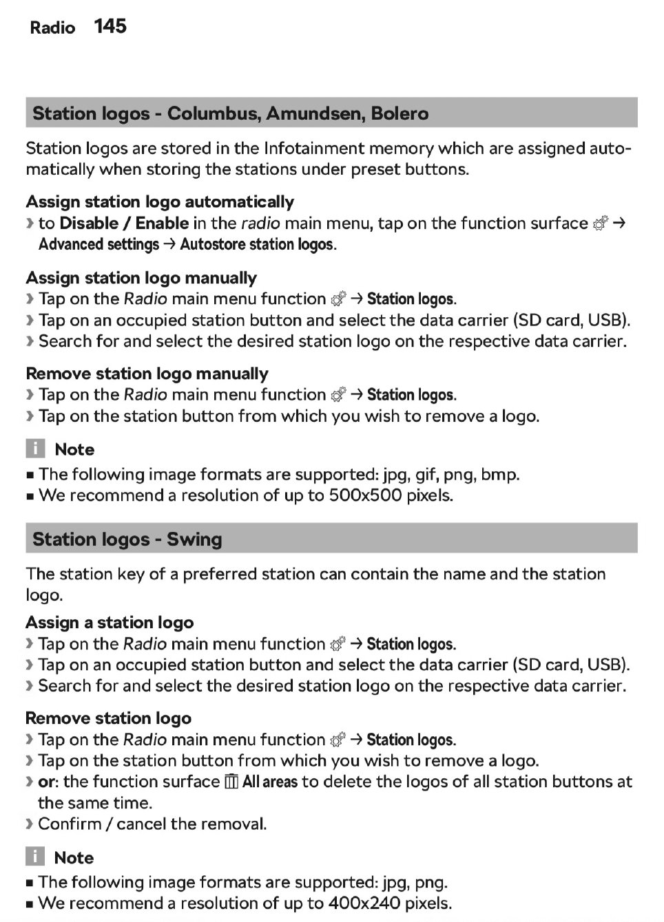

I am afraid its not working for me.Inserted usb stick containing a folder of icons and went to “ manage stations logos” Then faced with a list which says.Usb,sdcard2 and one other option which I cannot remember.All greyed out and cannot go further.Also put the logo folder onto the same sd card as the nav. Update but still no luck.

It could be that the jpg format is not within the recommended size - depending on which infotainment unit you have check these instructions from the Karoq manual.
Also, if you've formatted the USB stick to MS-DOS Fat32 using a Mac, make sure there are no Mac-specific invisible files on there that will confuse the system. If using Mac I suggest downloading the free Mac application CleanMyMac 2 which will remove any unnecessary Mac-specific invisible files from the USB card. Run the app after you've put the icons on there, and place all the separate icon images directly onto the USB stick instead of popping them all into a folder and THEN popping the folder onto the stick. Try the latter suggestion anyway even if you used a Windows computer to format the stick. And name the formatted USB stick UNTITLED in capital letters. Good luck!
