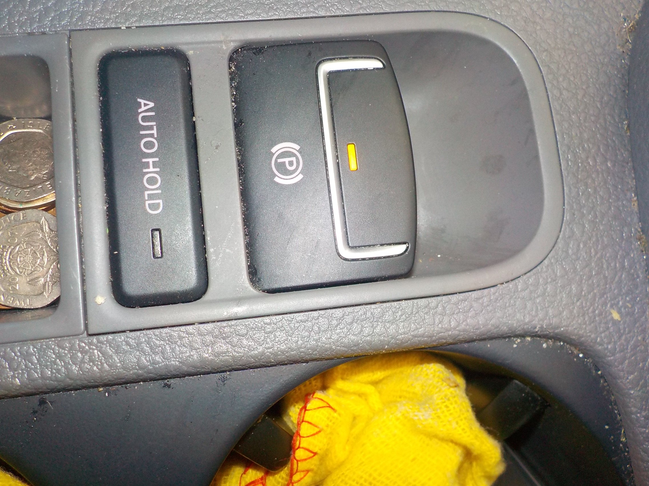

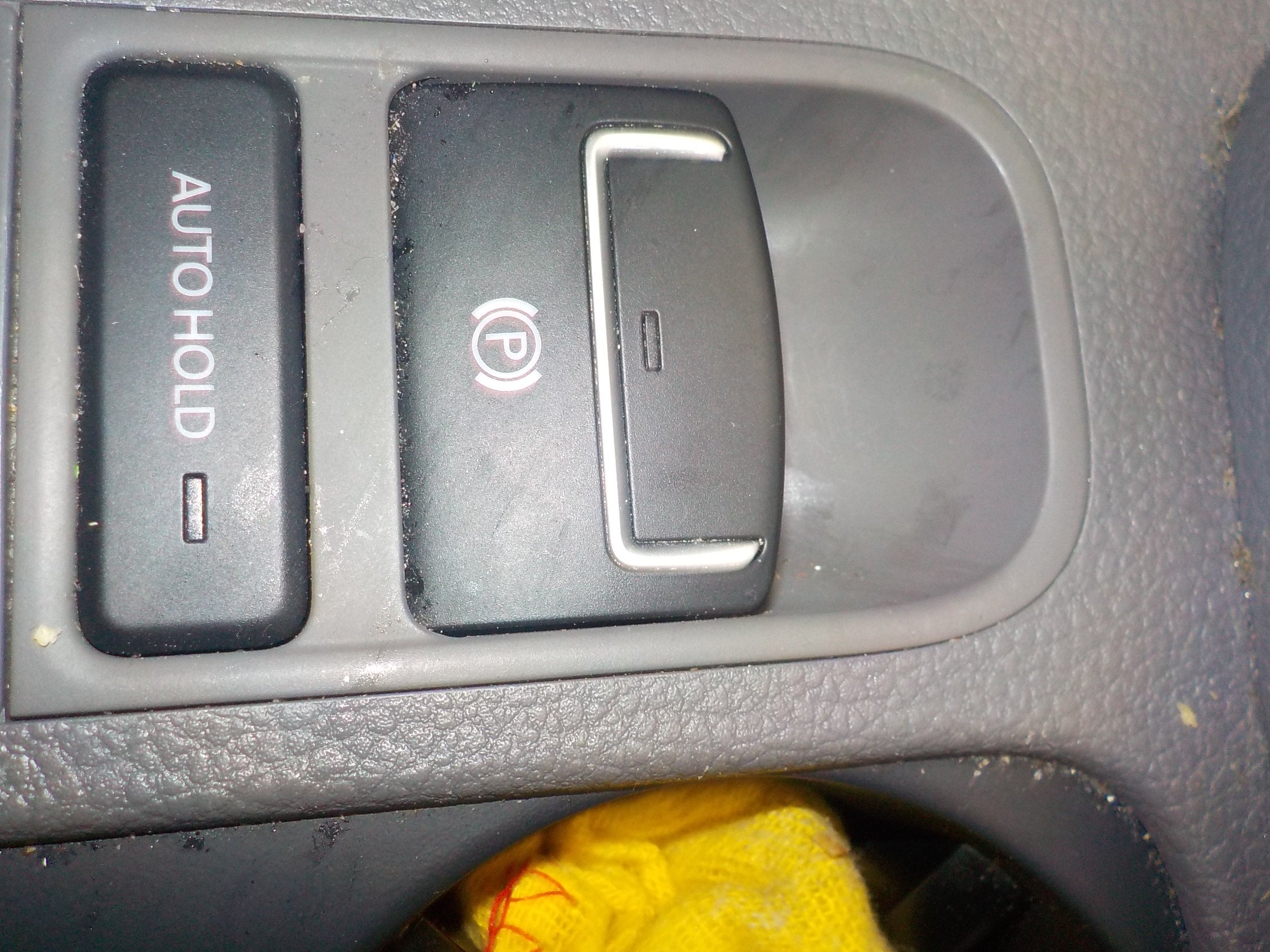

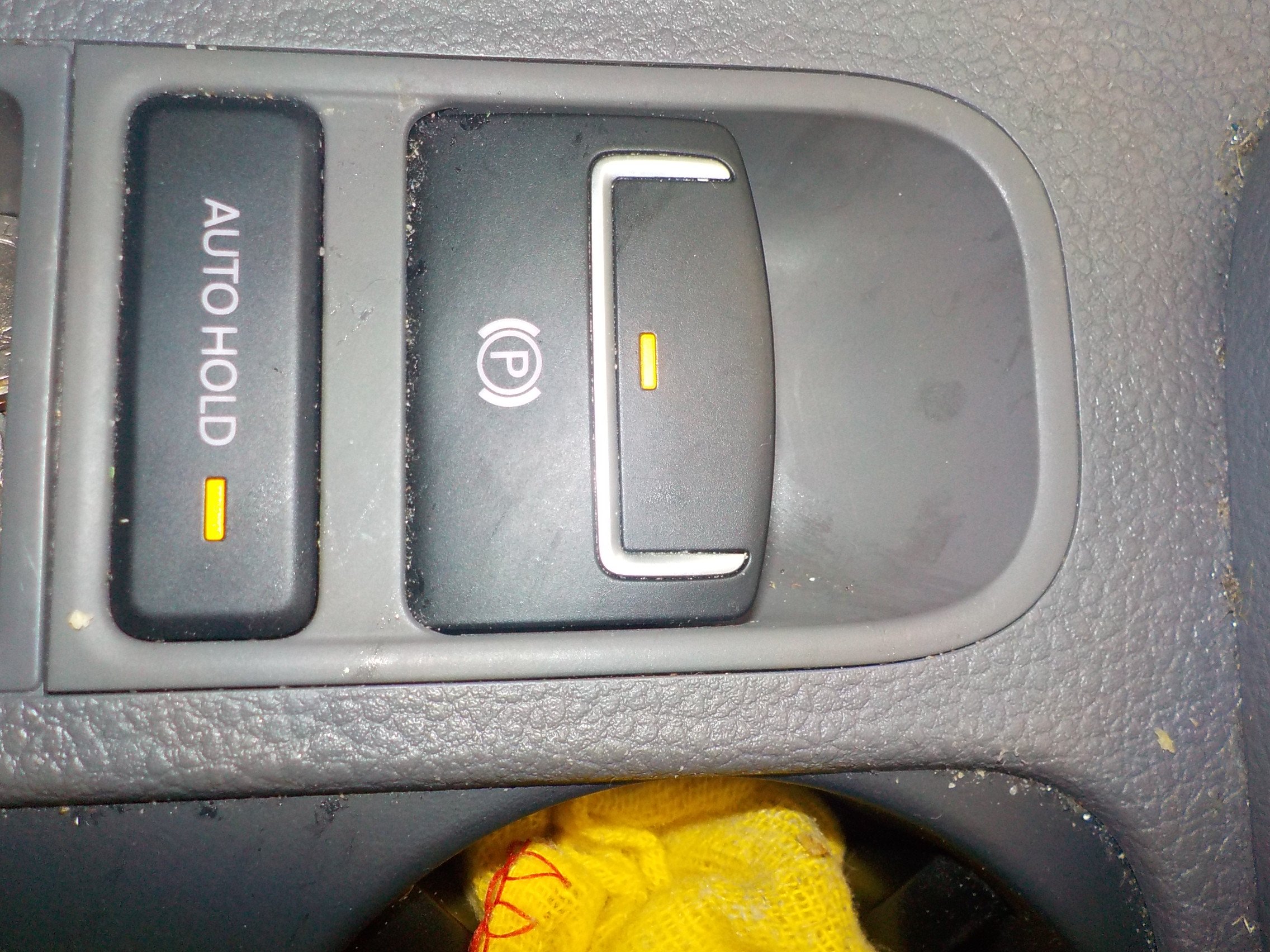

 There is a way @X man
 Switch off the engine. Turn the ignition back on. Put your foot on the brake pedal. Press the auto handbrake button down and the parking brake will release.
 I am also fortunate enough to have a garage for my car. I do this every time I leave it in order to avoid very problem about which other forum members complain.

After reading this earlier I have just been out in the car and checked what I posted yesterday is correct and it is. No need to go through all that, just turn off the auto handbrake and don't pull the handbrake button.
