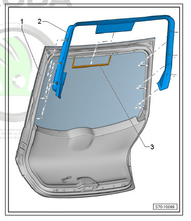

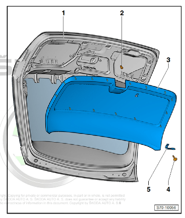

any tips on how to remove the trim in the top picture directly below the rear dashcam? (goes fill width across back window and halfway down at each side)  i need to tidy my install up and having this removed to help with wire placement would be useful. i can't work out where the clips are.....
you need to remove both bits of trim, the bottom bit holds the top in....
I got these from the Bodywork section in this post (page 382 in the publication or page 392 in the PDF, if that makes sense)
there's a pretty good answer and nice diagrams. you do need to remove the lower trim first. routing the cable i bought a second conduit and used that as i wanted to route the wiring along the drivers side.
