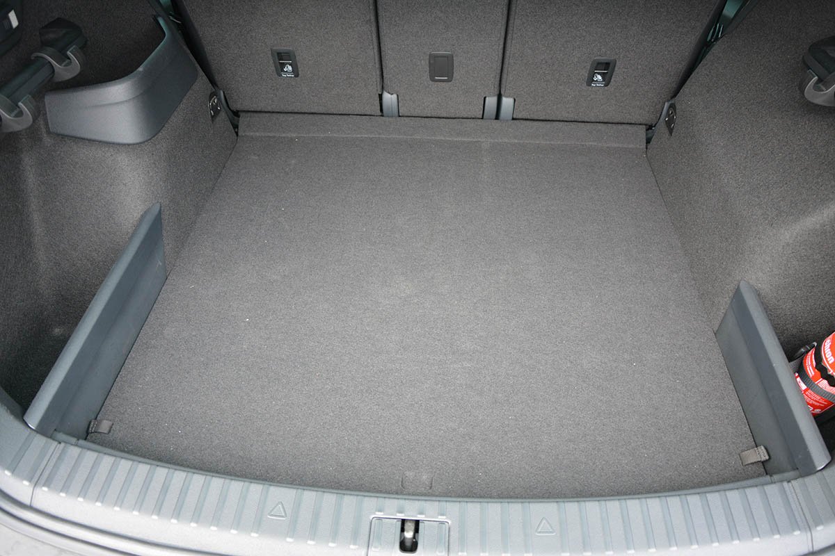

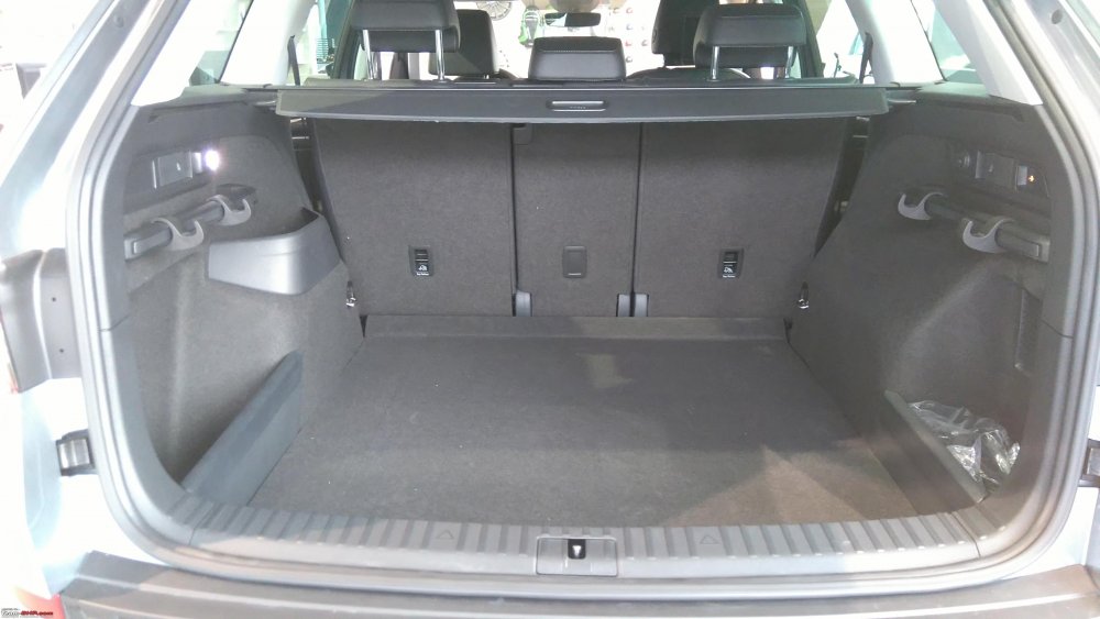

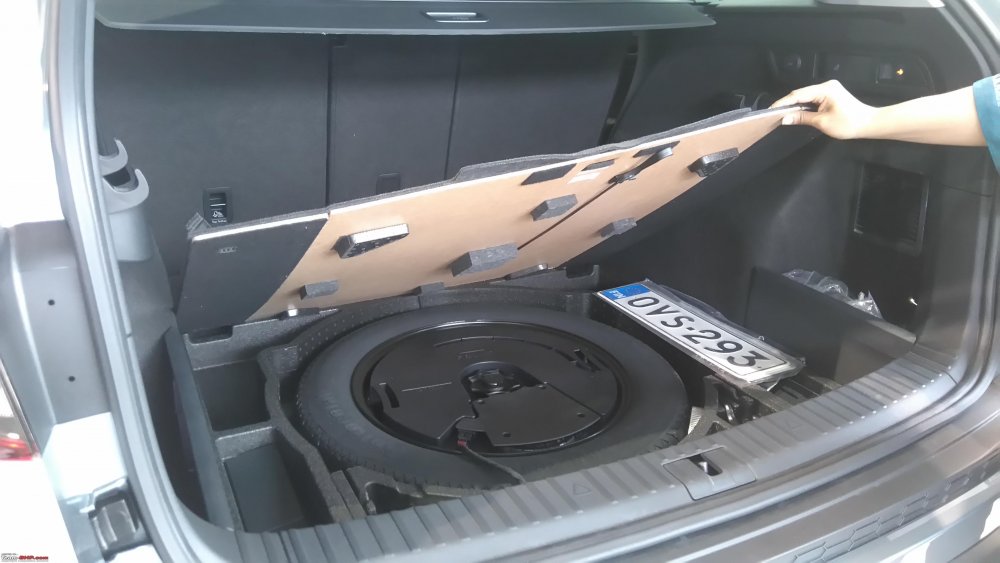

5-seater, standard boot floor with space saver spare wheel and Canton...

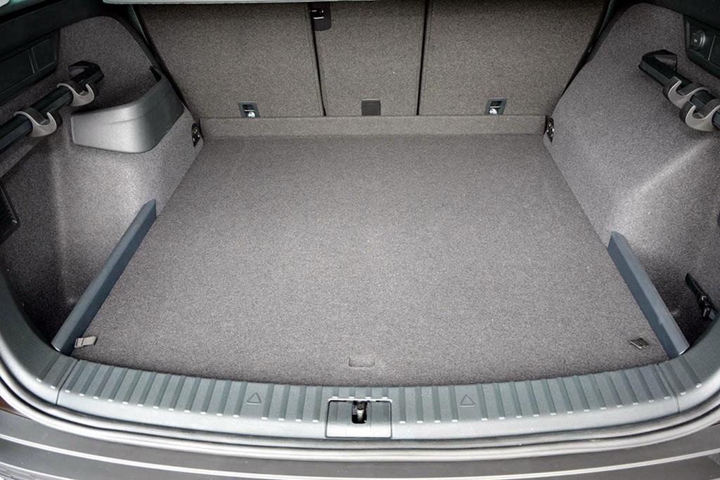

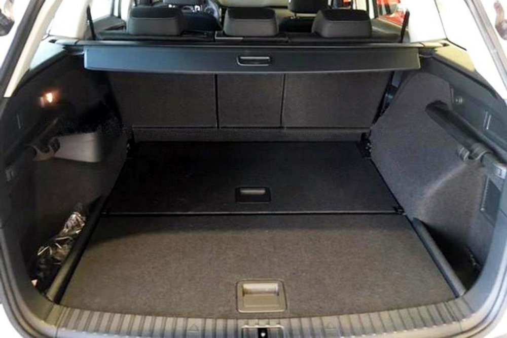

5-seater without the space saver spare wheel, but with the variable boot floor...
Version 1 - Solid Floor...
2077726622_193294Kodiaq5osbag6upperbootsparetyre.thumb.jpg.8f106f05c7af0b17f3726db11edcd5e6.jpg
Version 2 - Spilt Floor...
401239982_193294Kodiaq5osbag7upperbootwithvariablebootfloor.thumb.jpg.052d825a269c4fdda996a03492980377.jpg

Many thanks silver1011!
So looking at the first picture of the standard floor with a space-saver spare wheel, if you lift the floor up to access the spare wheel, do you have useful spaces around it to hold things like walking poles and boots, and picnic rugs??
Chris

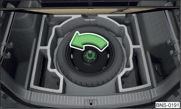

You may struggle with walking boots but I'd imagine you'd get quite a few small squashy things in those polystyrene compartments...
What you can't see is the jack, wheel brace, locking wheel nut key and tweezers etc. They're all between the boot lip and the spare wheel, just out of shot.
If you don't specify the factory fitted Canton sound system then the jack etc. all go inside the spare wheel (where the Canton subwoofer is now), thus freeing up all the space they're currently occupying.
My (dirty) 5 seater w/ spare wheel+canton boot. Don't think you can fit a walking stick (perhaps a very small telescopic one) but I've got some picnic rugs in there.
Many thanks all,
So it looks like the spare wheel is held in a polystyrene frame to secure it, which leaves little space around it... and the two panel variable boot floors have a divider across the boot which would prevent a spare wheel fitting under them.

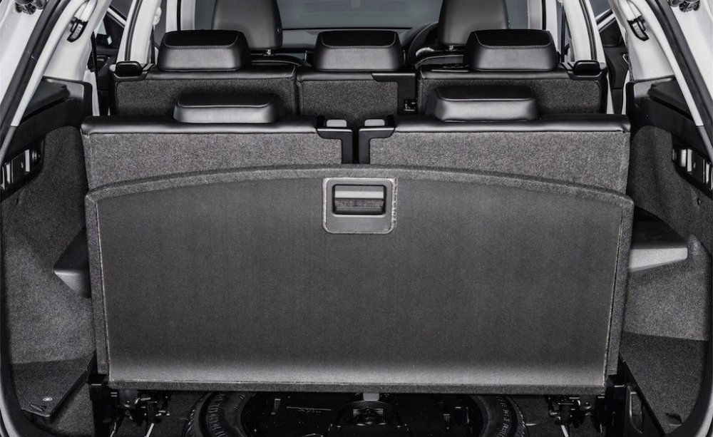

Have you looked at the boot of a 7 seater with spare wheel, I’m sure mine has more storage space under the floor than the picture above of the 5 seater.
The spare wheel in that picture of the 5-seater looks like it is right at the back of the boot. On the 7-seater, it’s further forward (under the third row of seats) and you get the space underneath the variable boot floor bit between the spare wheel and the boot lip.
I don't think it's that much further forward, not enough to generate much more space at least...

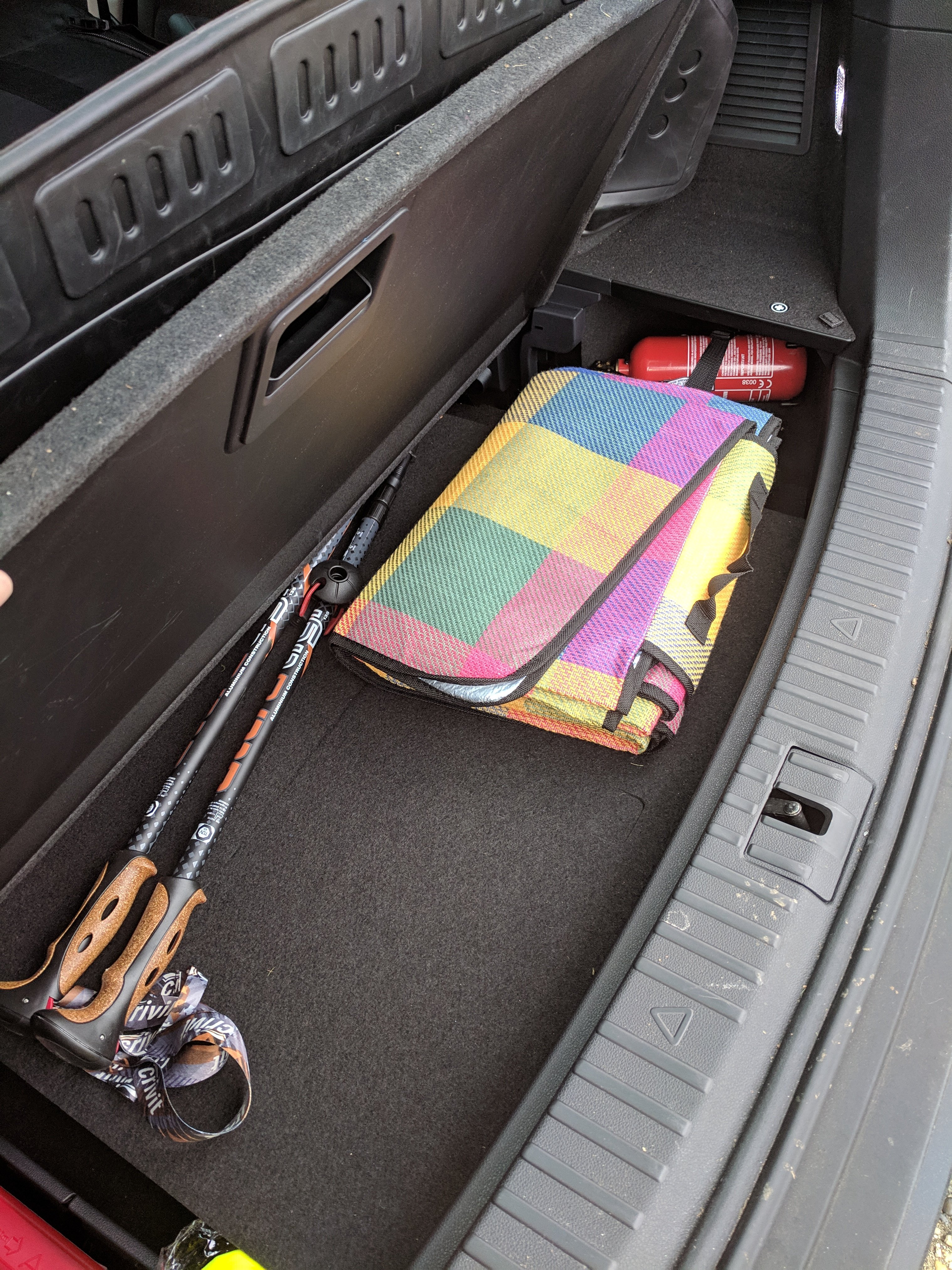

This is the space you get under the variable floor in a 7 seater...
There is a space saver spare under the lower floor.

Its about 20.5cm from the false floor to the real floor, but there is an additional depression for the wheel itself, so only half the width of the wheel is protruding above the rest of the floor. The carpet appears to extend under the seats.

So basically you would end up with a floor at the level in the first picture I posted (where the picnic blanket and walking poles are resting on it). That would be about 11 cm below the current level.

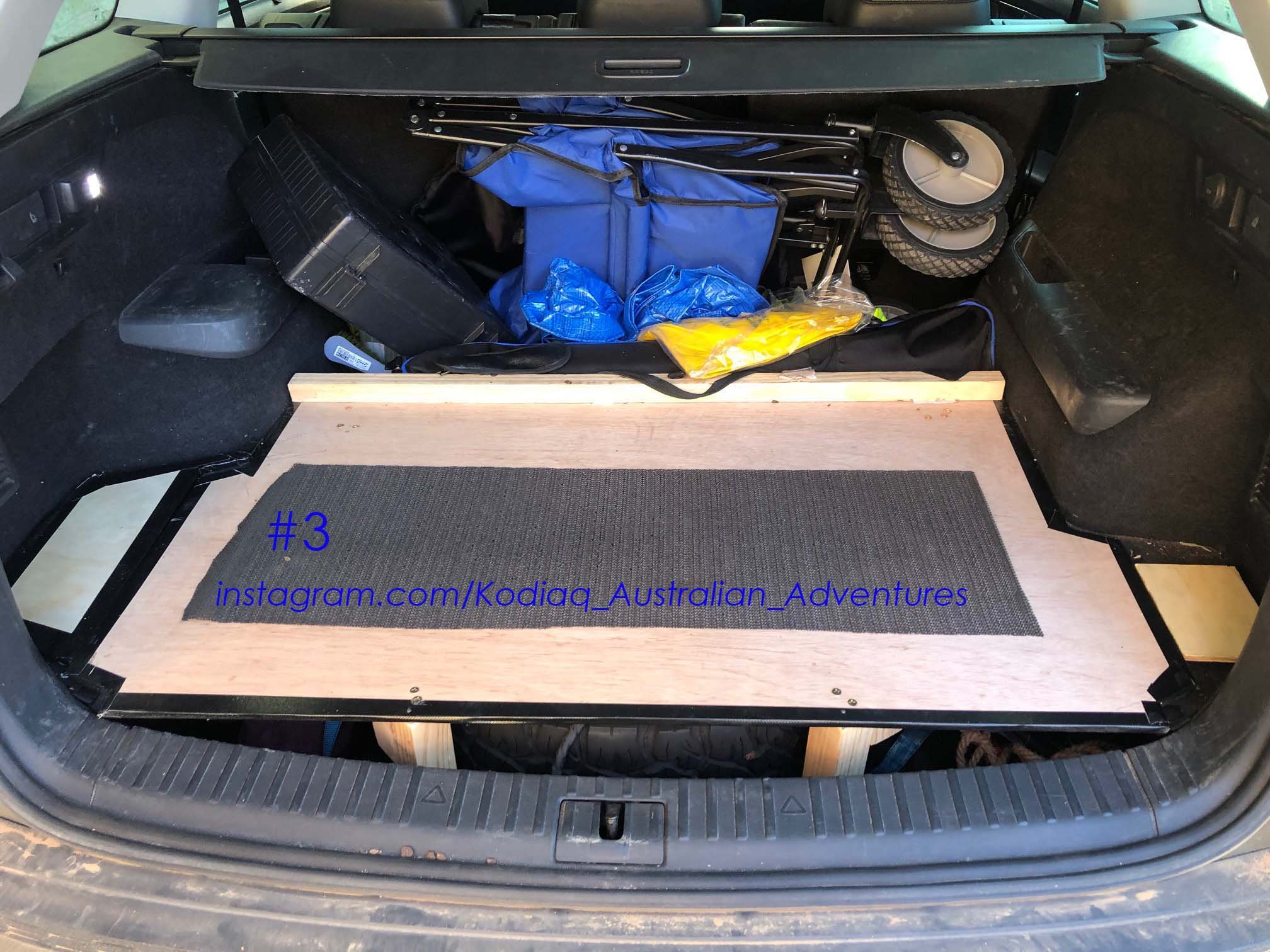

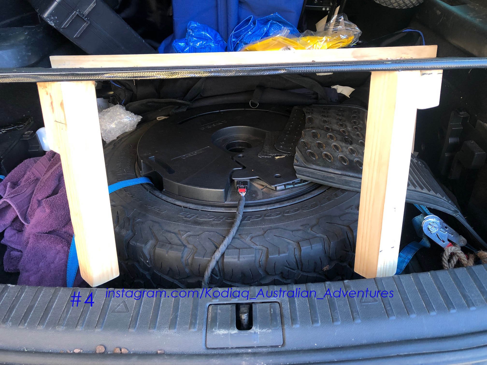

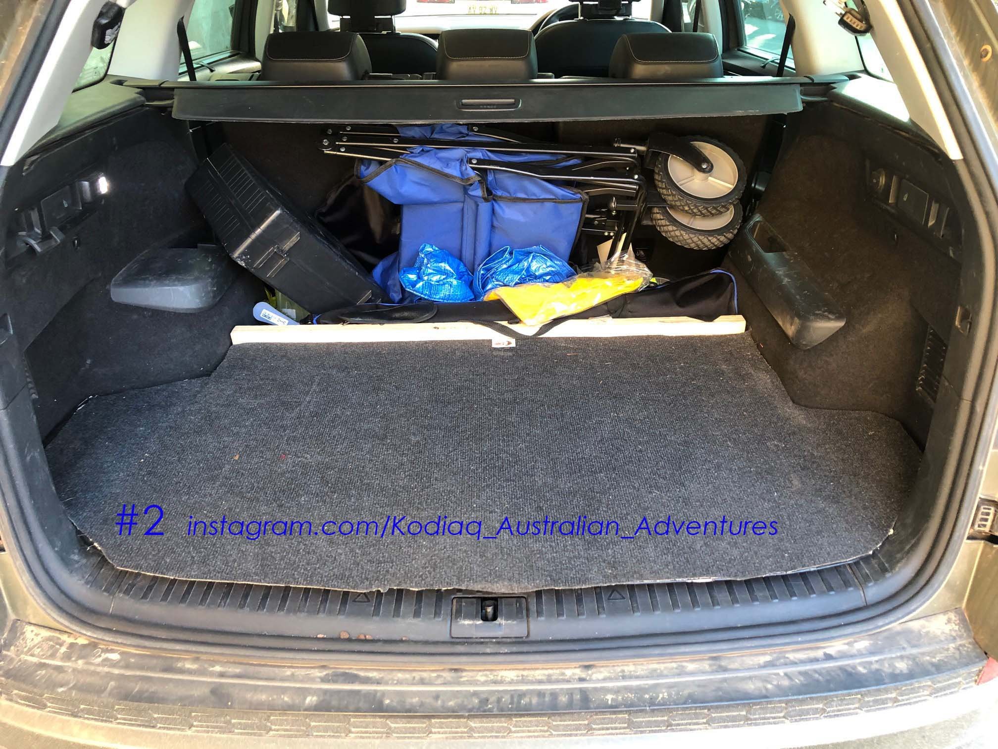

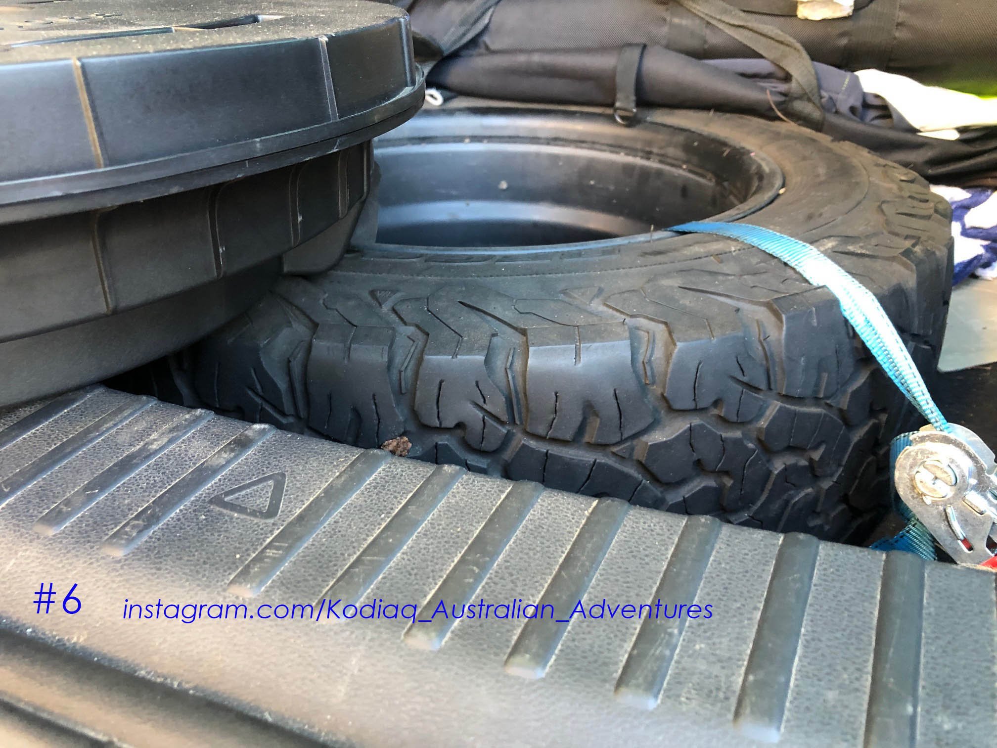

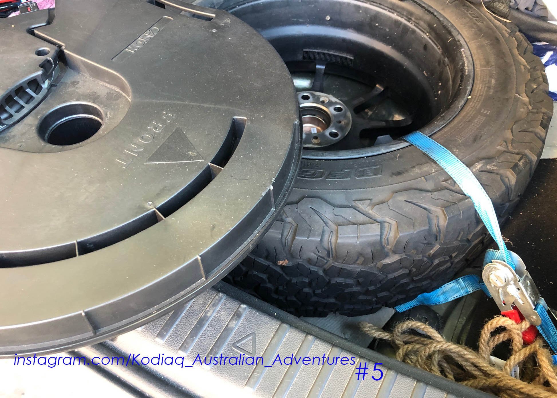

I have a 7 seat model and removed the rear seat along with tyre and foam around it.    I installed a full size spare tire where the space saving tyre was and put in a new false floor, which is about  10 cm above the existing floor.  I've also gained a lot of extra spce where the seat was.

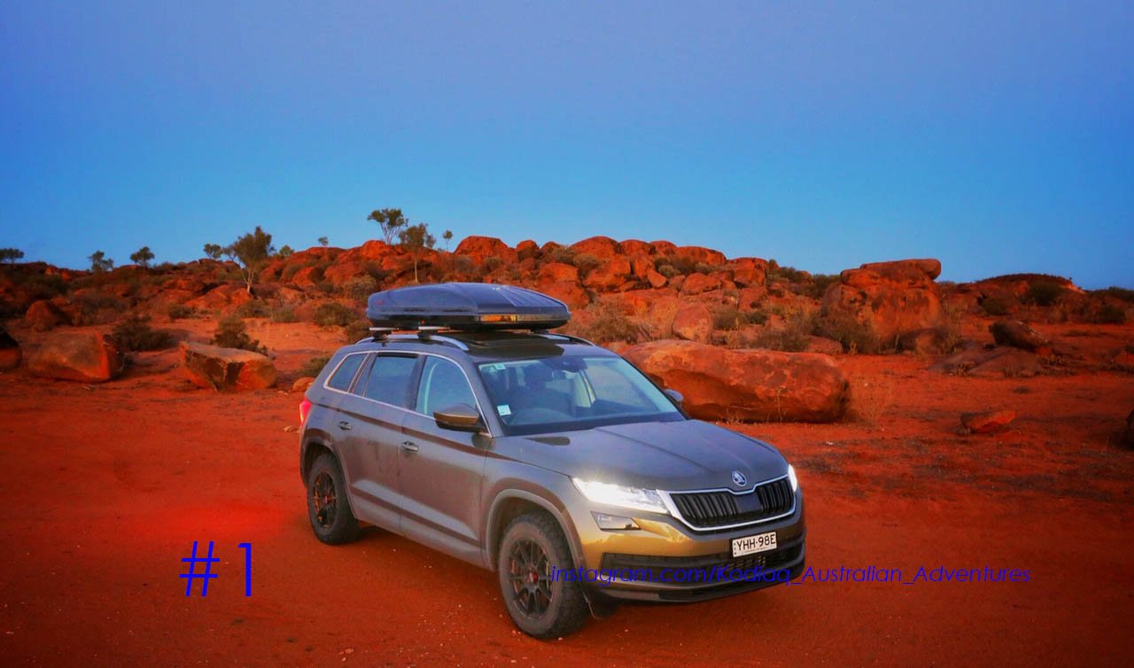

2 hours ago, KodiaqAustralianAdventures said:
I have a 7 seat model and removed the rear seat along with tyre and foam around it.    I installed a full size spare tire where the space saving tyre was and put in a new false floor, which is about  10 cm above the existing floor.  I've also gained a lot of extra space where the seat was.

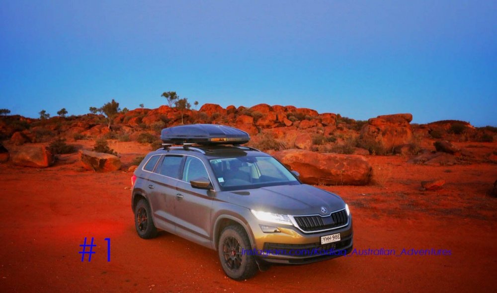

photo 1 shows the chunk 4x4 tires and rims I'm running for true outback adventures.

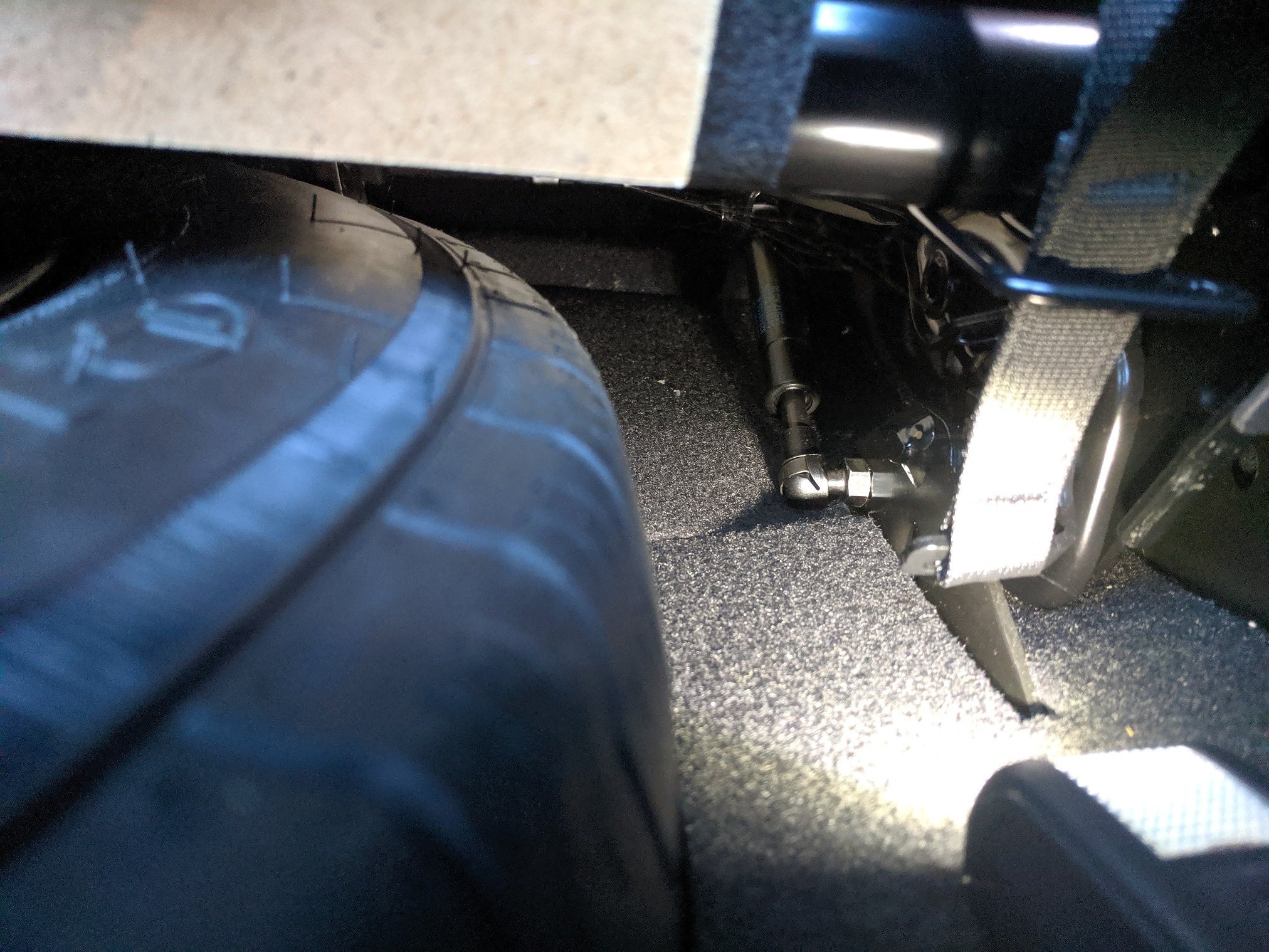

photo 2  shows the new thin ply home made floor with carpet which sits on top of the frame, shown in Photo 3 and Photo 4, also showing the music bass still fits in the smaller rims. The rim is secured by straps , both sides , to the anchor points in the car.
Photo 3 also shows the space I've gained behind the 2nd row seats which is very large.
The Rims were purchased mounting holes drilled to match the pattern by the installer.
RIMS: Lenso 17 inch x7.5  5X114.3 ET42 CB73.1 Matt Black Spec F
TYRES: BF Goodrich 22 / 65R17 All Terrain
From: TempeTyres Sydney @tempetyres
