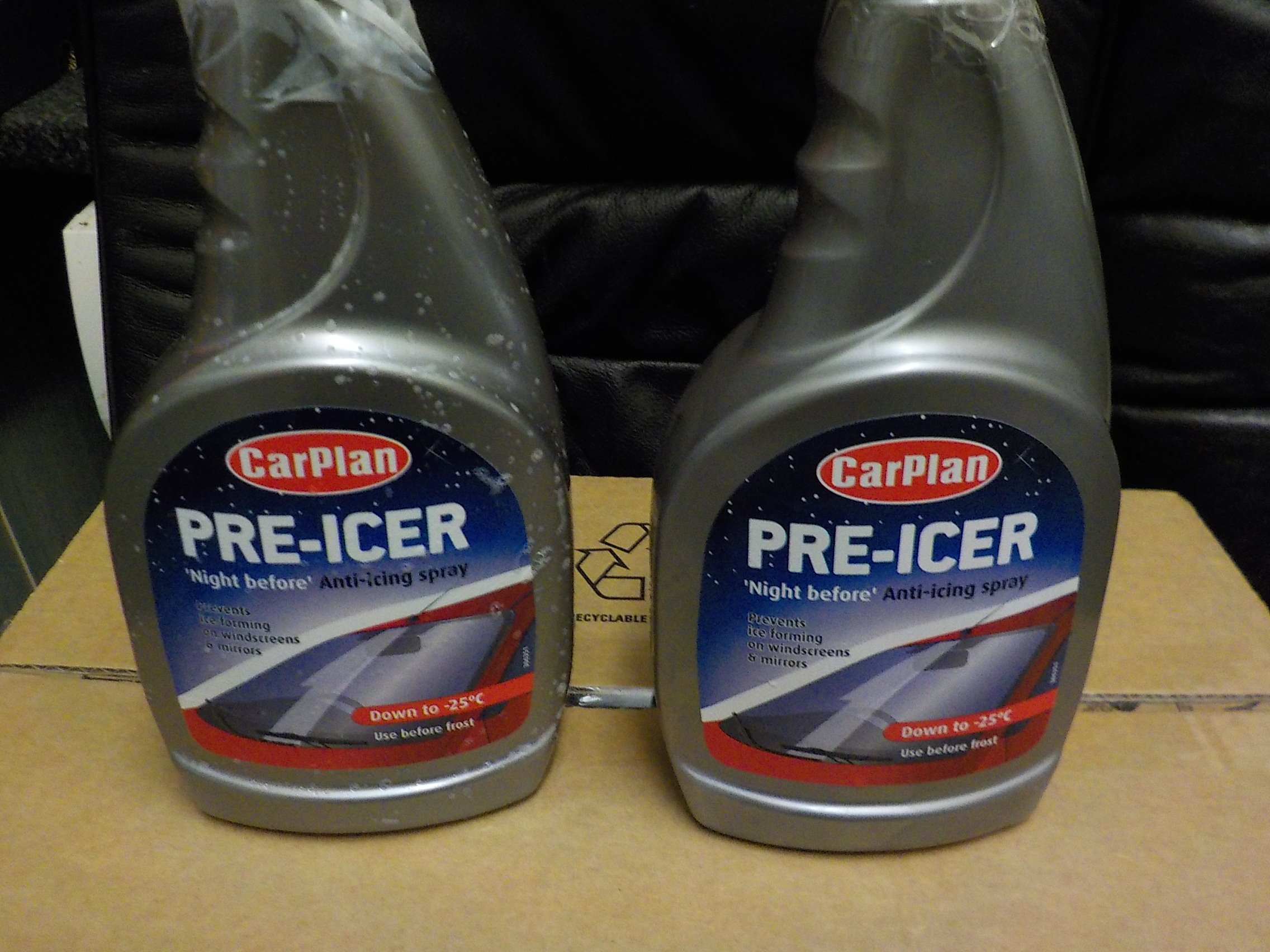

Night before / Pre-icer worth ever penny which is not that much actually.
