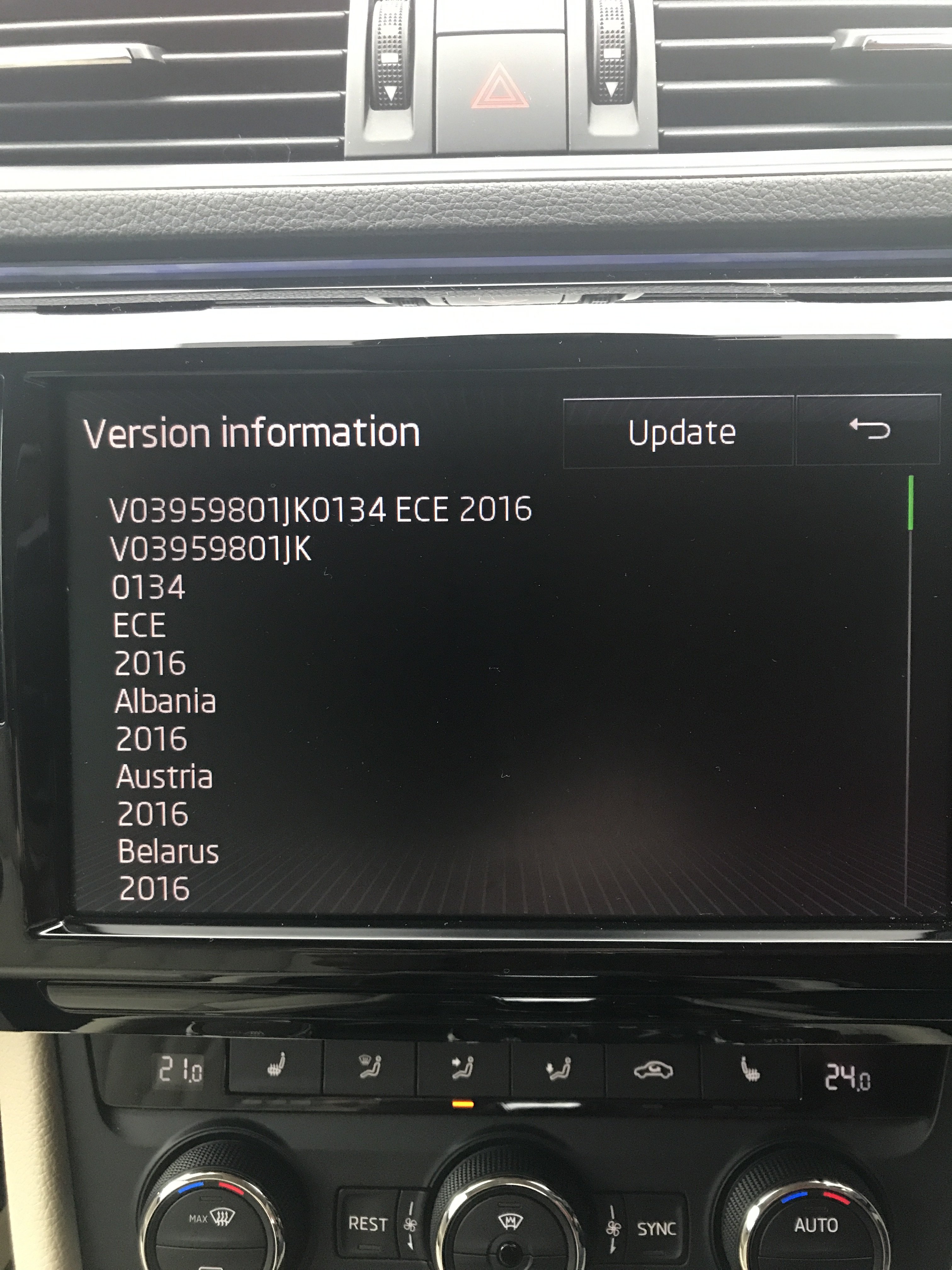

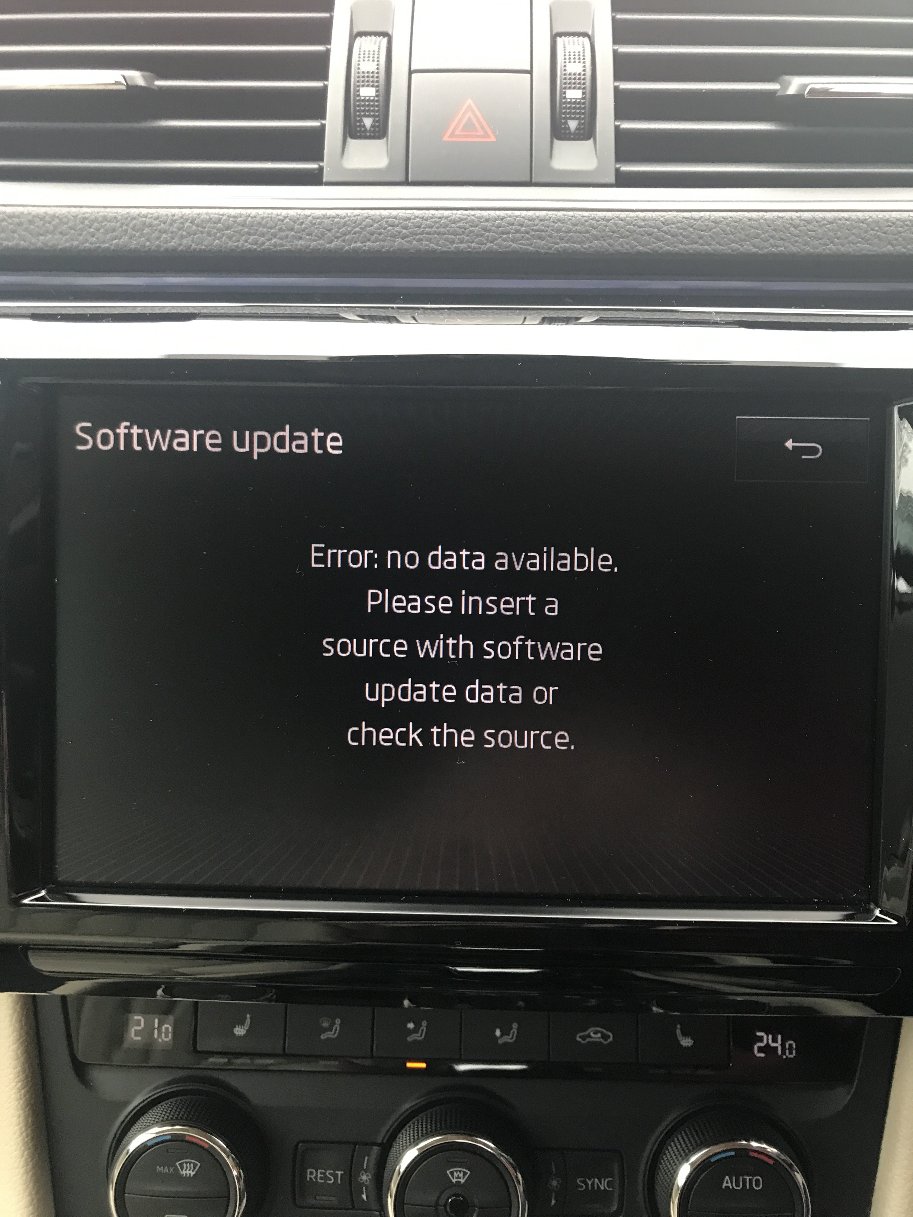

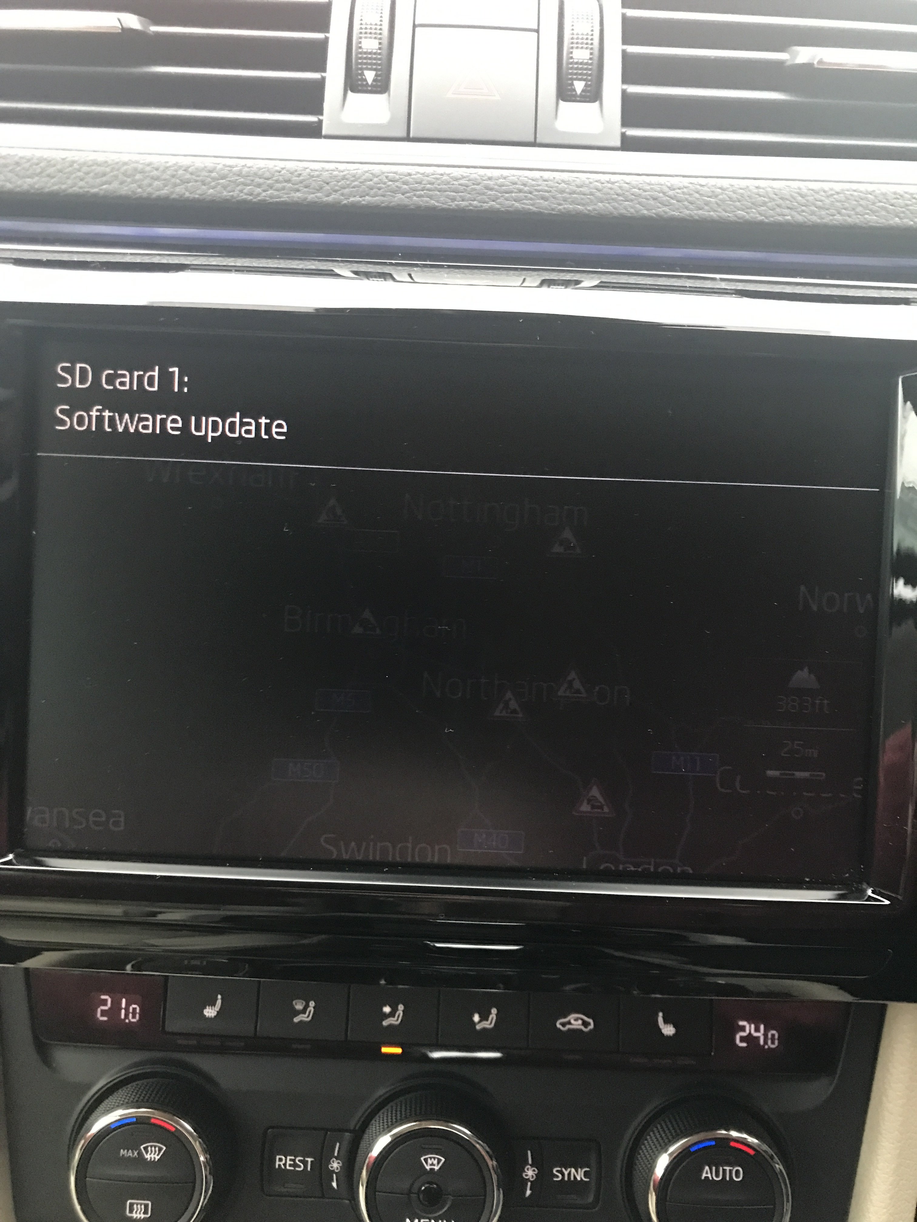

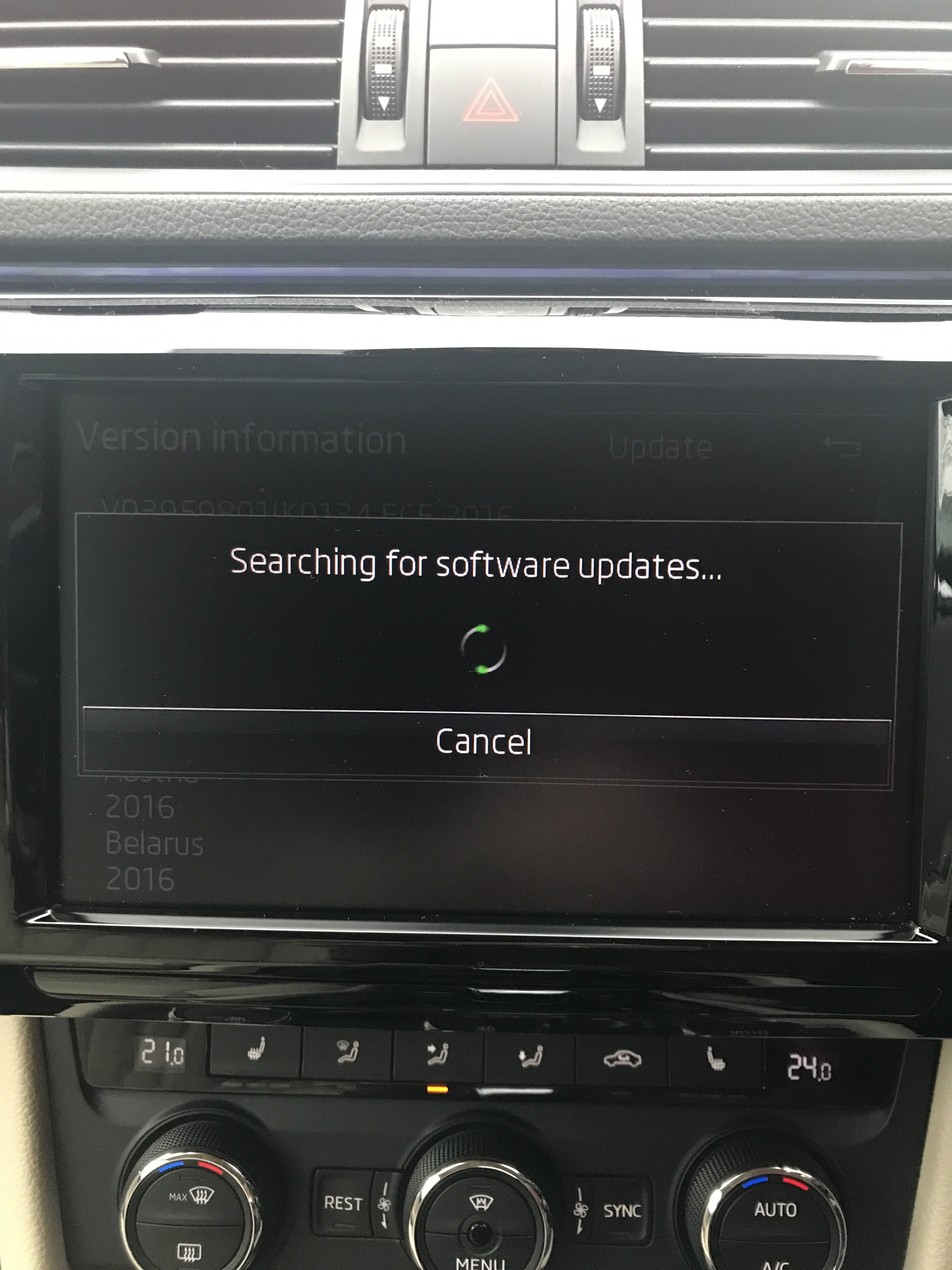

I’ve been trying update mine with no success.   Downloaded the 2019 update from the Skoda portal after putting in my VIN.
I’m using a Mac, so I then formatted a 32gb SD card (I’ve tried both Fat32 and ExFat) and copied the contents of the zip file to the card.
The car seems to recognise the SD card as a software update just after I insert it, so then in Nav > Setup > Version information I press Update.   It then searches for updates, and always fails.
What am I doing wrong?   Ive tried it on a USB stick too.  I’ve attached some photos..
I think I’ll boot my Mac into Windows 7 and format the card again.   I might even download the damned thing again too..
You don't copy the zip file to the sd card. You unpack the zip file to the SD card, all done automatically if you run the download manager that Skoda push to you (at least on Win10 they do).
So unpack the zip file to a blank formatted SD card.
Edited by xman
I wasn’t copying the Zip file to the card.   I was copying the contents of the zip file...
It needs the file and folder structure and attributes including the hidden files to be mirrored. Hidden files need to be unpacked too. Check the last modified dates of all files and folders are todays date, the Skoda download manager dates them all that way, when it unpacks, the original files in the zip files are dated up to 2 years old.
If I use other methods to unpack, the dates are the same as those in the zip file, which I suspect might confuse.
