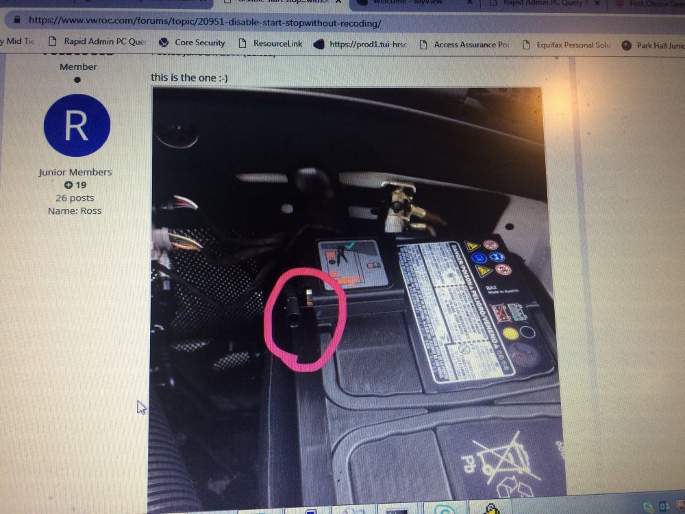

Today having read up on a Golf forum recently, disconnected the battery monitor plug. Did the trick, as stop/start is disabled.
Our car looks identical to this other persons picture.
We dont need the stop/start button to be pressed to disable everytime
