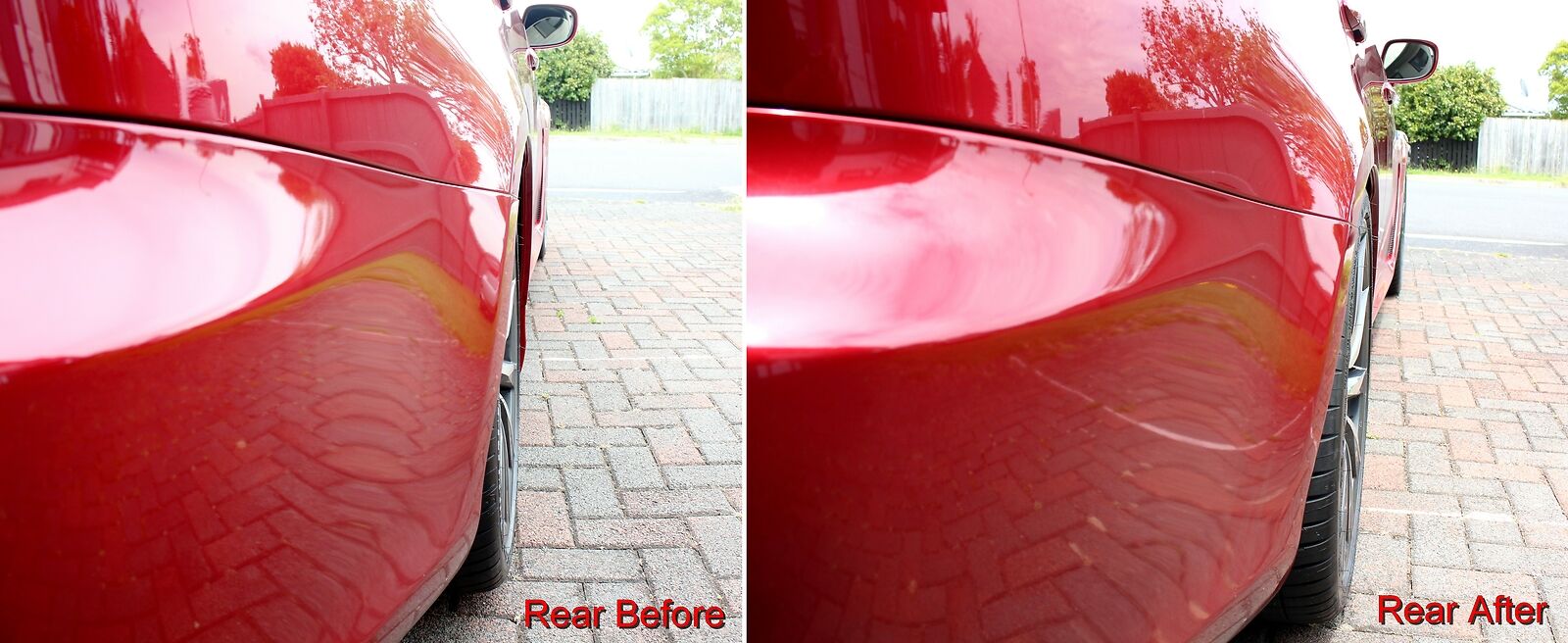

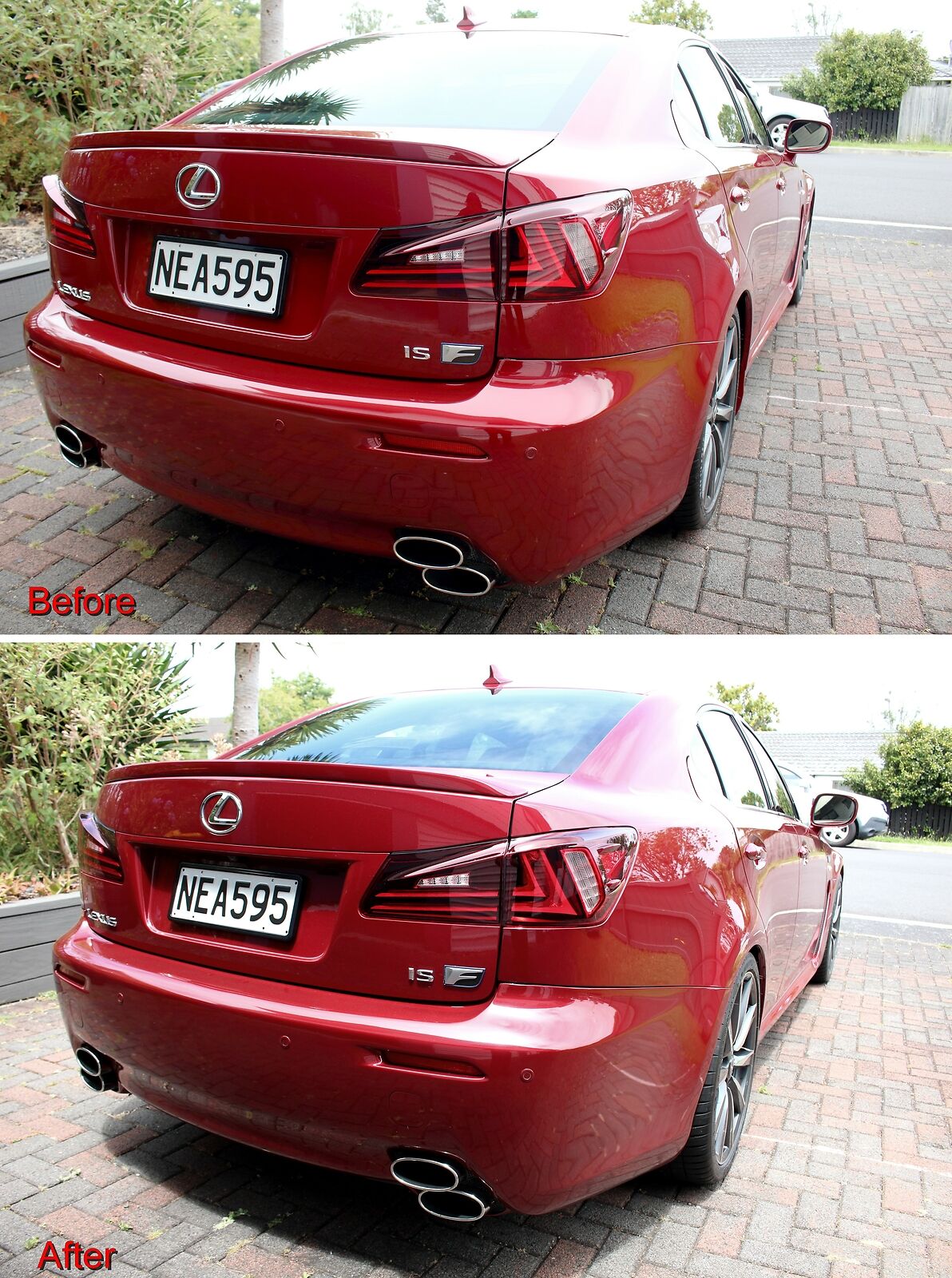

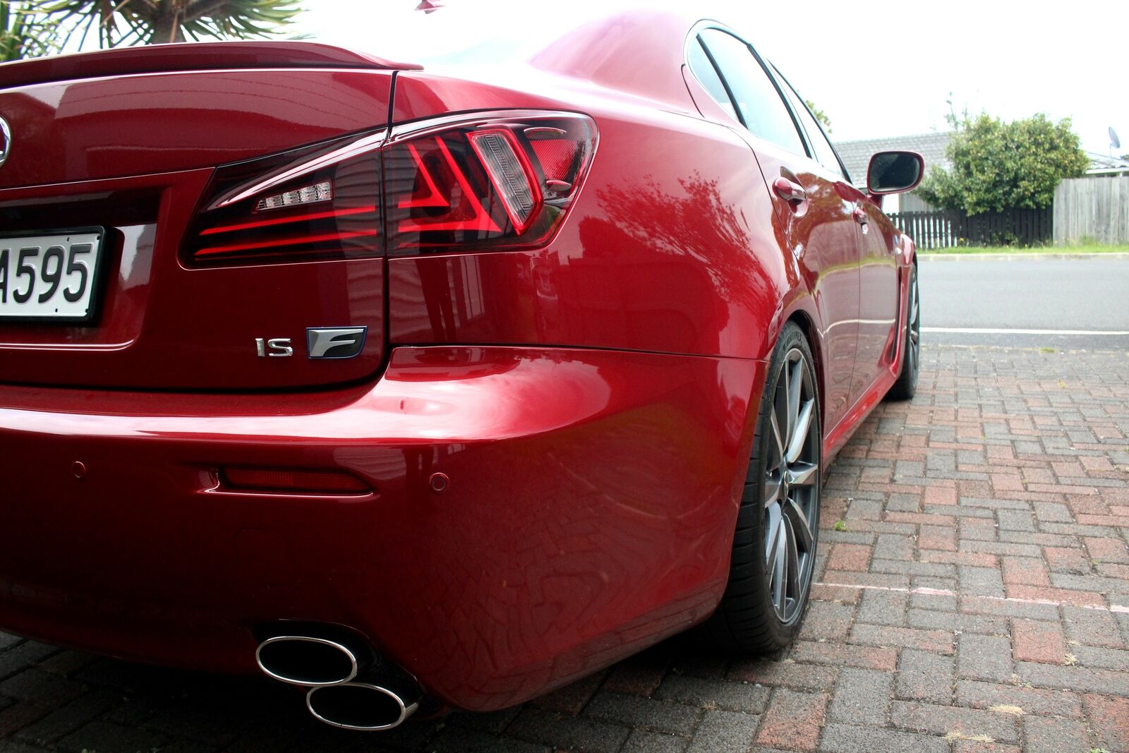

I had 20mm spacers(from bonoss) for front and rear.Well, i have to say,that's awesome! absoulutely changed the vehicle into a new look.
2071385455_AfterBONOSSforgedlightweightpluswheelspacersonLexusISF2010frontrear20(2).thumb.jpg.c35185cb66bac8751b81471d4d5f8937.jpg
883326040_BONOSSforgedlightweightpluswheelspacersonLexusISF2010frontrear20mm.thumb.jpg.1e933944907dacacc2b98474085c6776.jpg
