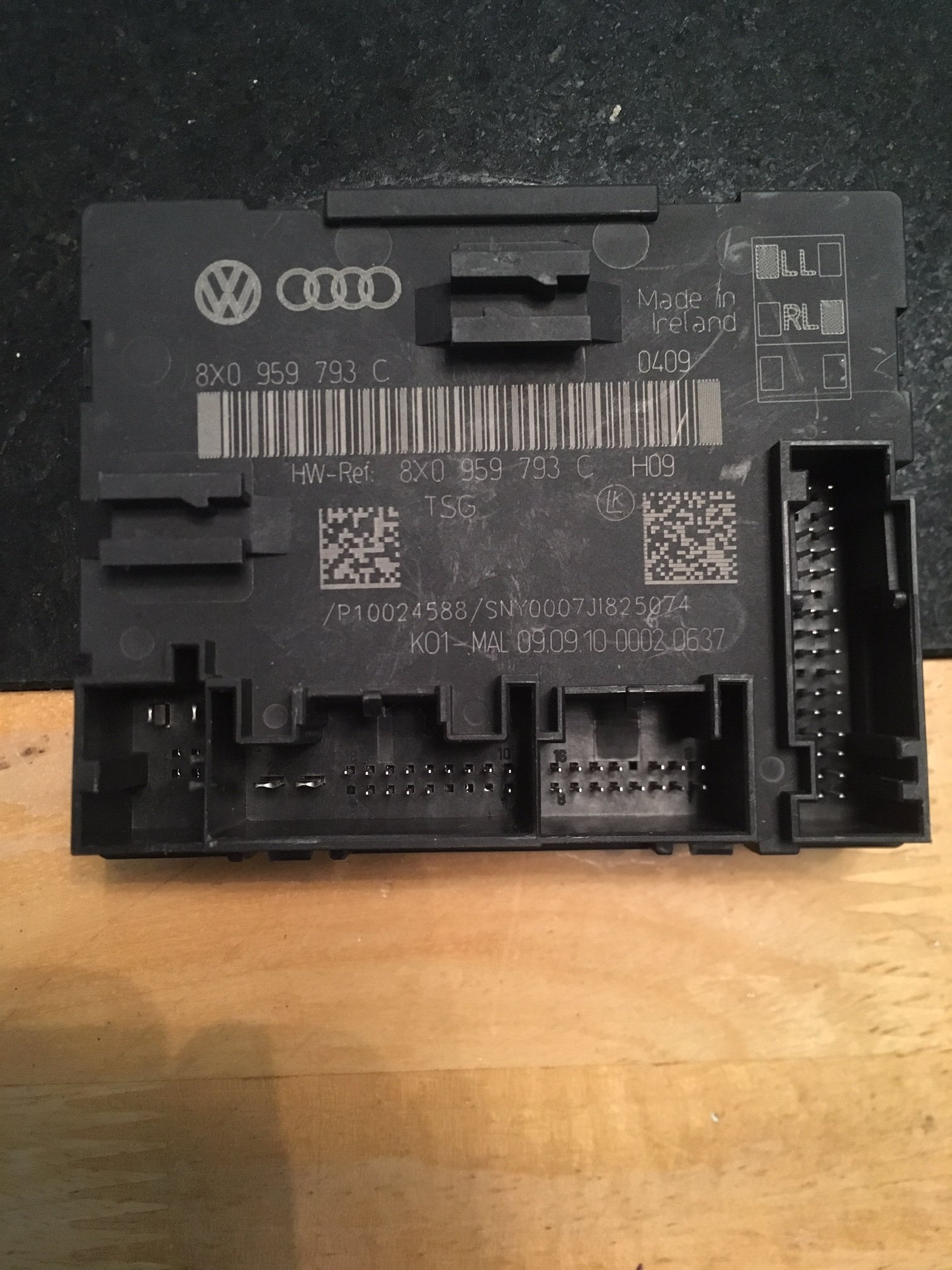

Although the part number of the control module is identical, the software inside might change depending on which car and side it's designed to fit.
For instance, on a gen3 door controller, the part number shown in VCDS is typically printed on the motor rather than the control module so when replacing, you need to make sure both match.
What part numbers are you looking at and have you got any pictures?

Part number is 8X0939793C, pic below.

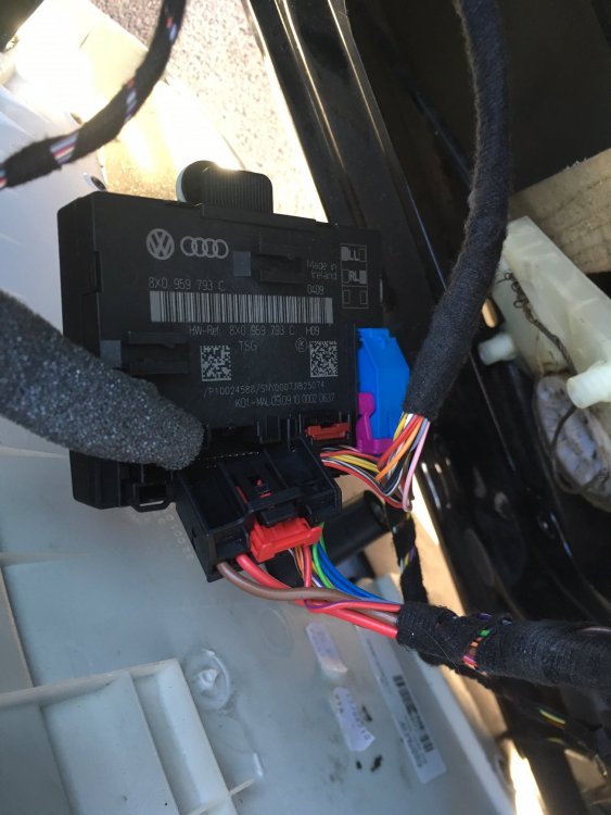

So out of curiosity I wanted to check the power going to the module.  Does anybody know which wires it should be?  I've checked the thick red and brown wires on the plug in the picture below, but i dont know if they are power going to the module or from it.
Thanks
Never mind the above, just checked the power and there's a good 12V going to the big red wire so its not a wiring issue.
the car may have sensed a short and disabled the functions (wild guesswork) there also could be water inside the module, can you cut it open?

Firstly, I managed to get hold of another door control module from ebay, matching the part number and year for the car.  Plugged it in and it works perfectly, and for reference the part number is 8X0959793C.
Furthermore, I did contact the dealership and they provided a superseded part number which is 8X0959793H.  This part did work, but they provided it with the wrong software so the buttons did the incorrect functions, and as they wanted £144 to reprogram it then I gave it them back.
