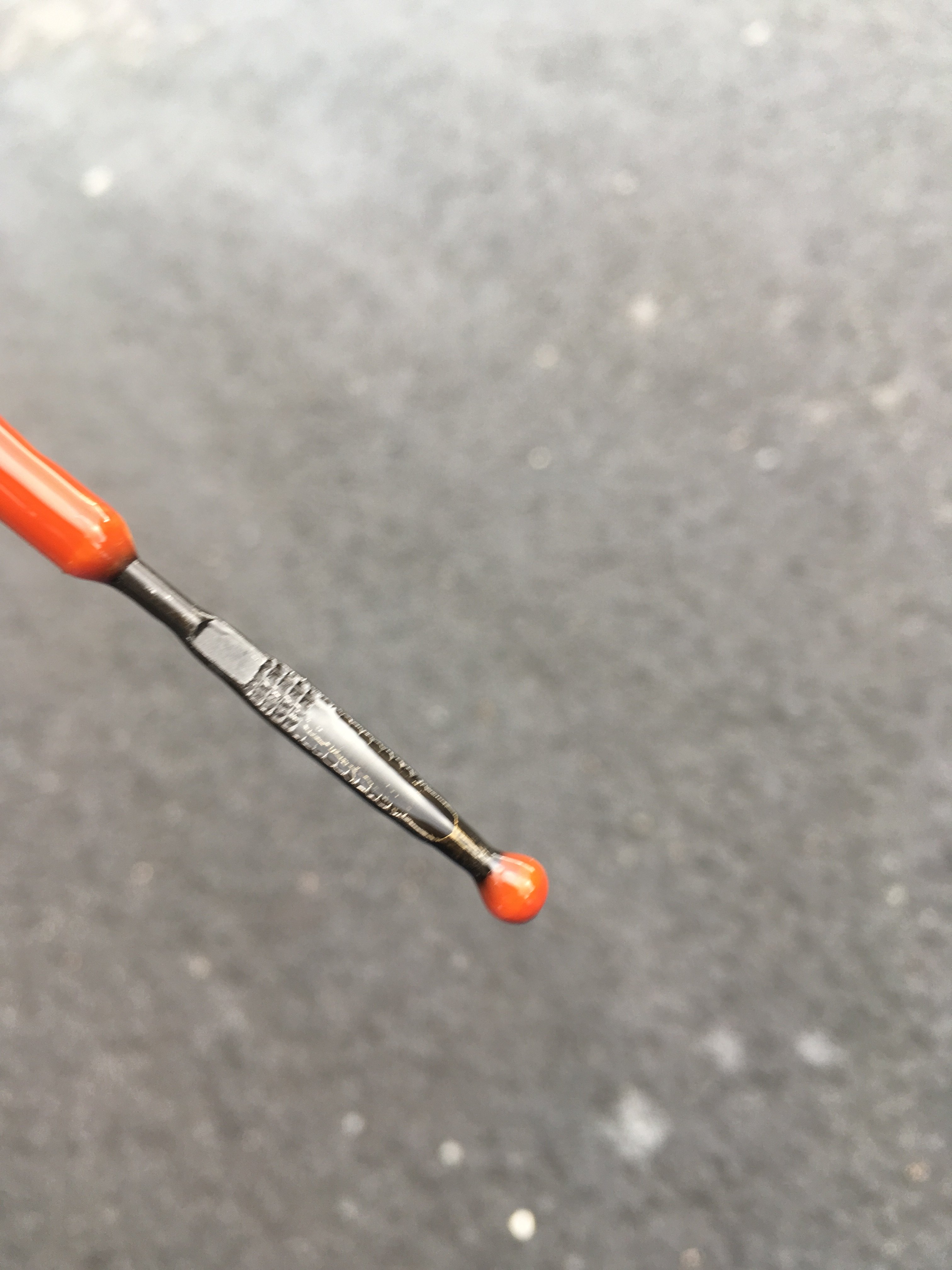

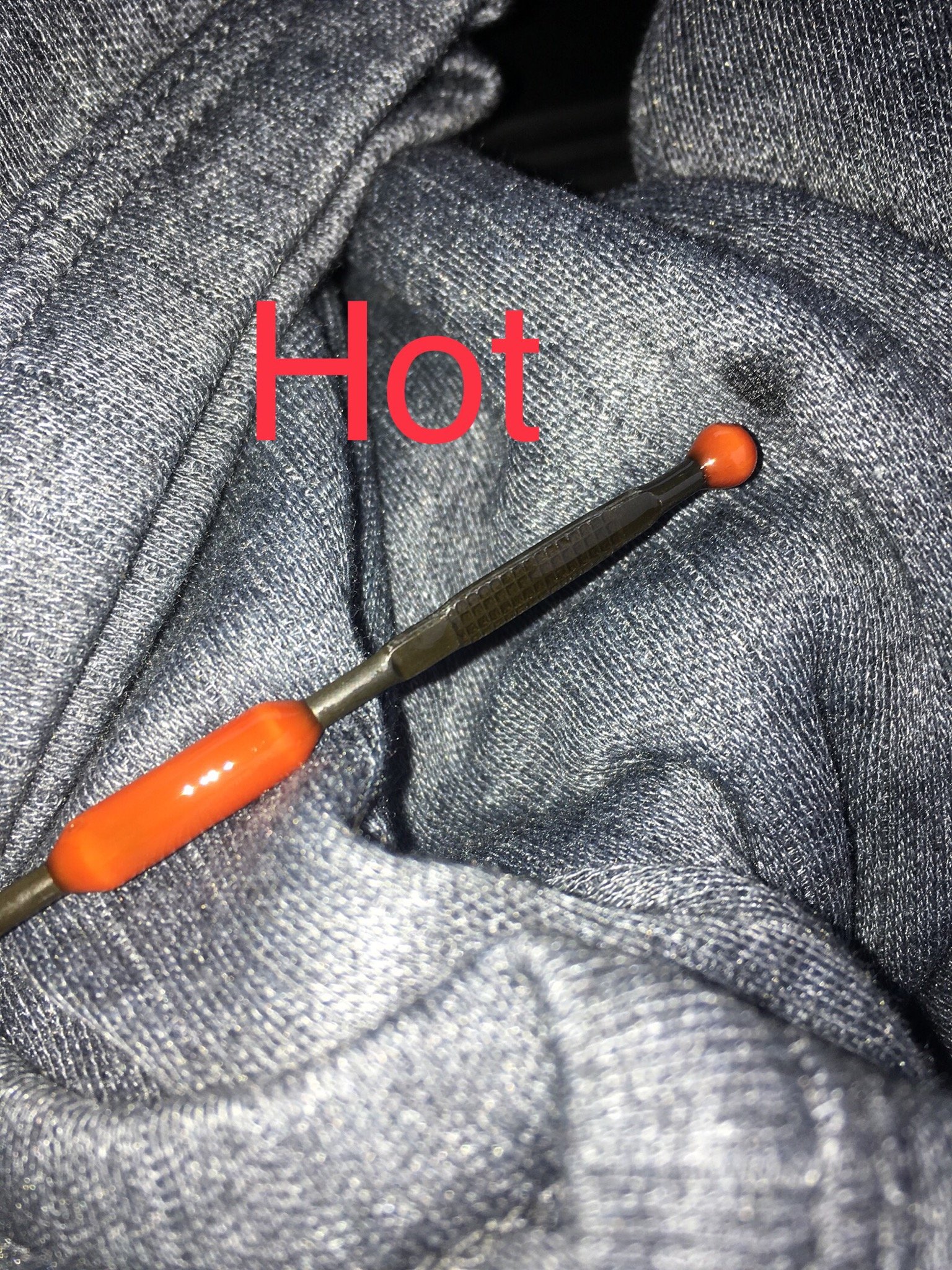

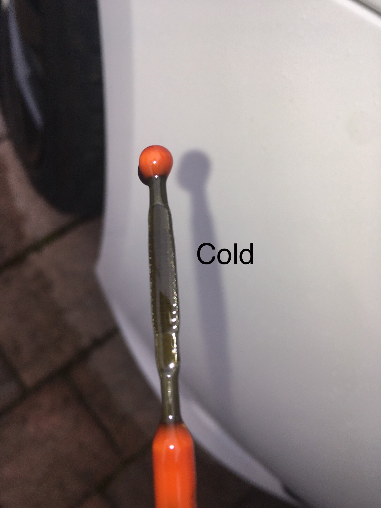

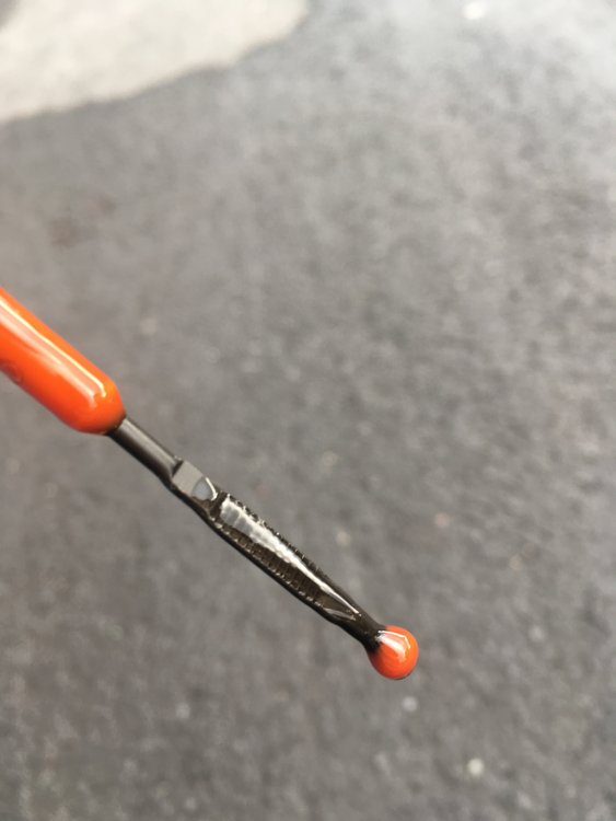

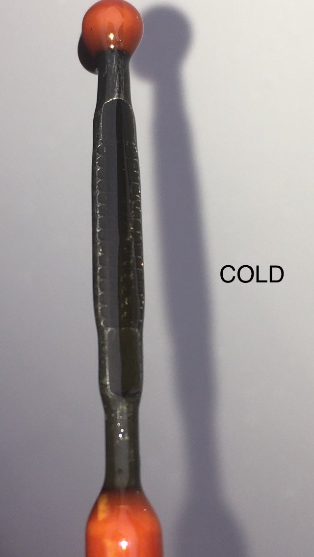

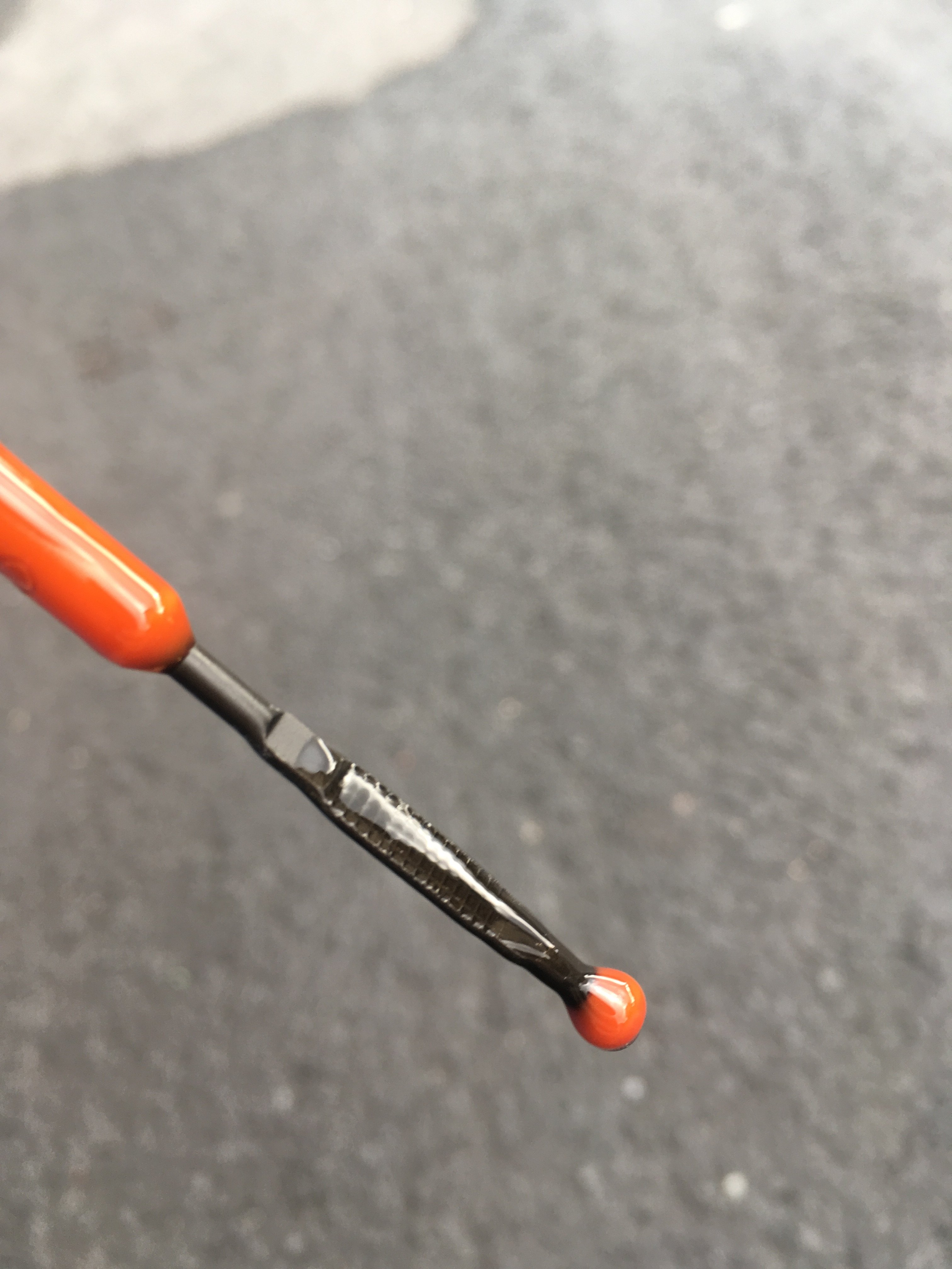

so heres the pics of hot and cold both readings are above the cross hatch to the edge of the flat section also
First two pics cold
second two pics hot
@Skoffski i can also confirm the oil filter was NOT replaced i still have my mahle filter :@
Going to be interesting to read the weight of the oil drained before the start of the test.
Seems like you might have more than 3.6 litres in.  But time will tell.
@Skoffski my exact thoughts seems a little high

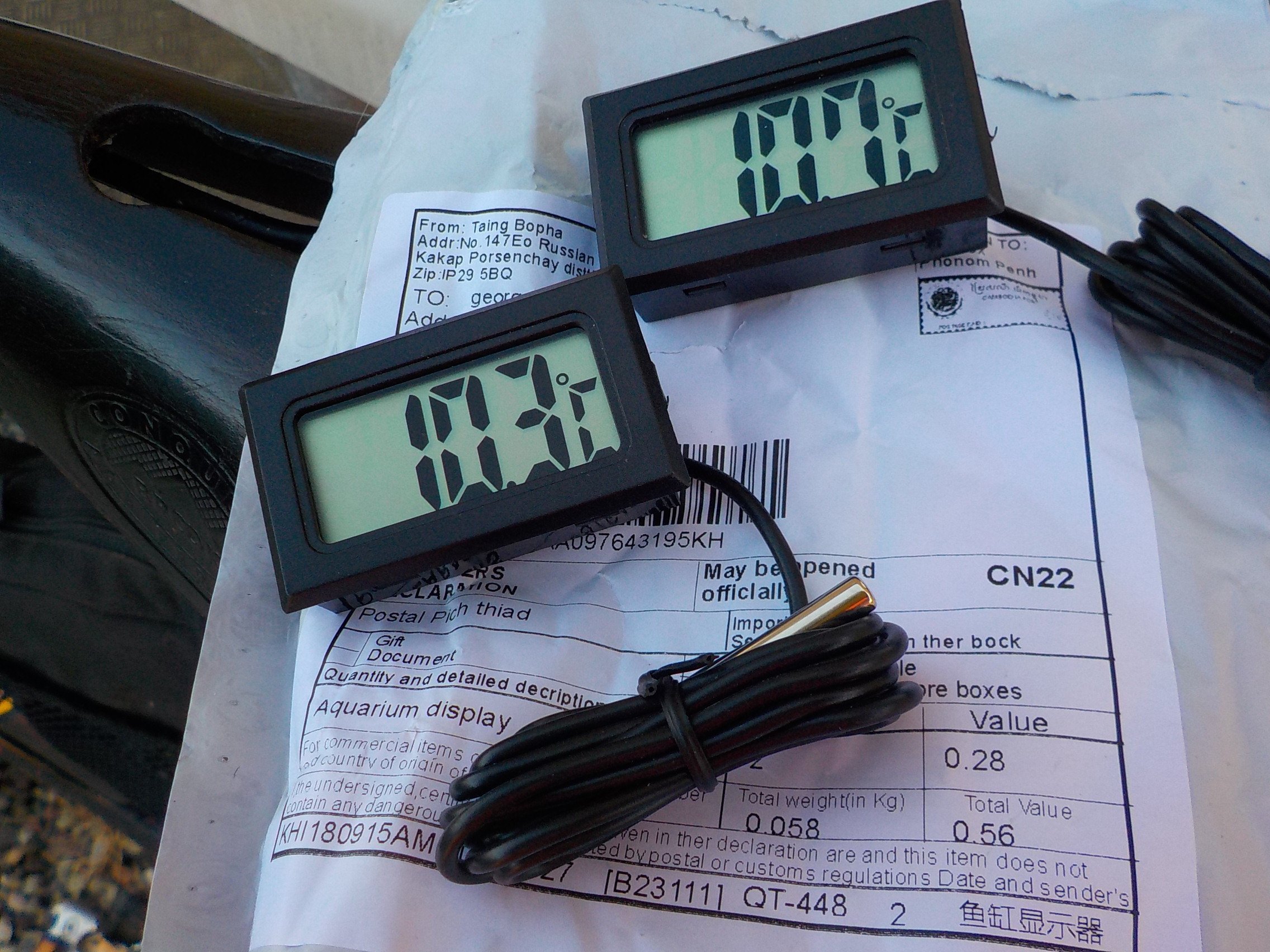

Not easy to tell with your pictures, but i put in 4 litres in a twin charger and that is on the flat above the crosshatch when stone cold and just above the crosshatch at around 80-90*oC indicated oil temp.
Then i put a digital thermometer down the dipstick tube to be sure.
When i drain after putting in 4 litres i know how much comes out and the weight.  & the weight for a temperature of 1 litre.
but i will leave that for now.  Someone in the dealership might be reading.

Have you dipped it stone cold today?
If you can please do.
 Just pull out the dipstick after putting it in wiped clean and keep it vertical and see if you can see exactly where the level is.

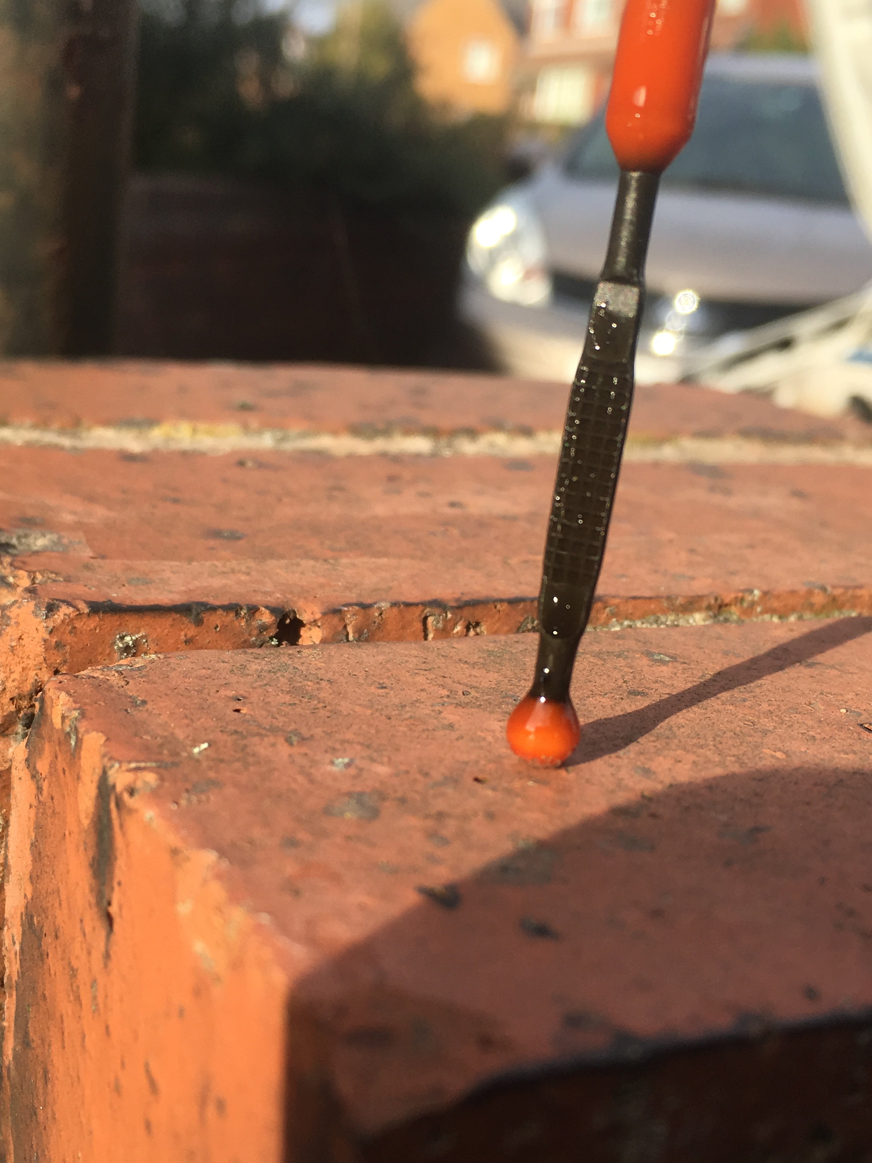

hi mate here is my stone cold dip
And here is my zobzuma dip
Edited by GT0161
Good.
Looks like a bit more than 3.6 litres in which is not unusual if the Oil Filter was not replaced then 3.6 litres of oil is then added.

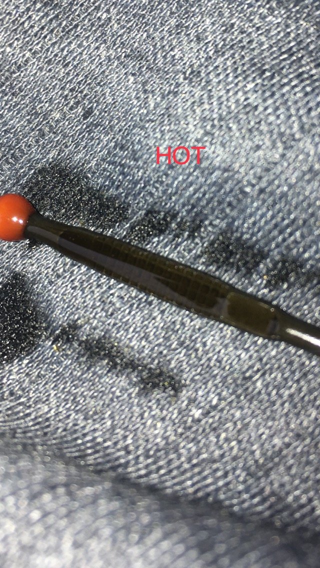

Did a random warm dip today whilst i had time
Also used a lighter to see if it ignited.... it didn't tryin to arrange the next step of the oil test struggling with work so will be over 300km i guess
Best that it does do over 186 miles.
Over 600 makes sense really, or double that.   Messing about with it from fully topped up and less than a tank full of fuel use is a waste of time.
