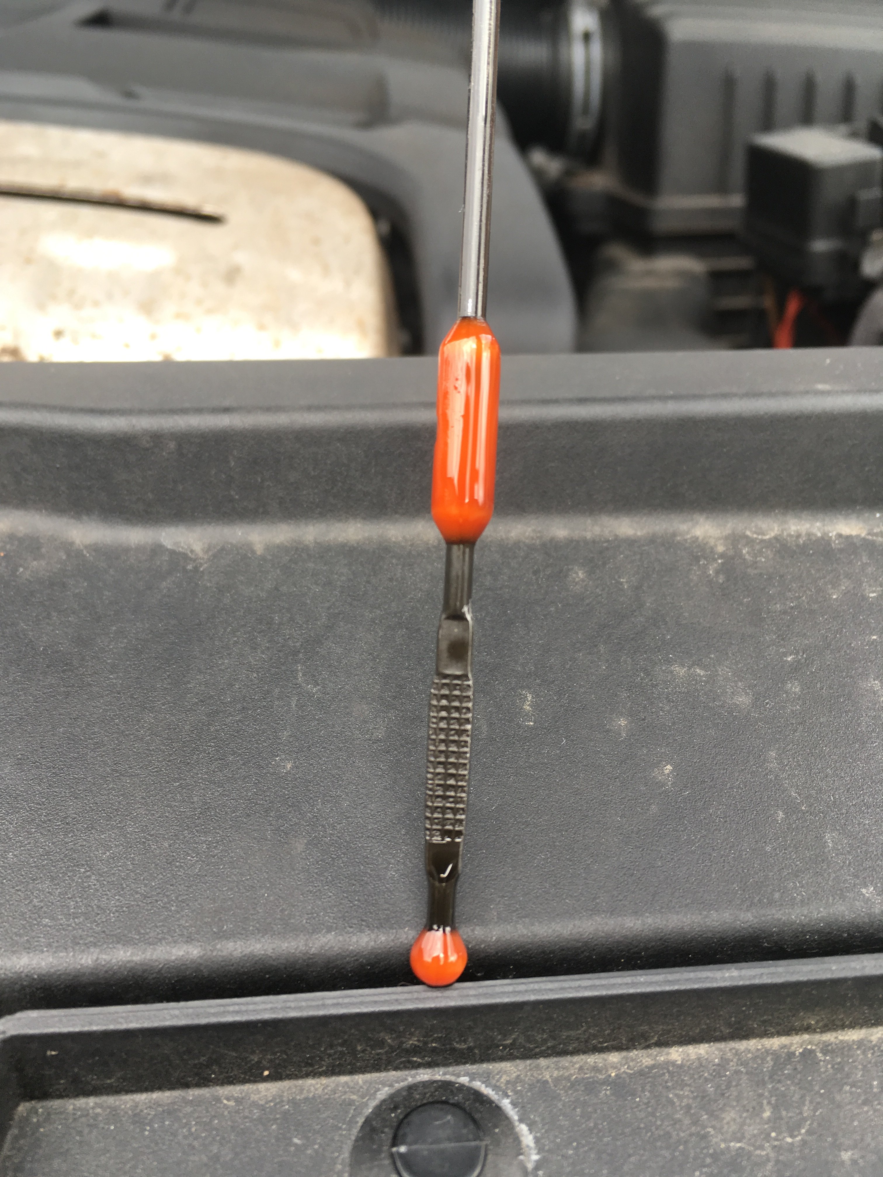

Oh look 7 days and 150miles later after new fresh 3.6l oil added
Is that it at the bottom of the crosshatch?
Bad luck.
@Skoffski yes indeed it is why could this be? Its never dropped that far since owning and its only been a week and less miles then i did on the consumption test ?

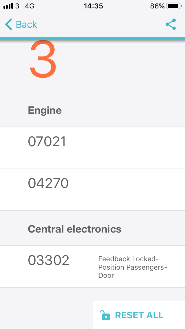

I have plugged in carista and found these fault codes. But cannot find anything online ???
Has anybody had these codes before
thanks
